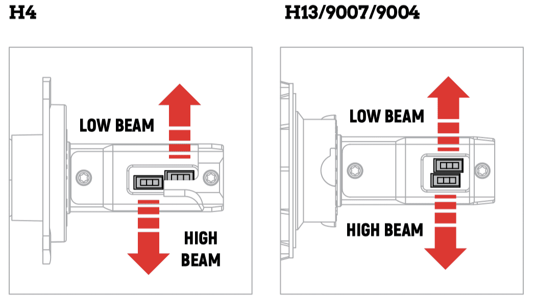

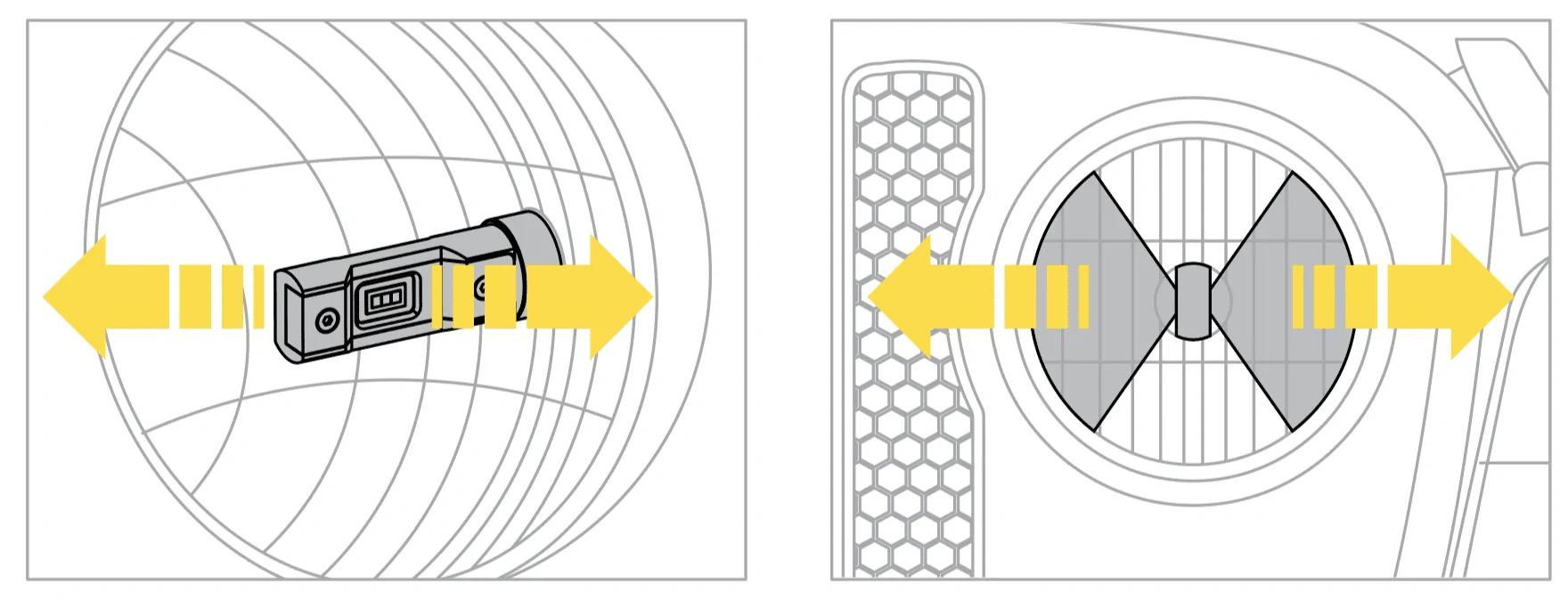

On the initial install I was getting flashed by on coming cars. Turns out that I oriented the LEDs vertically. All LED headlight bulbs need to be oriented so that the LEDs are projecting horizontally.
