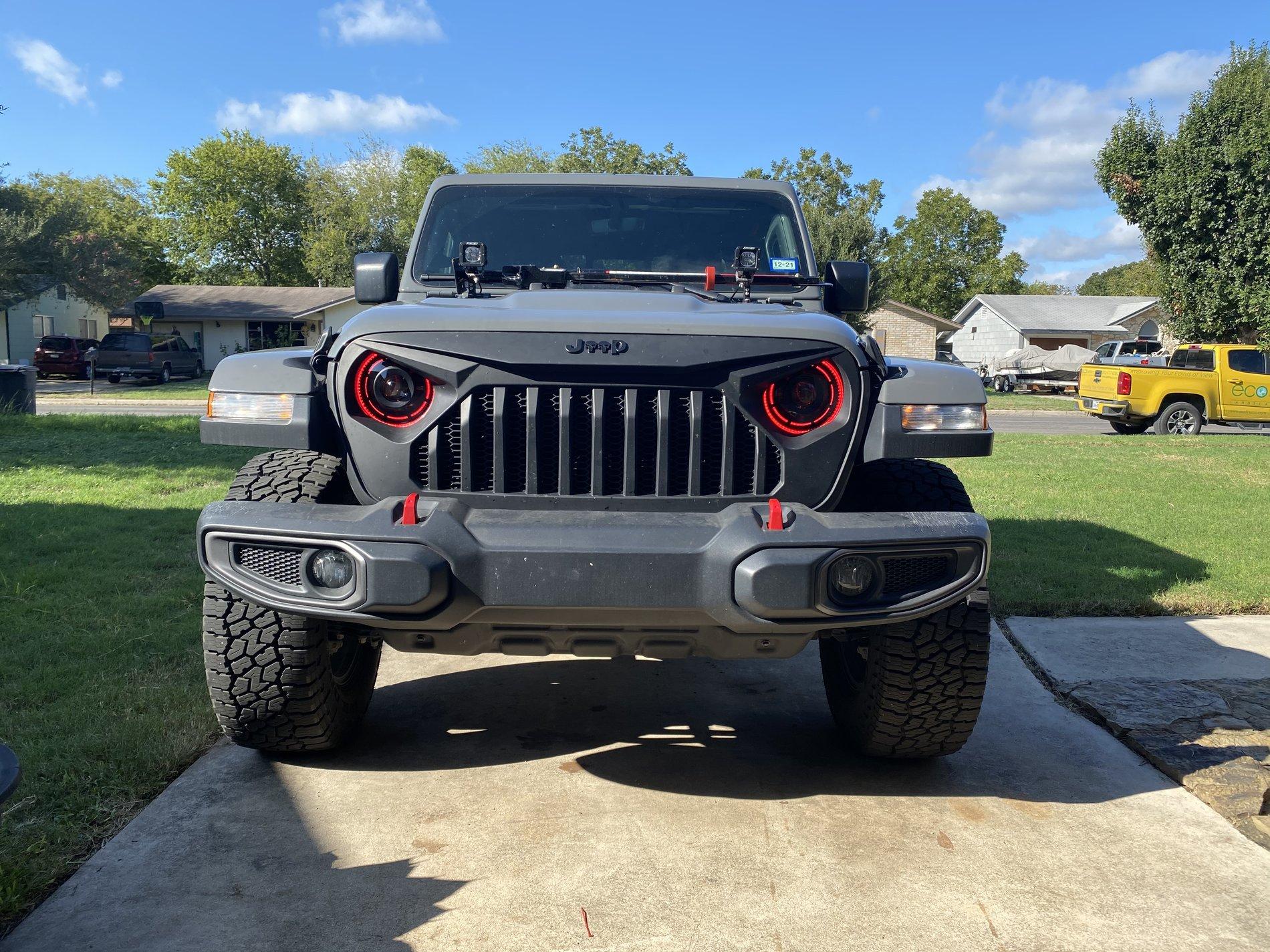

I tried all of those things to no avail. The app shows my color choices and shows that the BC1s are connected but it’s like the headlights themselves don’t see what’s going on. The lights don’t change. Thanks for your help. I was so careful wiring the 4 colored wires to the three bc1s, it can’t be those connections. It was color matched even, since I was going for all three bc1s

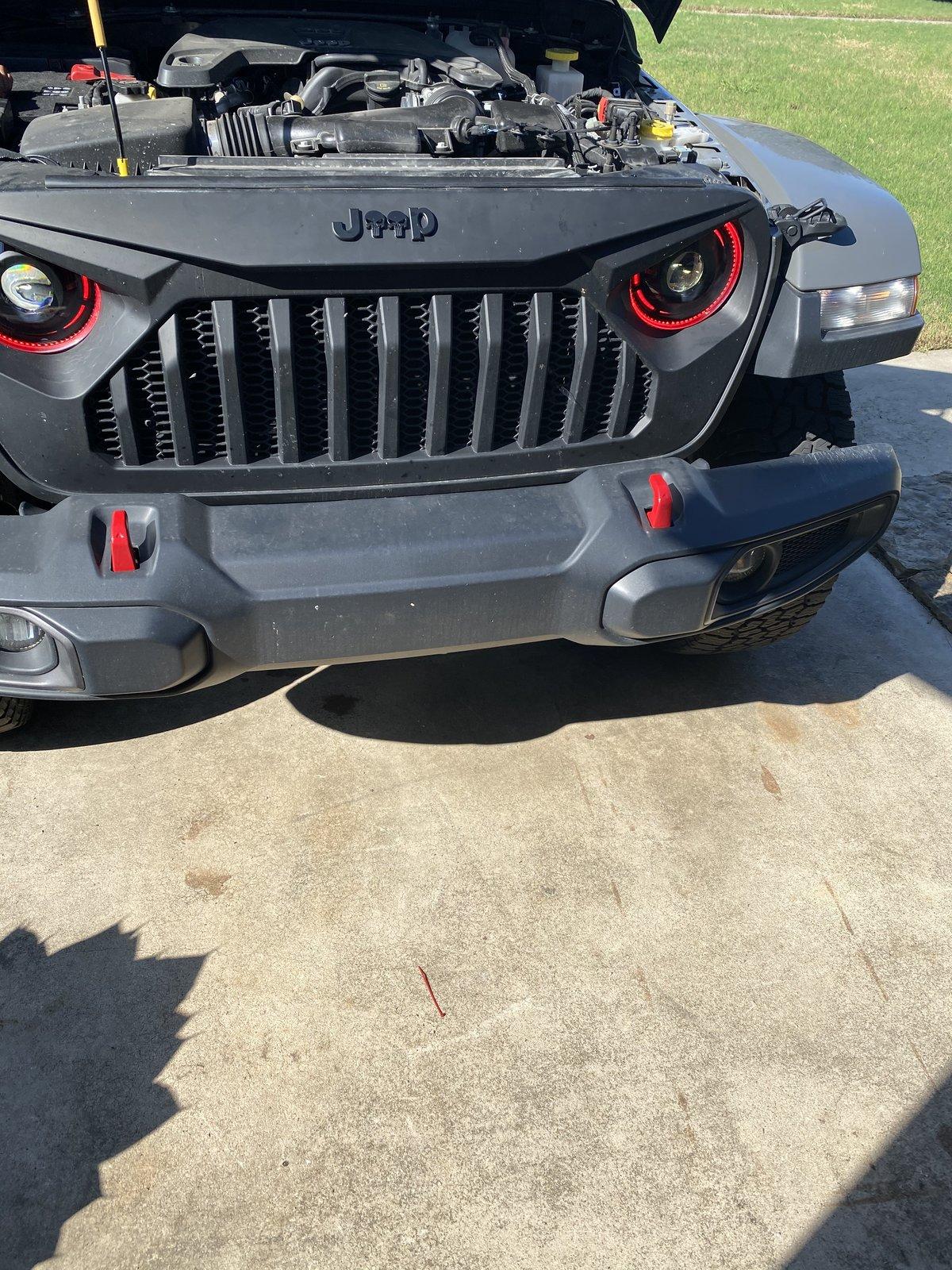

So I reset everything and did get the inner and outer rings to respond to color changes. The demon eye still isn’t responding to any input on the app. Any suggestions?

It has something to do with the demon eyes. The inner and outer rings work on any of the three bc1s. So all the bc1s are working. However even if I put the demon eye on the same bc1 as one of the rings....the ring will change color but the demon eyes stay white.

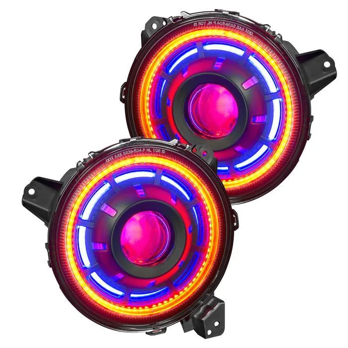

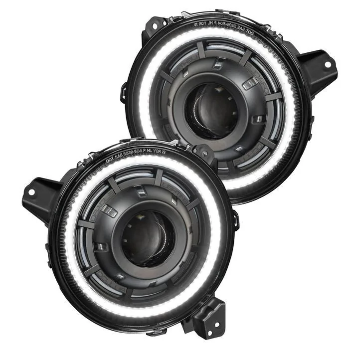

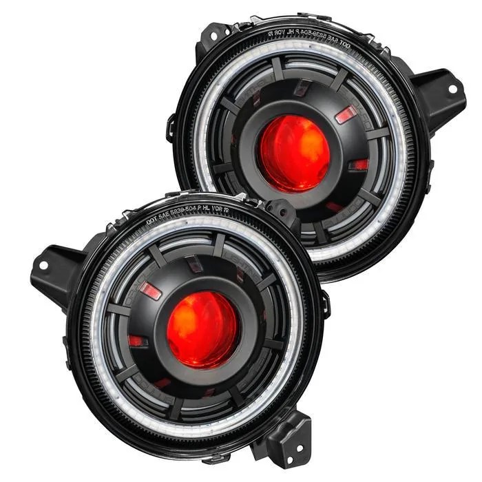

We are happy to say the Oculus ColorSHIFT™ RGB+W Headlights are NOW Availble :)
ColorSHIFT Oculus Headlights feature 3-Tiered RGB features in the lamps:
• Outer Halo Ring (RGB+W)
• Inner Halo Ring (RGB)
• Projector Demon Eye (RGB)

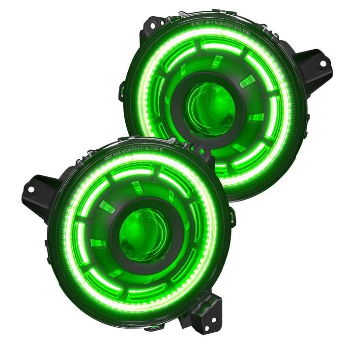

White DRL Mode:

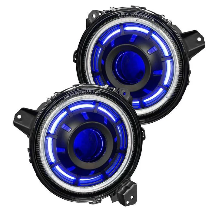

RGB+W ColorSHIFT™ Outer Halo:
RGB Inner Halo and Accent Bezel:

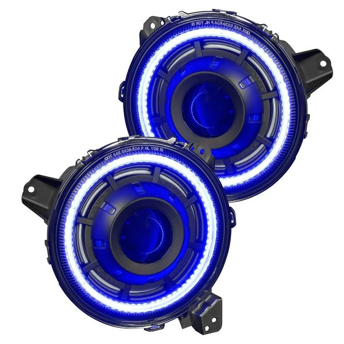

RGB Projector "Demon Eye":
Each LED feature has a separate cable output and can be connected together so all 3 create the same color or set up as 3 separate Channels or “zones” depending on the user preference and the ColorSHIFT controller selected. Please note that these features are intended for off-road “show” use only and are not compliant for street use.
The White DRL has its own wiring harness (same as the original Oculus) that connects to the fuse box with an add-a-circuit for easy and safe integration. The DRL will come on when the engine is running or can be connected to a switch (including the factory Aux switches) for additional user control.
