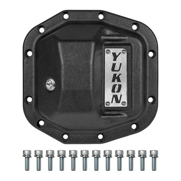

if you shop around you should be able to get Yukon gears for $850 plus installation from a shop near you. They also offer Yukon HD Differential Covers and you can get them with the gears if you like.
They question is what will it cost to have the gears installed
180
29,591
35,198
Depends on your carrier - with an Overland and 3.73 you have to swap the carrier to deal with the lower gears getting above numerical 4.xx
Either way, you will be paying for expertise and labor - takes a bit of time to set things up correctly - that's where you don't want to cheap out. A couple years ago one I did was a differential that had been "rebuilt" by a "guy who does that sort of thing" up in Kenosha - my friend got about 20-30 miles out of town and blew the pinion bearings out, locked it up. He got trailered home and brought me the differential. He was lucky, not a scratch on the gear teeth, only the bearings were toast. But when I got into the limited slip area - boy was that screwed up. The other guy had it totally wrong, the sequence of plates and disks, and some were BLUE. Why he even put those back........
It took a lot of time and I'm getting old for the type of lifting it takes - and the torque required at times.
If you want to "re-gear", find a shop, ask people about it - do research - get a handle on their reputation and be prepared to pay for quality. You don't want to have to do it twice.
