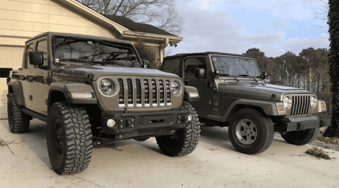

The new JT Sport w/o lift has around 9" ground clearance in the middle under the transfer case. I added better skid plates with thick bracing and now it's 8". This truck has stock size 31.7" tires, no lift. I would need a two inch lift to equal the clearance of the old truck stock, or one inch if w/o the new skid plates. Lots of stuff sticks down below that frame. The fuel tank is right there. The back axle is a disaster with stuff sticking far below the axle. Etc.
So, you are saying that the belly of your truck sits down lower than your axles? I have the Rubicon suspension in mine, and am riding on 35's... pretty sure I have over 18 inches at the frame, my rock rails are over my knees. Center of axle with the 35's is around 17 inches, with the differential at 10-12?.
The dimensions you are saying, would be lower than my stock '05 TJ The front bumper on the TJ is over my knees, skid is about 12 inches... Here's a pic comparing the two...
Have you measured the actual clearance you have below the skid plate in the center of the vehicle? From the photo that doesn't look like 12 inches.
Part of the point is the older truck has more measured clearance below the skid plate, using smaller tires, than the new truck using larger tires. And there is a difference between the "ground clearance" printed spec and the actual measurement I get from skid plate to ground.
