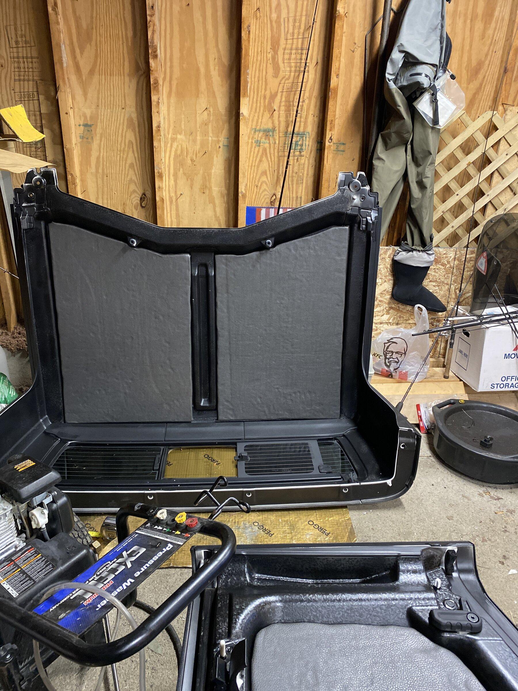

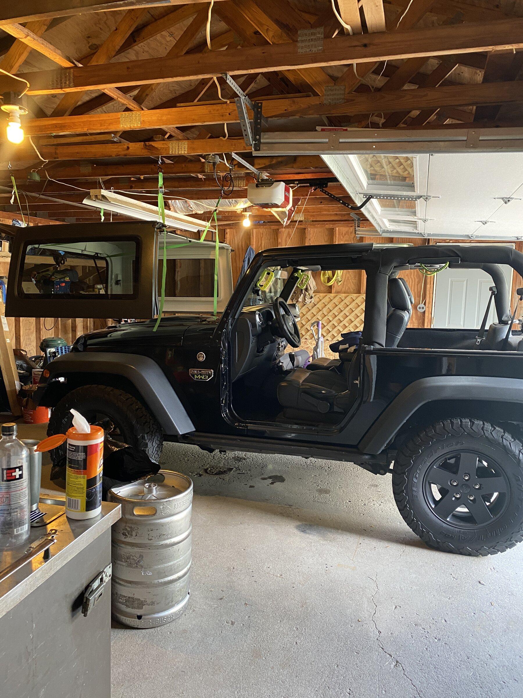

Not necessary, I’m not a big guy, 5’9, and was able to remove myself and place on a mat in a corner. It is awkward but only 50-60 lbs. with another person it’s real easy, my 15 year old son helped put back on. With my JK I used 2 cinch straps, one from front to back on either side of the top to eye hooks in the rafters , worked well and cost less than 5$.
Jeep Gladiator Hardtop cradle 4554A8D3-BBB3-4146-AFBE-CE85A1F317E1
Jeep Gladiator Hardtop cradle 3F219E2B-B8A8-430C-920E-3156E0A9317C

Where do you attach the ratchet straps to the top?
I loop each strap front to back and then hook both ends to hook on hoist. the only thing touching the hardtop is the strap material. Let me know if you need more info.
I just realized this is the gladiator forum. LOL I use this system for my JKU. I would think you could do the same for the gladiator but would have to run the strap under the top at the rear.
