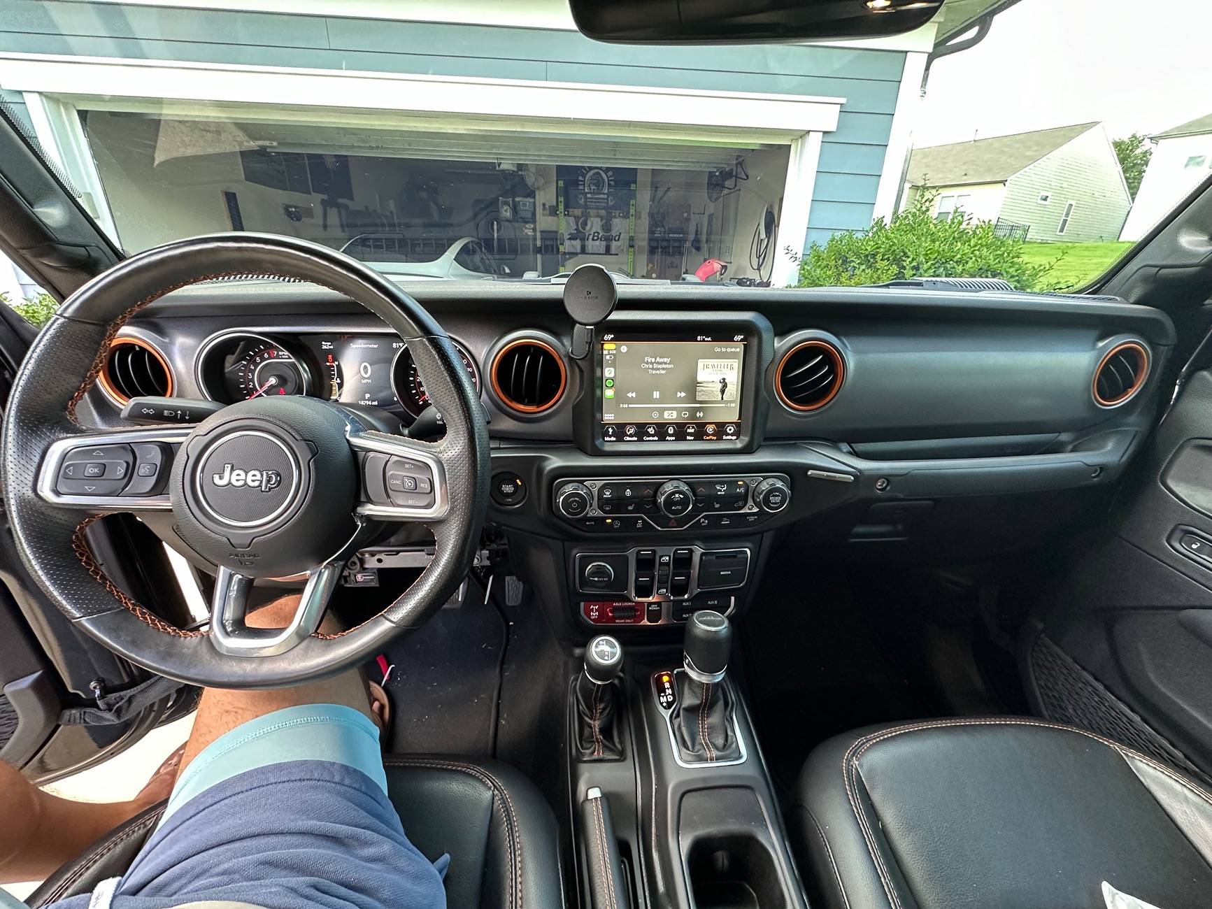

Howdy - I have added one of these:
https://www.lasfit.com/collections/...p-gladiator-jt-2019-2021-auxiliary-switch-kit
Relevant, because it uses one of the “plug and play” 12v adapters to get an ignition on hot, much like this:
RED WOLF for 2001-2022 Jeep Wrangler JK JKU TJ Unlimited OEM Power Outlet 12 Volt Power Adapter Wire Harness Switch Socket to Add Backup Camera GMRS Driving Detector https://a.co/d/2juXZH8
My question is… 1. Can I daisy chain them and add that Red Wolf adapter on to the back of the one I’m using for my switch bank? 2. If not, where else can I wire that Red Wolf adapter easily?
Notes: I am handy, did the Lasfit kit myself, but electrical isn’t my world, it’s not obvious to me. Also, not adding anything crazy, wanting to hide a USB so I can have a MagSafe charger mounted and power hidden.
THANKS

You can daisy chain the adapters off the 12v power port. The only potential problem I see is enough space for all the wire, based on your intended use.
Thanks, that was my other concern, because I remember it being a big of square peg in round hole even getting it back in with the harnesses for the Lasfit switch kit, now adding another.
Maybe I’ll just order and give it a shot…
Think I can just tap into the fuse tap I already have for some tiny LED grill lights? I have those Oracle pre-runner lights on a fuse tap….
That should work, just watch the total draw of all items on the circuit.

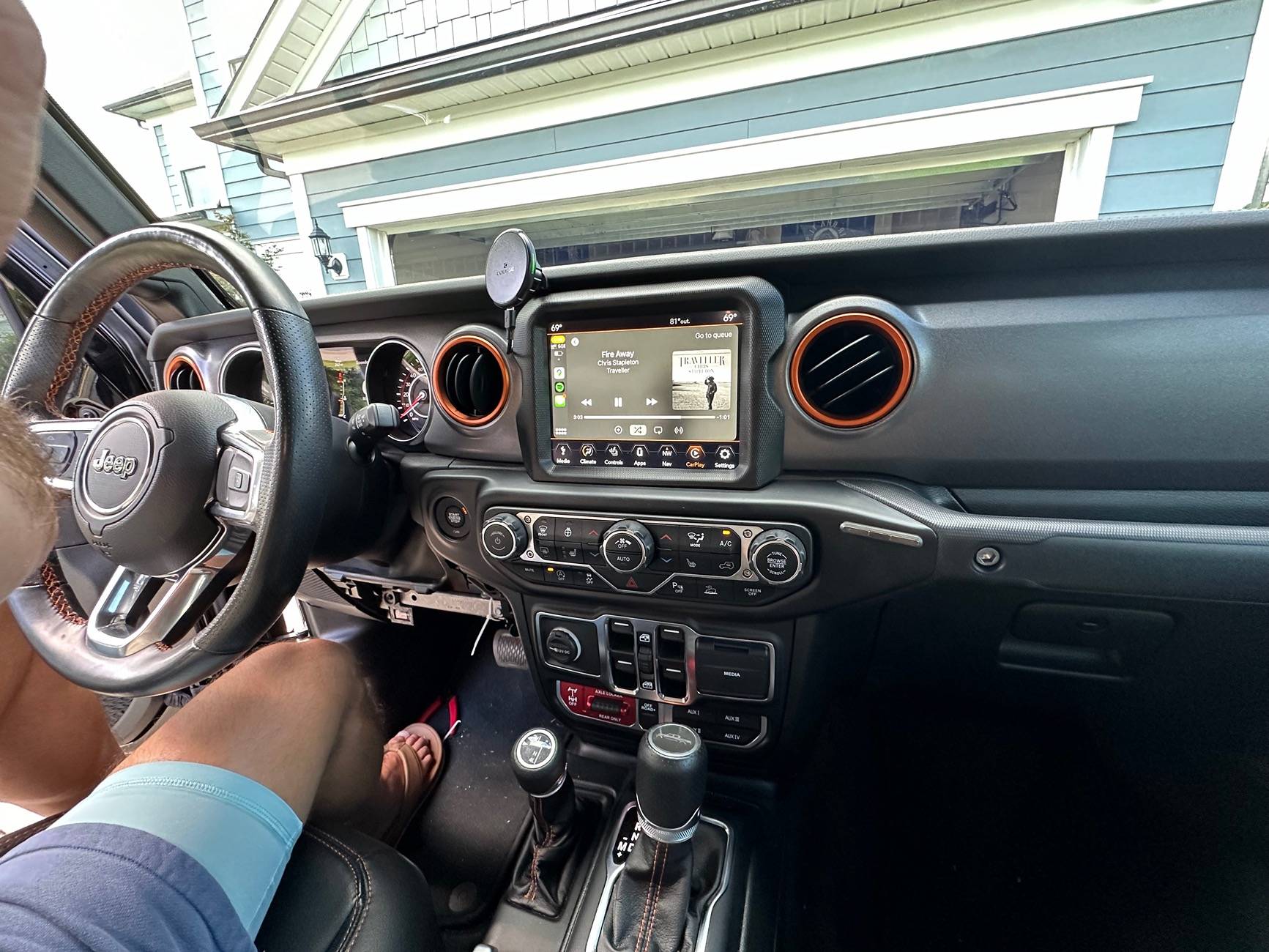

Update: I did in fact daisy chain the easy 12v add on from Amazon with the one from my currently installed Lasfit kit. Hardest part is routing things nicely.
Course Motorsports wireless charging and mount done. ✅
