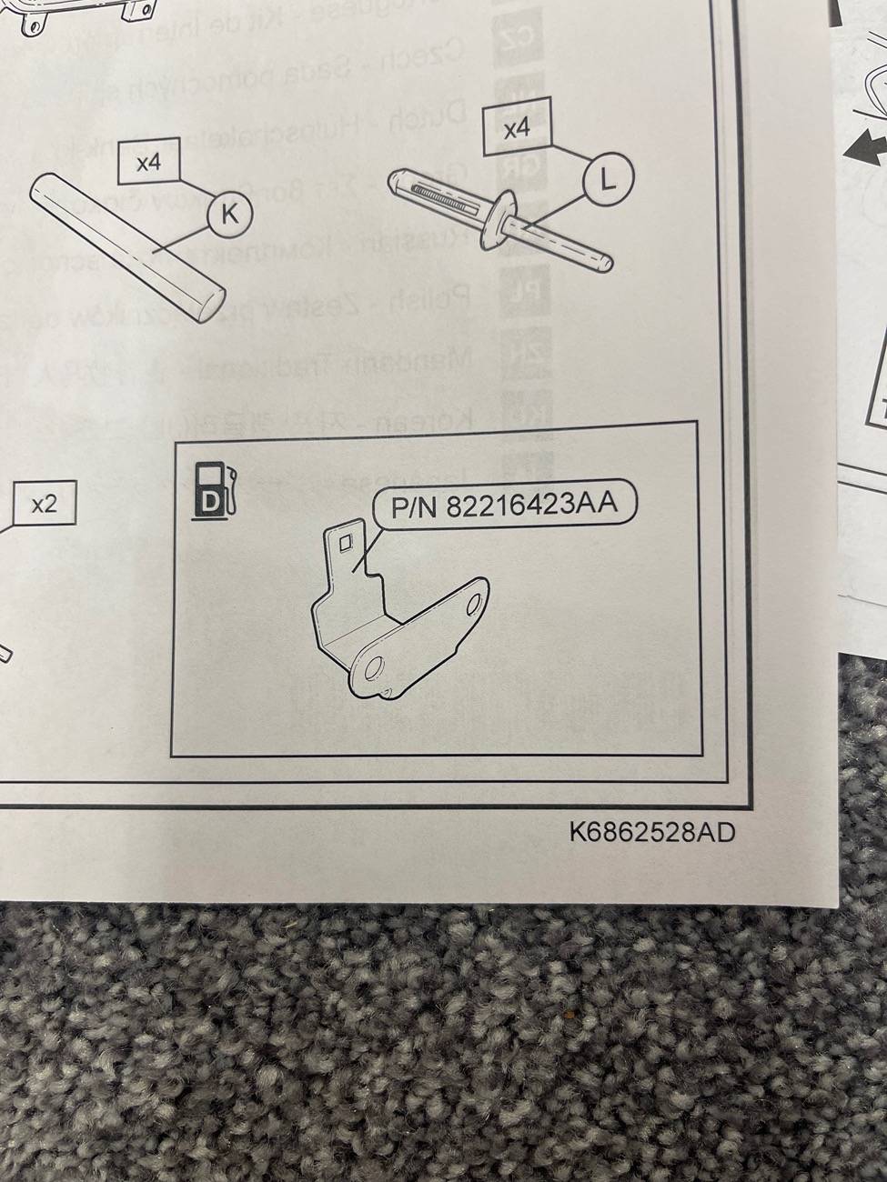

There is an additional bracket you have to purchase that is not included in the kit. I’m waiting on mine to come in before I can install my switches. I’ll get you a part number if you don’t have it already. I think it’s 25 or so dollars.

I would greatly appreciate that. Thanks for the heads up.

Hopefully this saves you some frustration. I was pissed when it wasn’t a complete kit.
That looks like the relay bracket on the driver side? Where did you buy the kit from, because mine was all-inclusive.

I purchased mine from bamwhole seller. I have not installed it. But when reading thru the directions this seems to be the bracket that is close to the battery. And it was not in the box. It’s been a couple weeks since I looked at the instructions. Still waiting on the bracket.
Ah, I just noticed the symbol...it's for diesel models.
