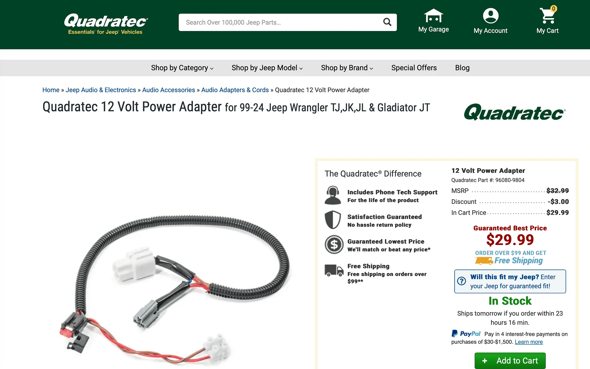

It's easy--you need to buy the connector pack 68396618AB to plug into the cradle. Connect that to the attached 12V tap from quadratec and you're good to go. Mine is set up to use the cradle just to charge. No issues.........
But you'd still have to buy the cradle, correct? I tried just putting the speaker in the existing non charging cradle and it wont fit and it doesn't have the charger in it anyway so I probably just answered my own question...
