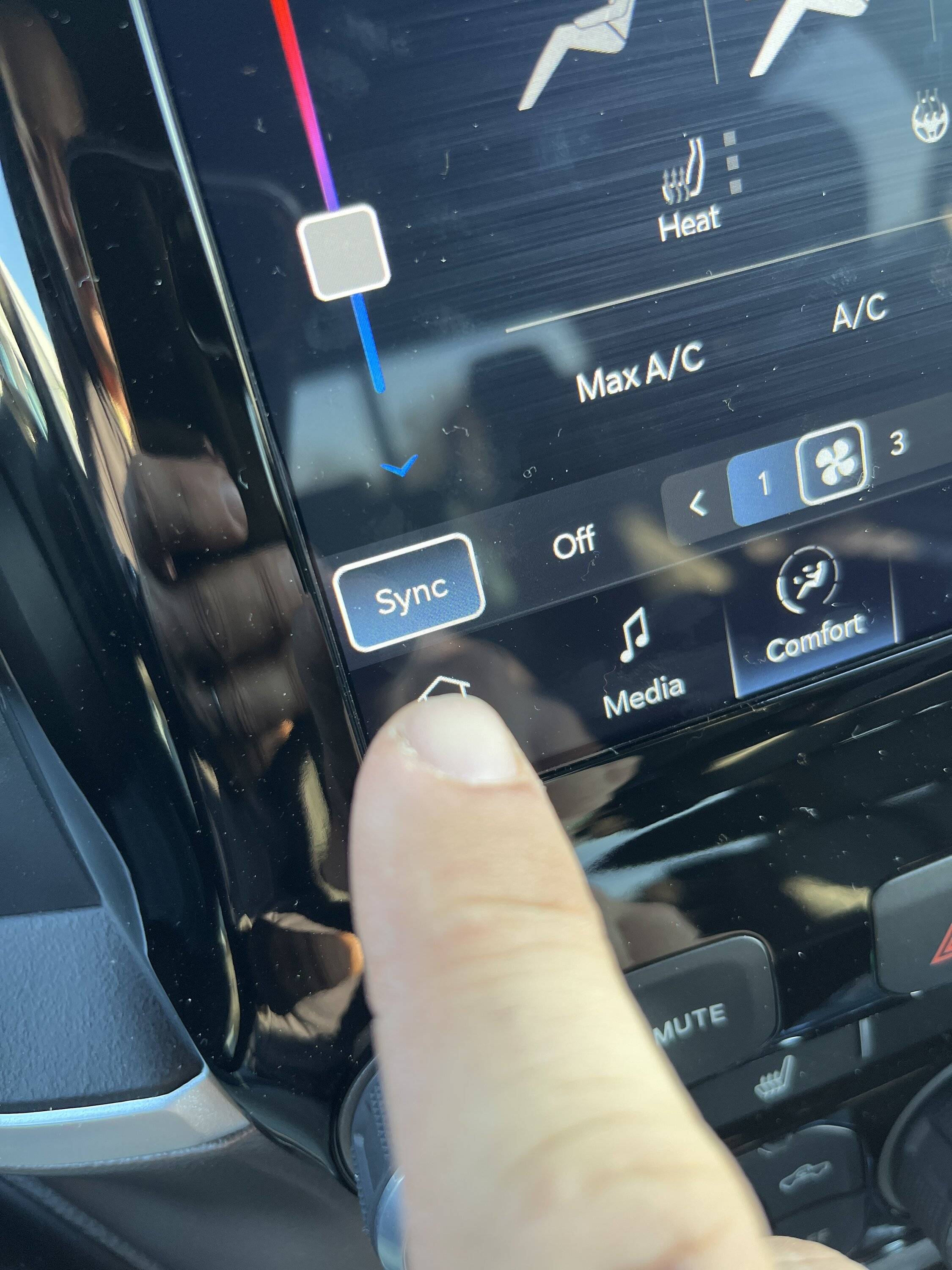

If you yave dual zone temp settings perhaps you dont have the “sync” on. If the sync is not on, the driver side can be set to 75 while the passenger side is set to low. This would cause two drastically different temperatures… I know it’s a simple solution and low hanging fruit. You’ve probably looked at. I just didn’t see it in your post.
Jeep Gladiator Heater problems image
