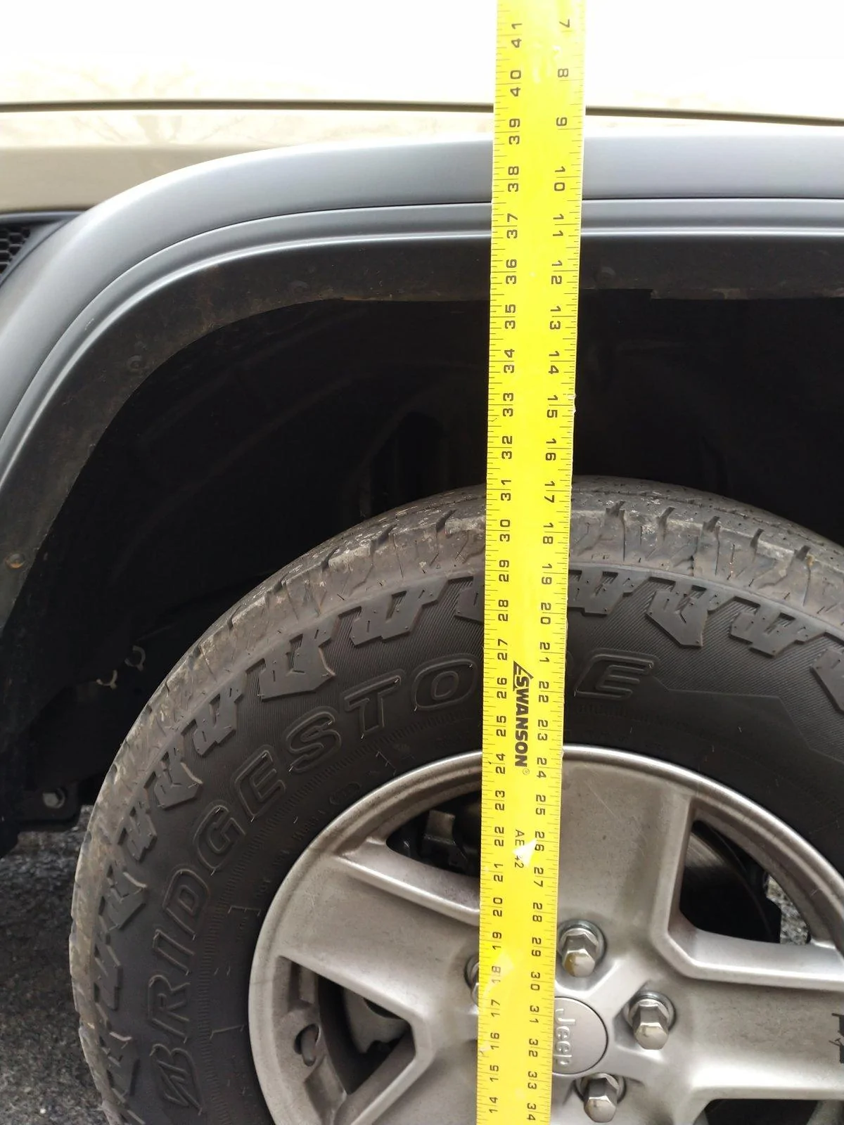

Folks, what is the actual size of the Dueler tires that come with the Sport-S max tow package? Are they 32.5? or something else? Also, what is the actual sidewall size (I think it is something like 4.9" but just wanted to verify)

You can look at tire manuf. website, but the max tow shows 245/75/17 which are 31.5

You need to be more specific. The manufacturers measure tires on a specific width wheel, at a specific pressure, and they include the bulge of the sidewalls. You and I measure often times on different width wheels, at different pressures, with the weight of the vehicle on the tire, and in a straight line. So, depending on which is important to you, the number will be very different.
For what it's worth, mine on stock 7.5" wheels at 36 PSI measured out to 31" tall exactly while mounted on the Jeep with the Jeep sitting on the ground.
I measured the tires on a Rubicon the same way and got 32.25" tall.

At 39 psi on Max-Tow 31- 31.5 in. Give or take.
Jeep Gladiator HEIGHT of the A/T Dueler tires with Sport-S Max tow package? IMG_20200217_161805
