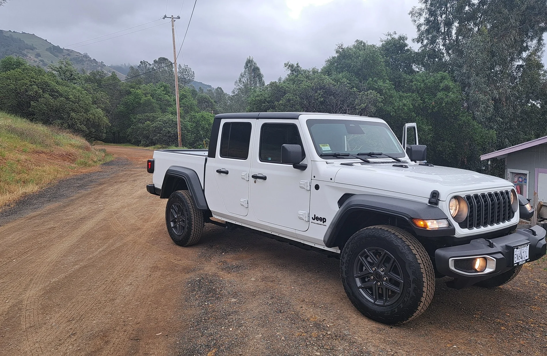

Just got it last week. I want to leave it at stock height, and possibly use the stock wheels. Not doing my homework, I don't know what width and back spacing these wheels are, so if anyone has cliff notes and can tell me that would be the bees knees.
I come from the TJ side of jeeping, still have my 03 TJ. We always used back spacing to measure wheel fitment. What's up with measuring offsets now? This ain't a tuner forum, just curious.
My other question is regarding tire size fitment. Provided my wheels have the ideal "offset", what else will I need to do to fit 35's, with swaybar disco'd?
Will I need Rubicon/Mojave flares?
Sorry for the newb questions. I did look for a bit on this section.

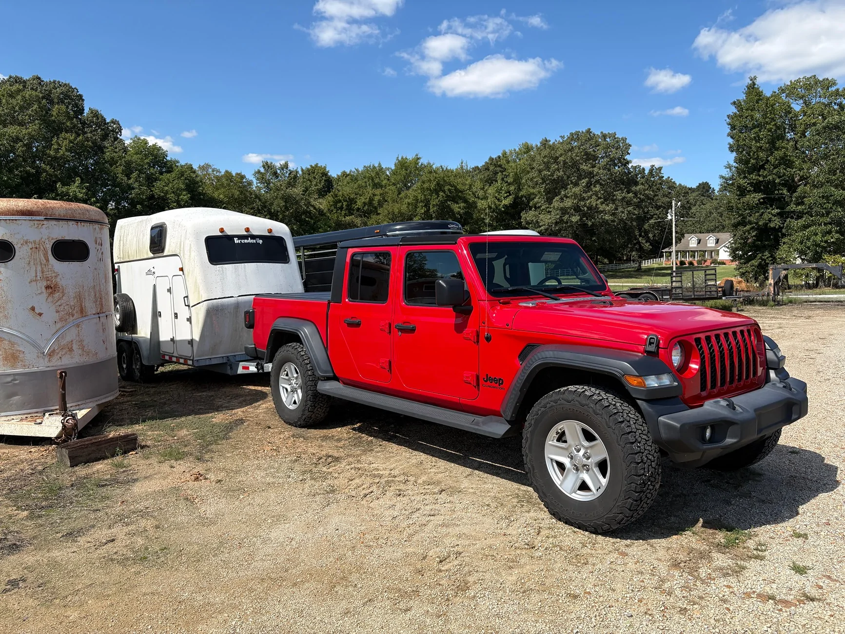

I'm running 285/75/17 BF Goodrich All-Terrains on stock rims on my 2020 Max Tow, roughly 34" tires. No lift or leveling kit. I bought it used from a Suburu dealer who had just installed them. He opined that this was the largest size that could go onto that Jeep in stock trim. When I researched it, there seemed to be some consensus on that, claim but I can't say if it right for sure. I do know that I've not had any issues at all with clearance, but I haven't yet done anything other than light off-roading with this rig. I'll likely drop down to 33s when I next need tires, b/c I do a fair amount of towing and would appreciate the weight savings. In the picture, it is hooked up to an empty horse trailer with a tongue weight of about 250#, so the rear is compressed just a tad.
