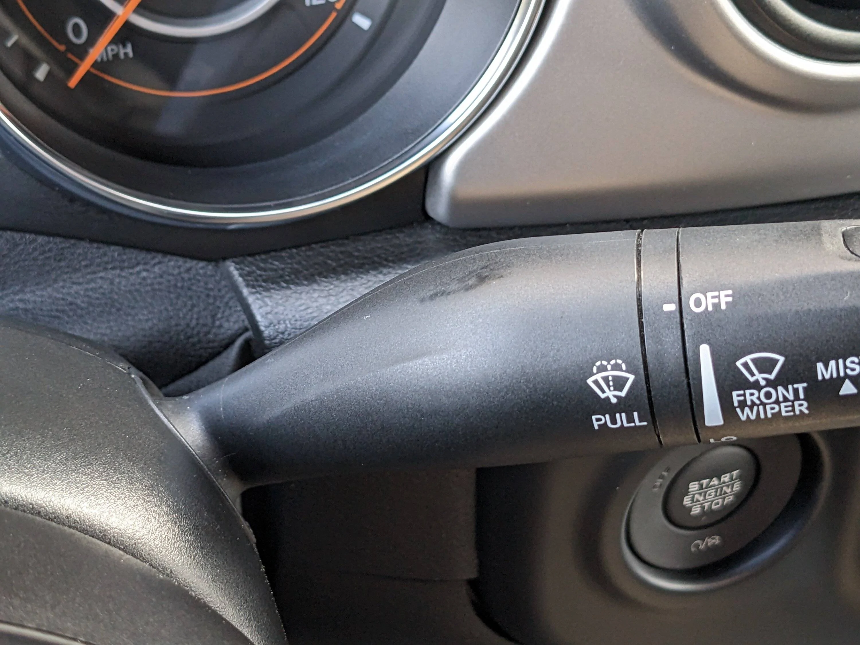

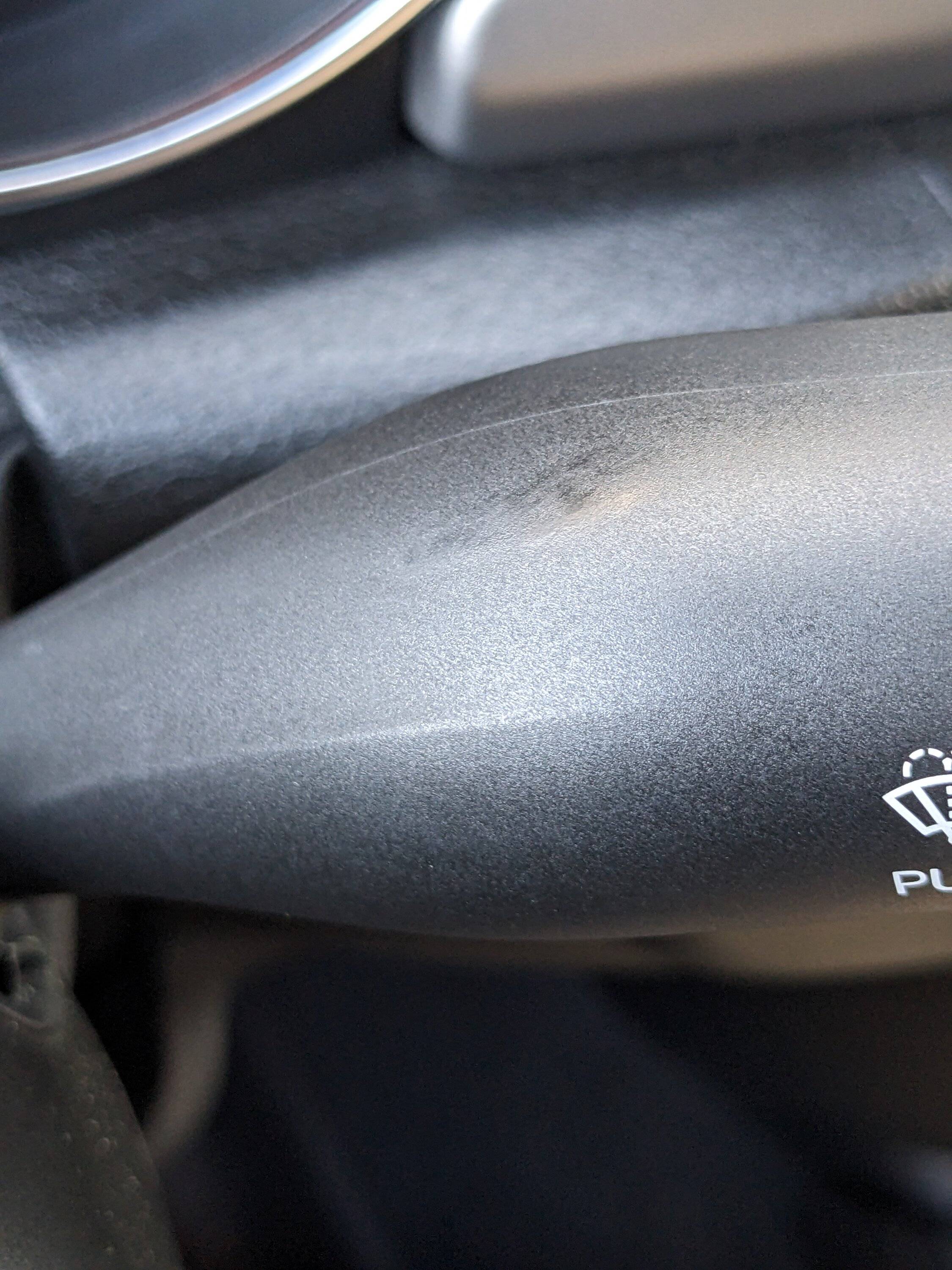

I have repaired many door panels, dash panels, steering wheels, seats etc….This paint sticks to plastic, vinyl, leather even glass. If it looks bad when you do it ,wipe it off and try again it’s water based. Once dry it holds up very well.
Thanks. Maybe I'll suggest this to the detailer if they can't figure anything else out.

You've done this on the plastic like on the wiper and light controls?
On something like this I would probably thin the paint down with a little water and go very light with edge of my finger tip or a very small fine haired brush and rub lightly over with my finger right afterwards to blend it in. If it does not look good a little soap and water immediately will remove it and not hurt what you already have. Good Luck !!

Thanks. Where do you buy that paint?

I just looked at mine these have a weird texture and not satin or flat , kind of in between. The paint you can get at hobby lobby, Michael’s, maybe even Walmart.
