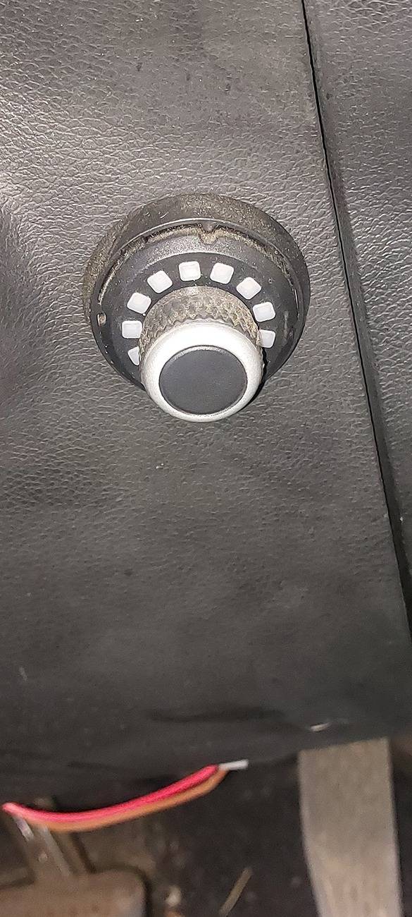

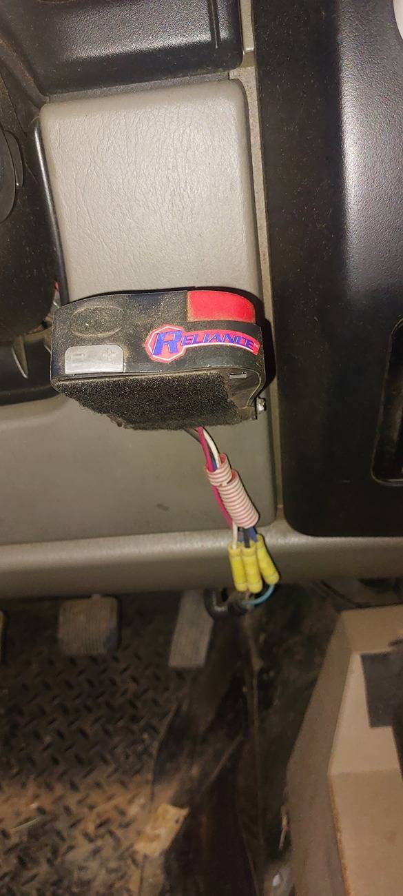

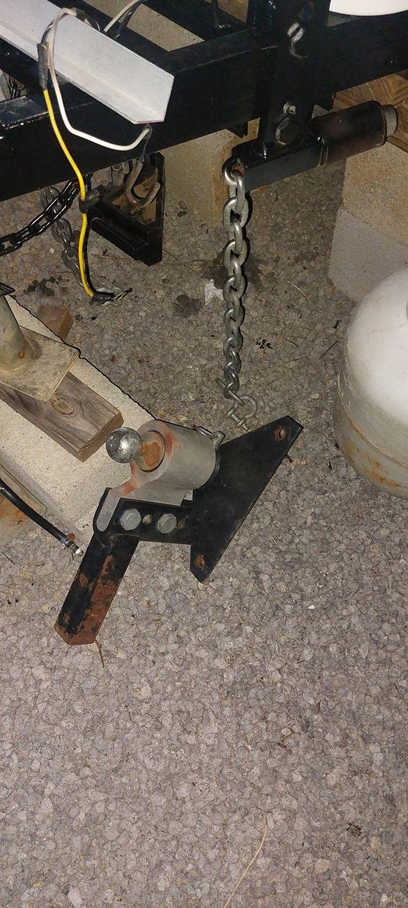

My "opinion" is to recommend WDH, and brake controller. Overall I'm just some A## hole on the internet. Now in last 4 days I've towed a heavy utility trailer around 500 miles and dropped off a 60 in zero turn mower at a shop for a friend this morning. "Interesting events in this trip... on I-state a jackass towing a gooseneck trailer weaving and cutting off many drivers, then cut over from far left lane across 2 other lanes in front of me then to have a sheet of OSB fly out, the front bumper and winch on my Gladiator ended up taking the hit at about 65 mph. What does this have to do with WDH and trailer brakes, raining and a lot of traffic so hitting the brakes would have put my vehicle/trailer (no trailer brakes) in to a skid to probably hit other vehicles and cause a crash. FYI: the jackass seen the sheet fly out cut back into center lane zoom up the back to then jumped off at the exit. Now a note on Gladiator brakes they can "stop it with a trailer tested today with said mower on trailer, wet pavement and the stop was quick but this trailer has low COG, 16ft long max including the tongue and over 15% tongue weight.
I have a Anderson WDH on my Scamp and brake controller in my JT and LJ. With that you can apply trailer brakes to slow or reduce trailer swaying to a point. Let alone in "panic" braking situations needing to stop now.
Jeep Gladiator Help me bring home my camper. 17212655436991328599713759369031
Jeep Gladiator Help me bring home my camper. 17212656450612532867327593408155
Jeep Gladiator Help me bring home my camper. 17212657038225841870508234988700
Cheap compared with the cost of your vehicle, T.T. and safely.
