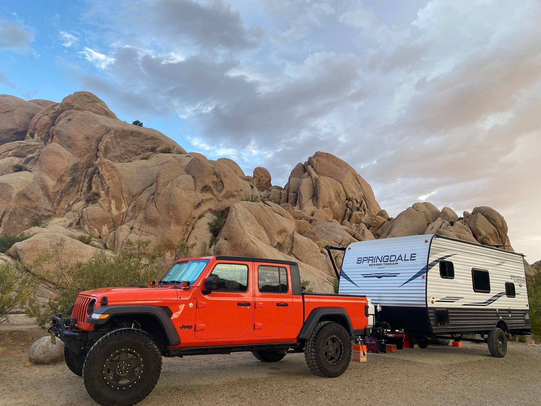

Going to second this, but qualified.
My trailer had a WDH on it when I bought it. Whenever I'm moving it around the campsite without the sway bars, it's quite unnerving. I have a similar camper to OP, which is a darty, "lifted" version of the single axle camper. I'm going to vote for YES for WDH for a long tow.
The brake controller? Full confession here- I've towed for years without one. I literally just used my Curt Echo for the first time this past Sunday. Couldn't feel a difference. I'd rather have it than not have it, but by no means is it a NEED. I towed all over the place, on 37s, and never felt like the brakes were overloaded. Granted, my trailer brakes might be luckily tuned to my own brake pedal, but I wouldn't say a controller is NEEDED, as in OP will certainly die without one. I'm sure some added vigilance and reasonable driving will be fine for the journey home.
