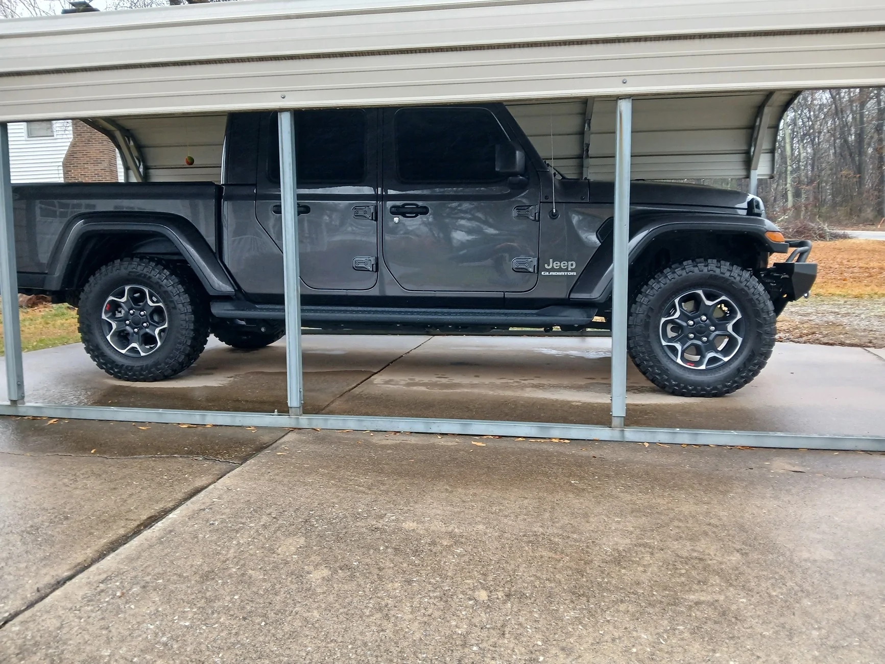

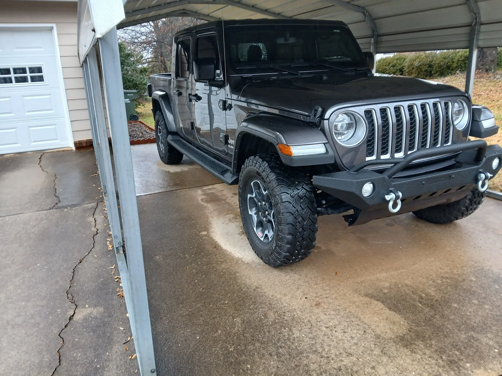

I have a 24 sport s with max tow. I went with 285/70 r 17 using stock wheels. The AT tires I went with are non LT westlake from discount tire and were about $700 out the door. I went cheap just to see if I liked the setup first and will get better ones next time around. So far I am impressed with the tires for the price and zero rubbing and ride is good since they are lighter not being LT. Only thing I still want to do is put a 1.5 or 2.5 level kit on just for looks as the factory rake look drives me crazy. Since mine is still new (good deal on 24 model late in 25) I am debating going with 1.5 teraflex just the “pucks” or going with the 2.5 rough country or similar that also come with the larger sway bar extensions and shock extensions to use the factory shocks. Price is about the same and looking at installation would be the same since bottom shock bolts and sway bar links have to be removed anyways to drop the axle. It’s my daily driver and what little off road would be light trail ridding. I just don’t want to over level the front and rather a slight rake in the front then ending up with a Carolina squat starting kit lol.
Also just a side note if you haven’t already, getting a Taser Mini to change tire height not just for the correct Speed reading but more for transmission shift points makes a huge difference. Shoot just the auto start/ stop cancel paid for itself in my opinion.

Little off topic... But I have the mopar lift, 3/4 spacer up front, Terraflex hubcentric 3/4 wheel spacers, factory steelies wrapped with 35x11.5r17. Works great. No issues and just enough poke

I've run quality spacers an my JT with 35" tires and the old WK I had. Currently running them on my wife's 2015 WK2 since new. Never had an issue with them. My purpose was to achieve amore aggressive stance like you mentioned.
To me the Teraflex spacer lift & the larger tires sounds perfect to me. Do a search here and find many that are running this same same up.
