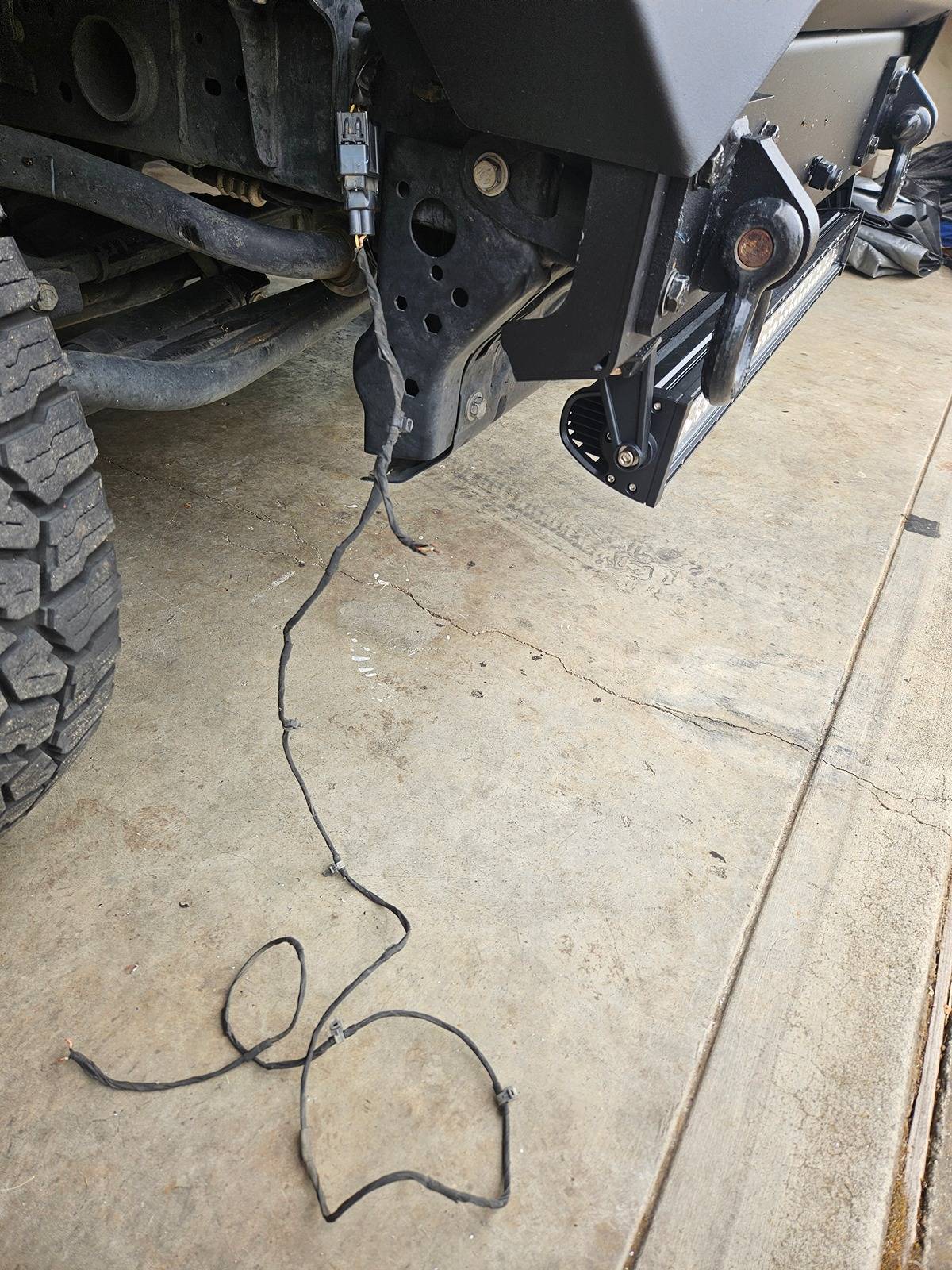

I recently swapped out my bumper and there was no place for the fog lights so I removed them and put a LED bar under the bumper.
LED bar is wired in and working, using a toggle switch but I would like to drop the switch and have it controlled by the fog light button if possible.
Jeep Gladiator Help wiring LED bar to factory fog light button 20240614_151612
Jeep Gladiator Help wiring LED bar to factory fog light button 20240614_151627

It looks like you already chopped up the harness for the fog lights. I would put a relay inline put the proper connector for your light bar and plug it in. When I replaced my bumper I was given adapters to adapt from the factory harness to the lights they provided.

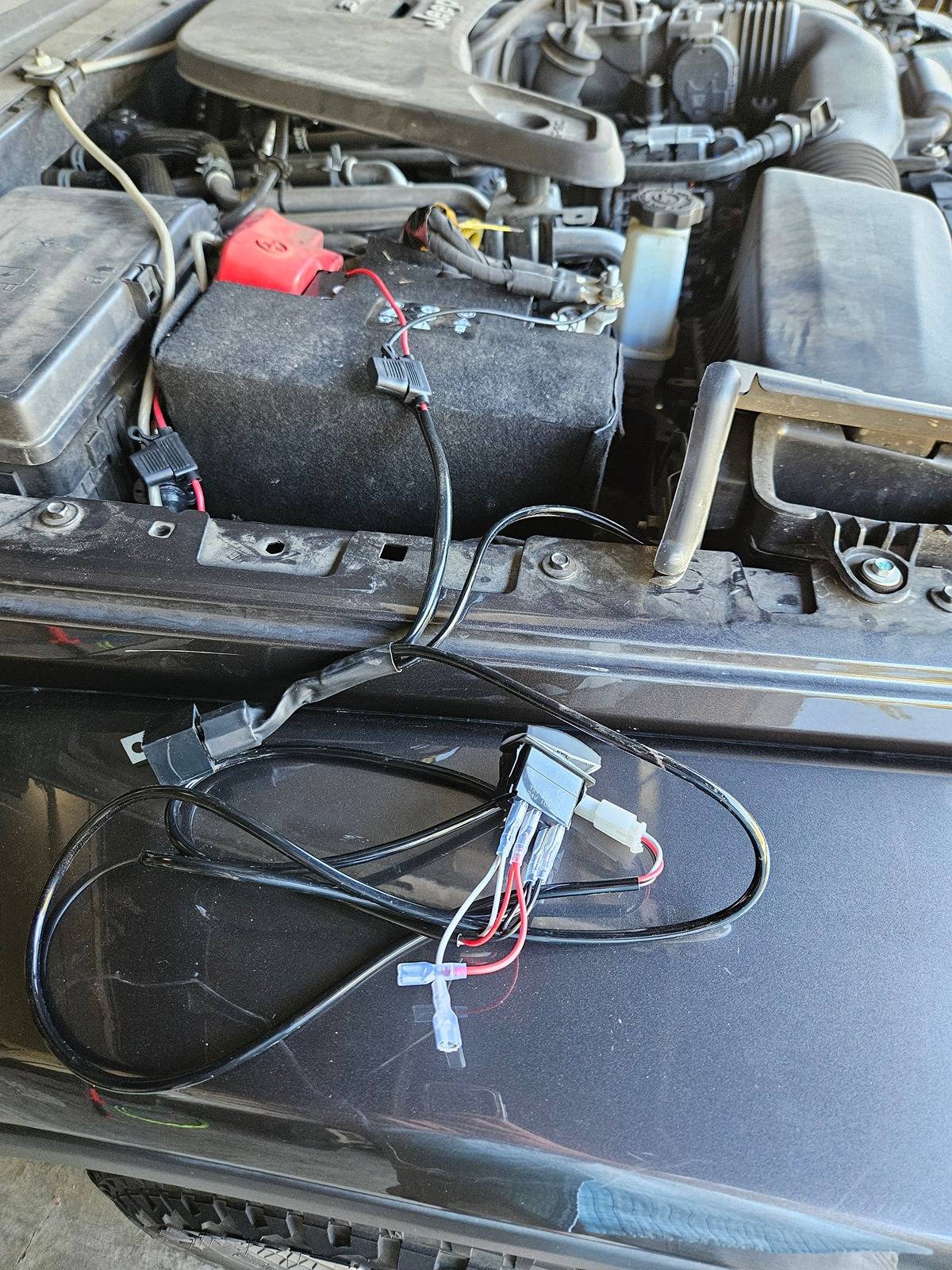

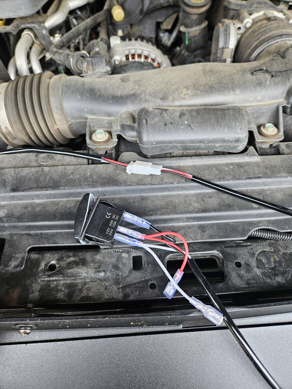

just got back in town - I'm not sure I follow (and probably didnt do the best job posting pics / explaining my setup)
I am using the LED bar setup currently, which has:
Positive & negative to the battery with a 15a fuse, which then connects into a relay. From the relay there are red/white/black wires going to a rocker switch & red/black going to the led bar... Where would I wire the factory fog light wires?
Jeep Gladiator Help wiring LED bar to factory fog light button 20240624_184214
