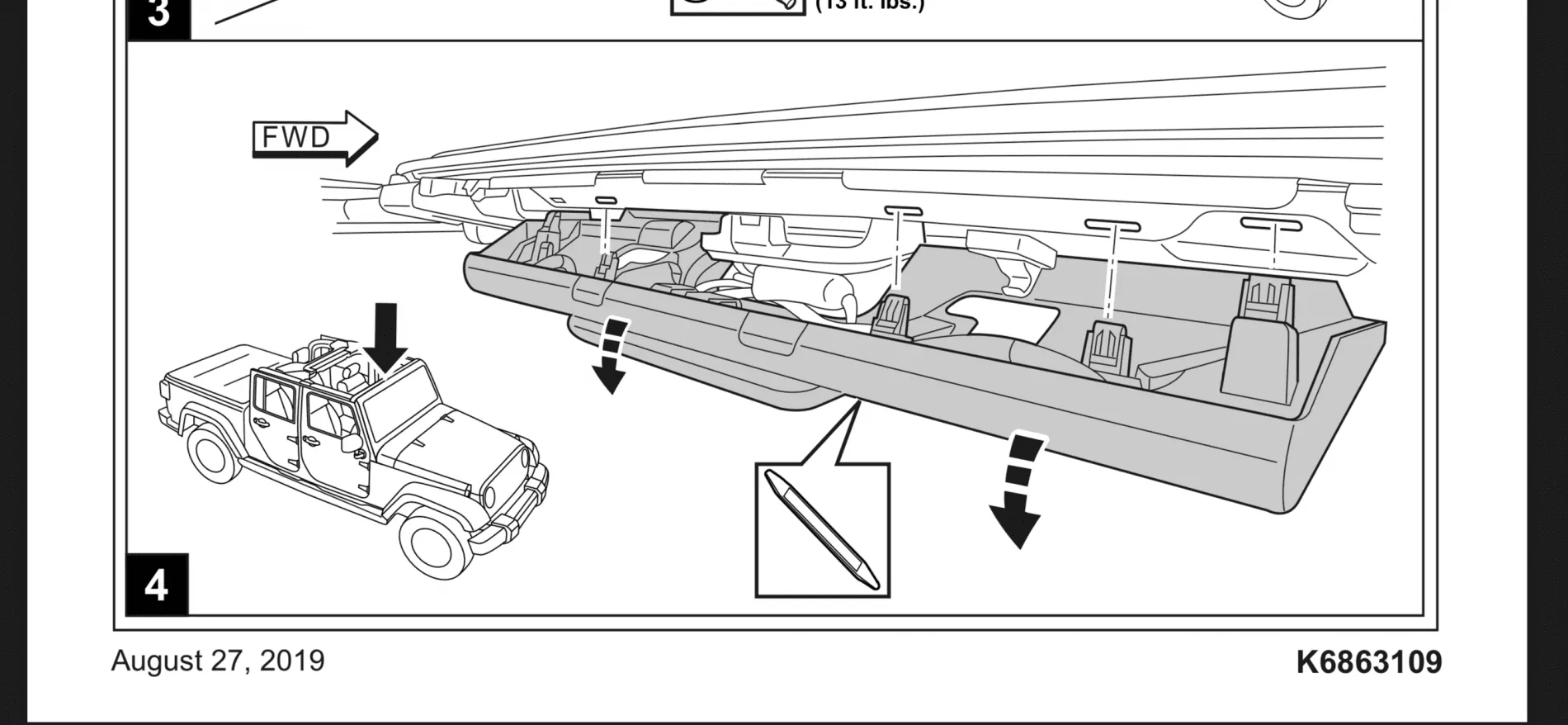

Tomorrow morning I’m swapping a Gladiator hardtop and softtop. My only issue I can think of is dropping the windshield header to remove the Freedom panel brackets. Does anyone have any experience in prying the header apart? I don’t want to break anything. I’m grateful for any direction or suggestions. Thanks, Brent

View of header separated

It just pulls down. You can watch the install video on JCR's website for the overhead molle panel.
I assume you mean you are trading with someone else as those don't need to come off to install a soft top.

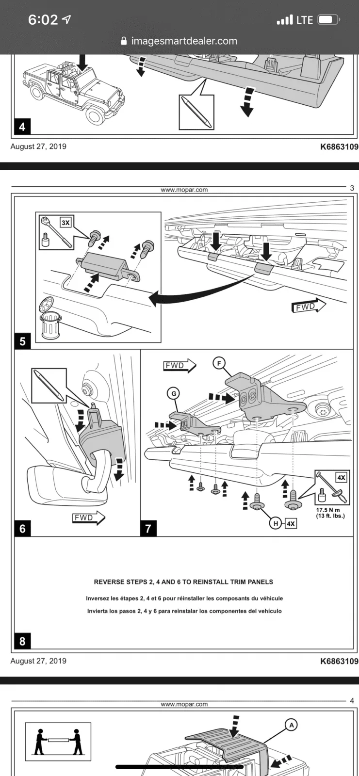

Yes that is correct. I’m swapping my soft for a hard and I need front and back brackets for my jeep. Could you post address for video you referenced please. The photo I have shows a prying tool. Thanks

Got it. It helped, thanks. Still just one of those tough areas to get to. But mission accomplished.
