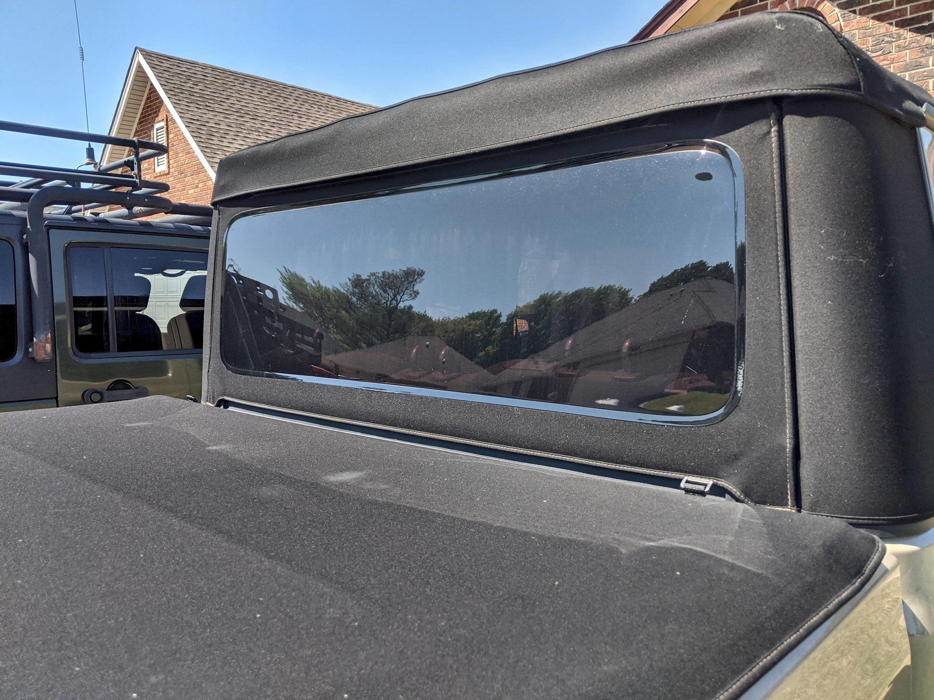

Bought a slightly used OEM roll up tonneau cover and it has a few scuff marks that are a little white due to UPS handling during shipping. So question is what is the tonneau made out of and what would be the best solution to try and remove the scuff marks or lessen them.
Im thinking they are the same twill material that bestop uses and was thinking of using their protectorant solution they sell for twill
I have both the roll-up tonneau and premium softtop. The fabrics are identical ...
Griot's Garage makes a convertible top cleaner that has worked very well for me on the tonneau.
You should be able to treat the premium material the same as our Twill material. The protectant will be a good add-on but try simply cleaning it with a soft brush and/or light pressure with the car wash gun at the DIY car washes. It's pretty amazing material and cleans up very well.
