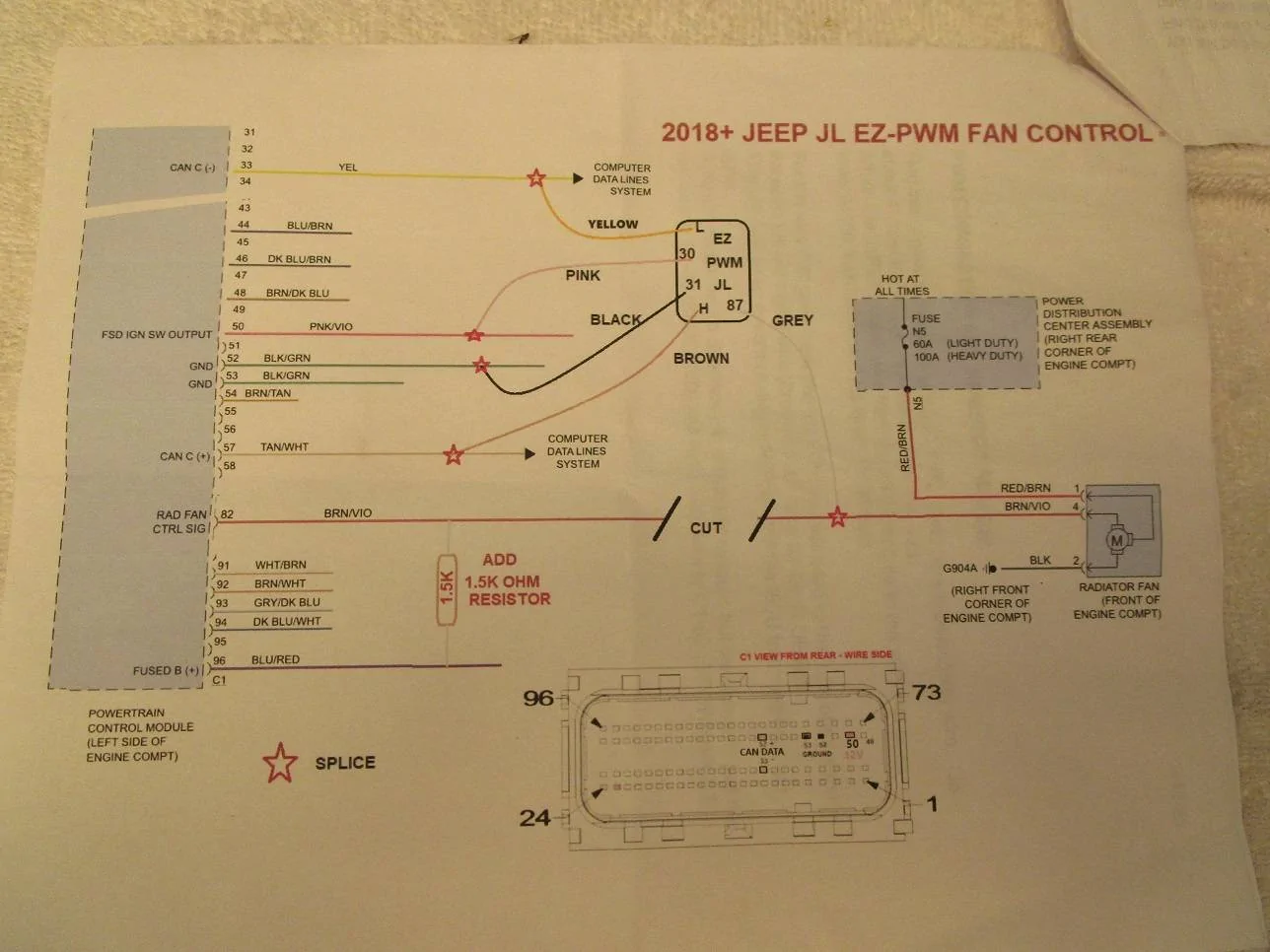

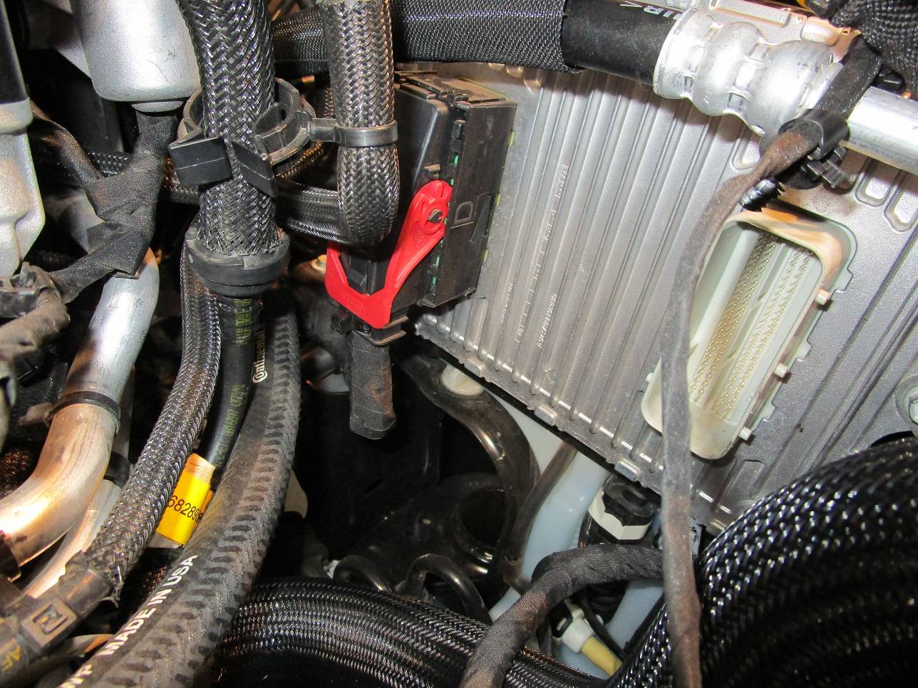

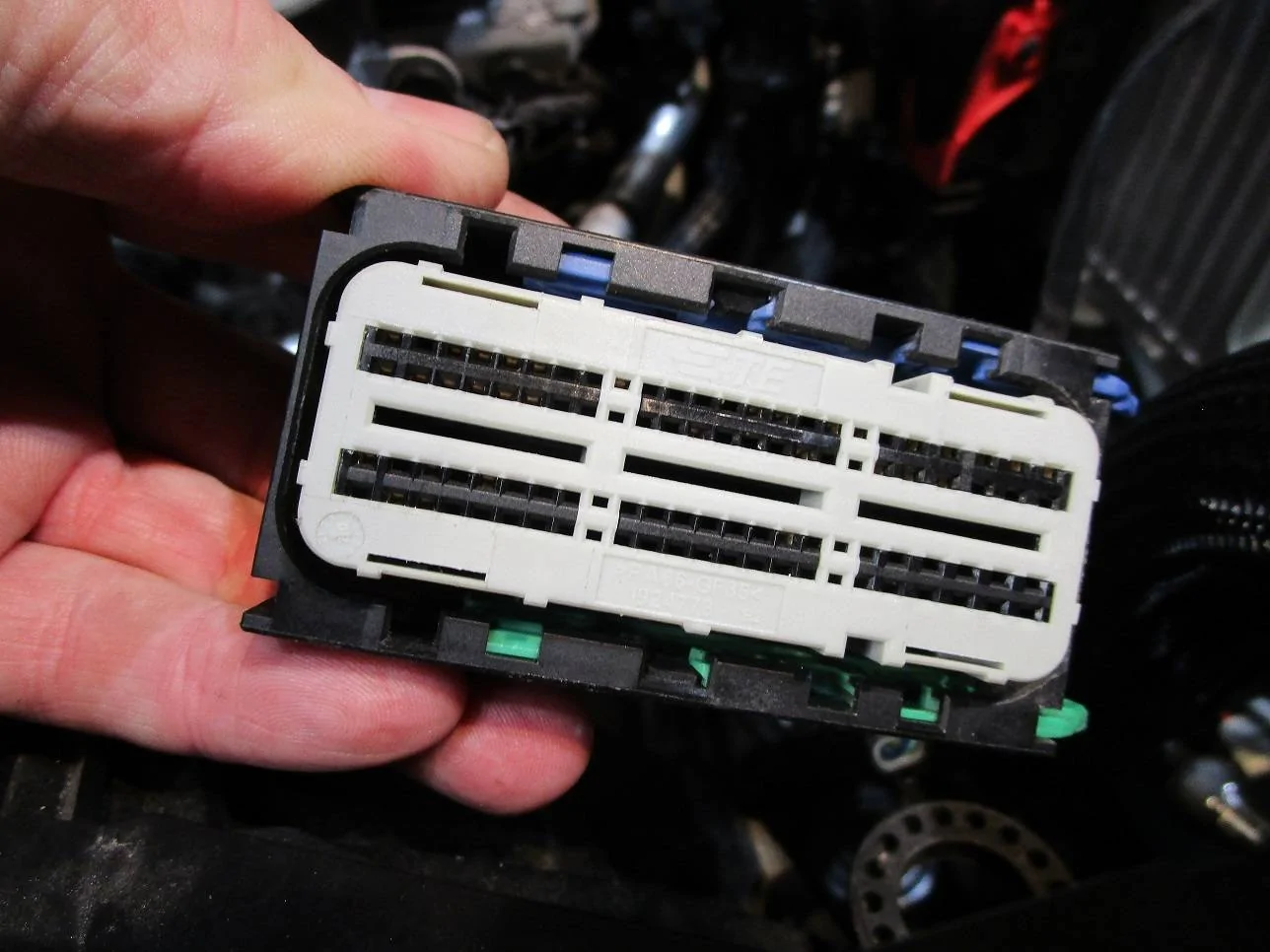

Hey thanks for the report - how was the install? how did you tap in to the can bus?
willys 41
Larry Olund
Oct 12, 2022
447
443
Pleasanton Ca.
2020 Jeep Willys
Machinist / Auto Technician
More info
The plug that you see you pull back the tape on the loom to get to the wires

Got it - Thanks! Unfortunately, this looks like it is one of those mods that is best postponed till you no longer care about warranty protection.
