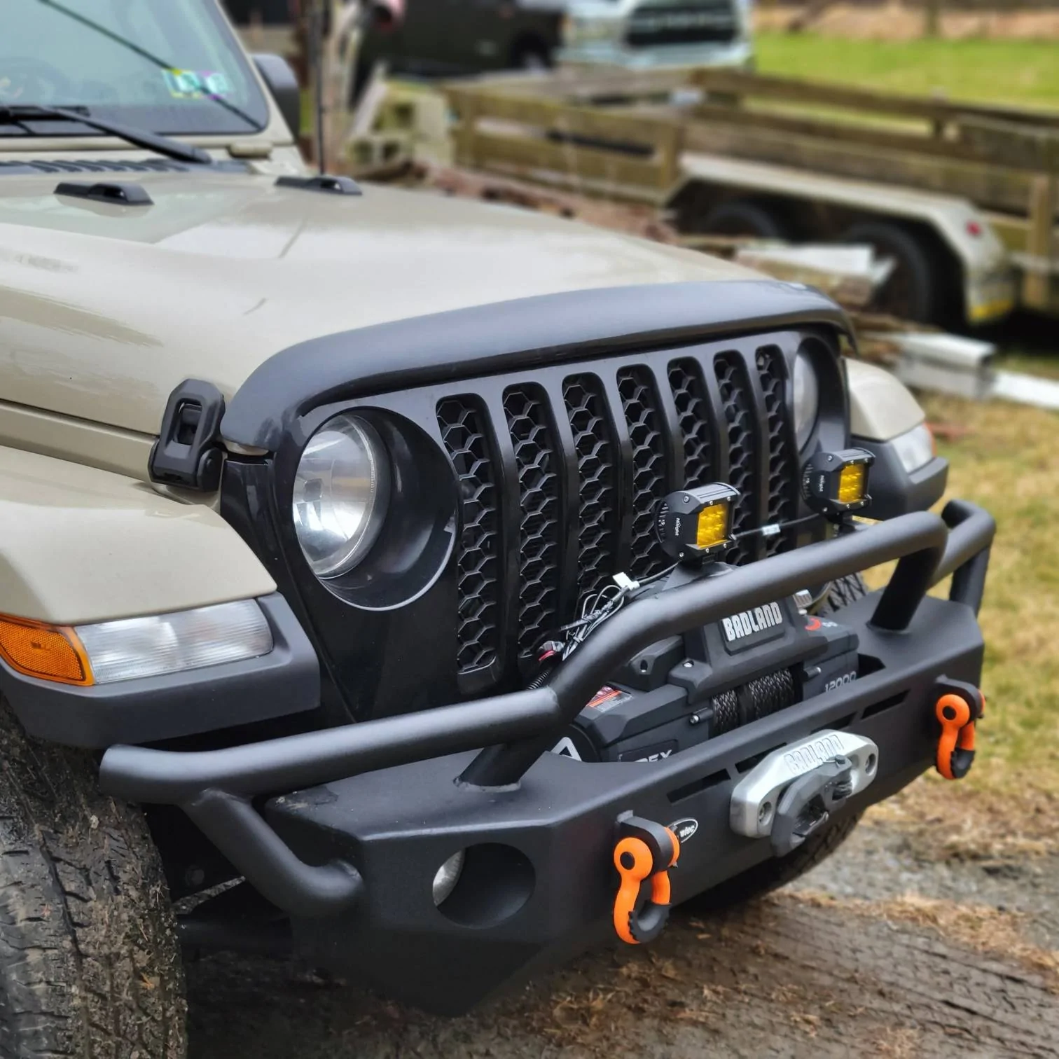

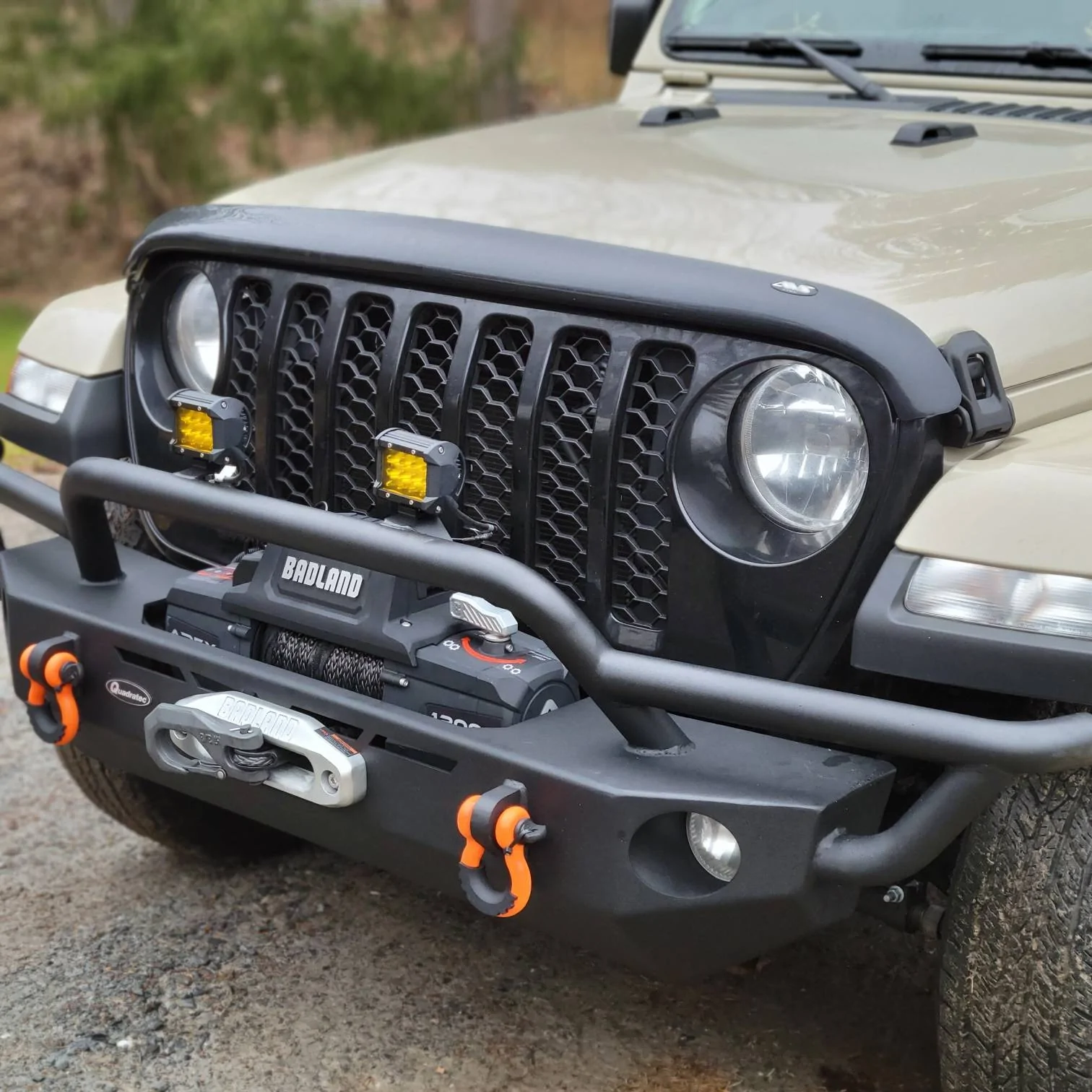

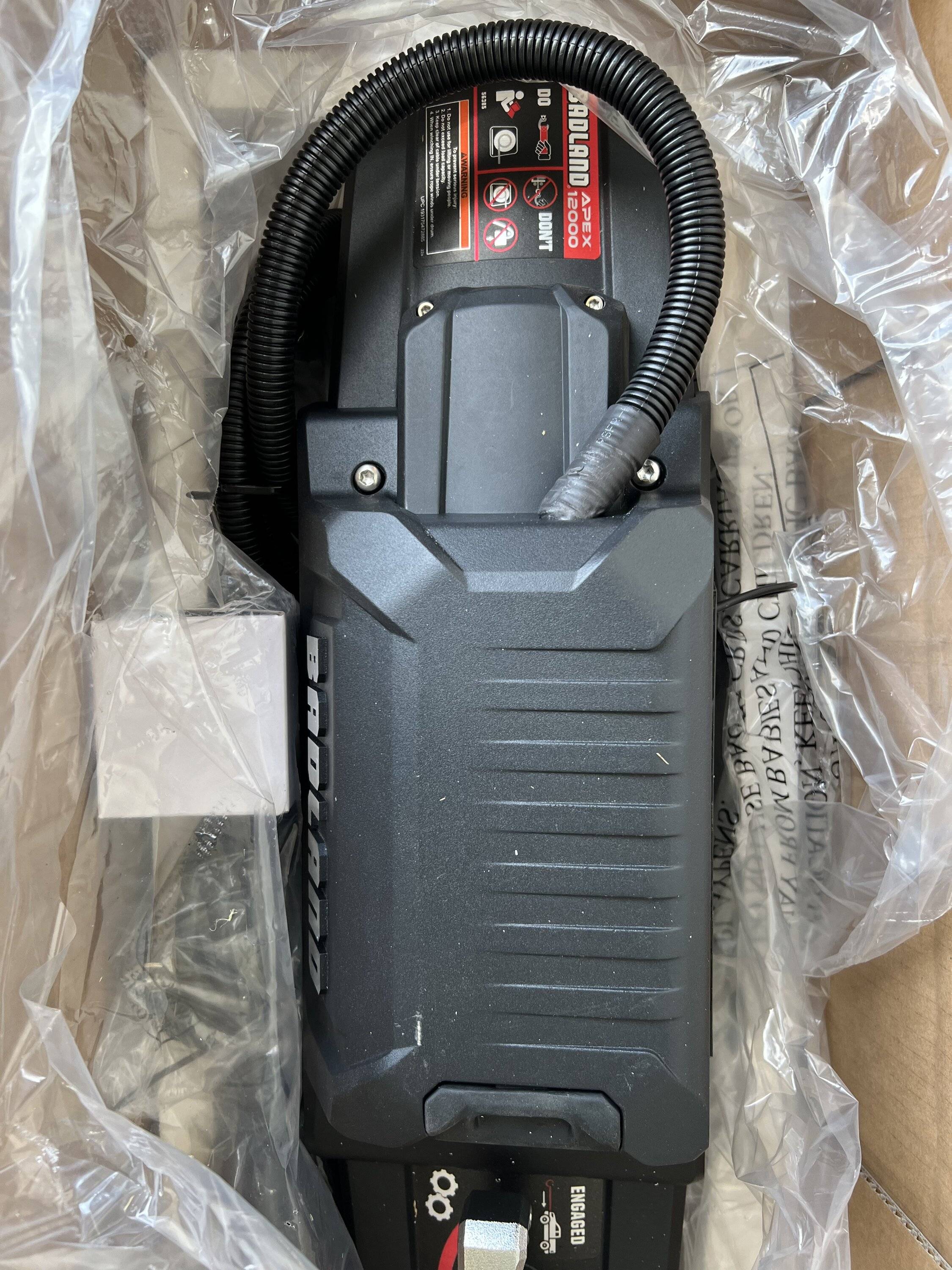

got mine for the Gobi 22 JT yesterday .. wife's Nacho 21 JT already had one ... grandson and i put it on yesterday 12/30 .. IF you have the HF credit card you can also use 0% for a year ... pixs to follow

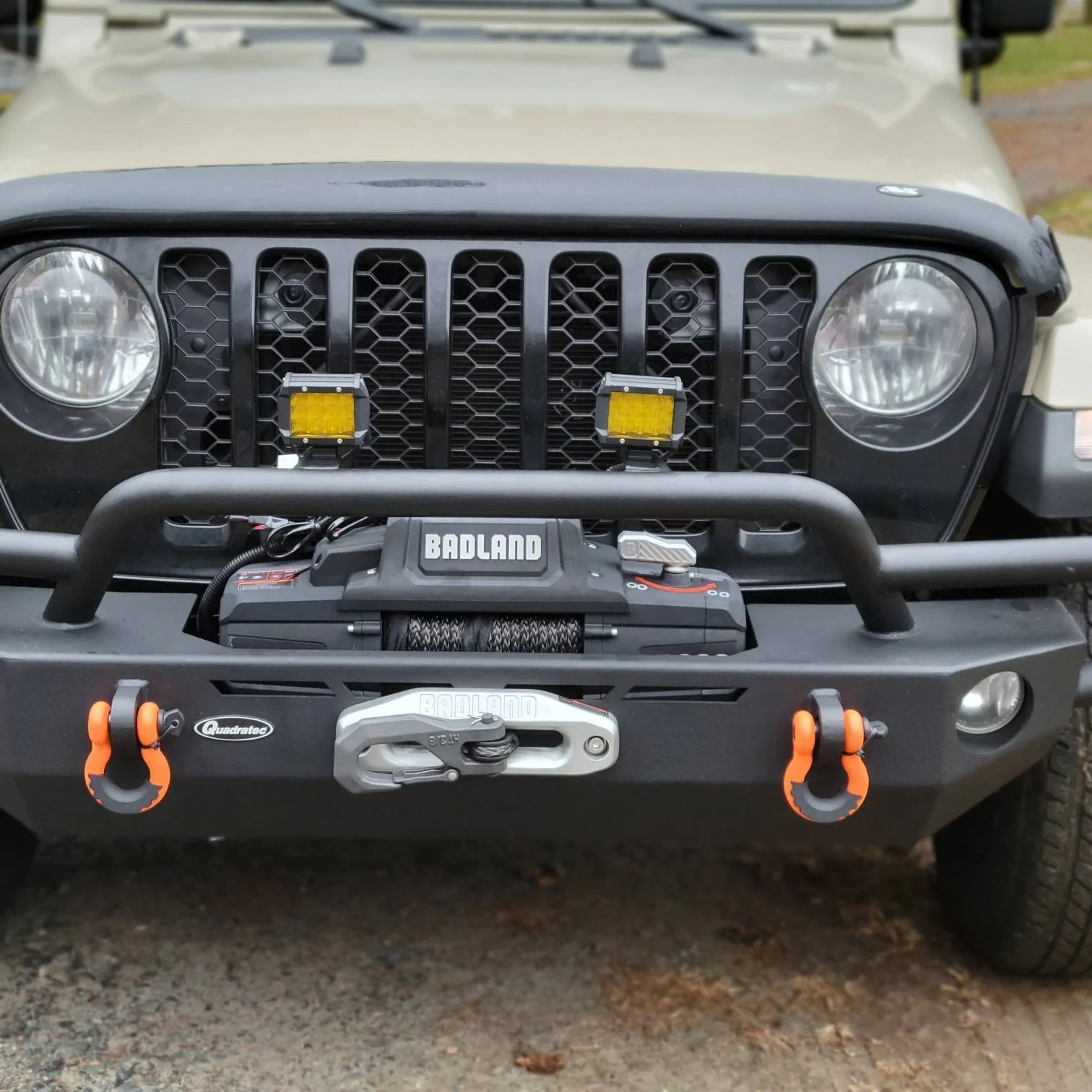

ok, here are the pixs as promised ....
Jeep Gladiator HF Badlands 12K Winch 25% off until the 2nd. 20221231_092455_resized
Jeep Gladiator HF Badlands 12K Winch 25% off until the 2nd. 20221231_092505_resized
Jeep Gladiator HF Badlands 12K Winch 25% off until the 2nd. 20221231_092519_resized

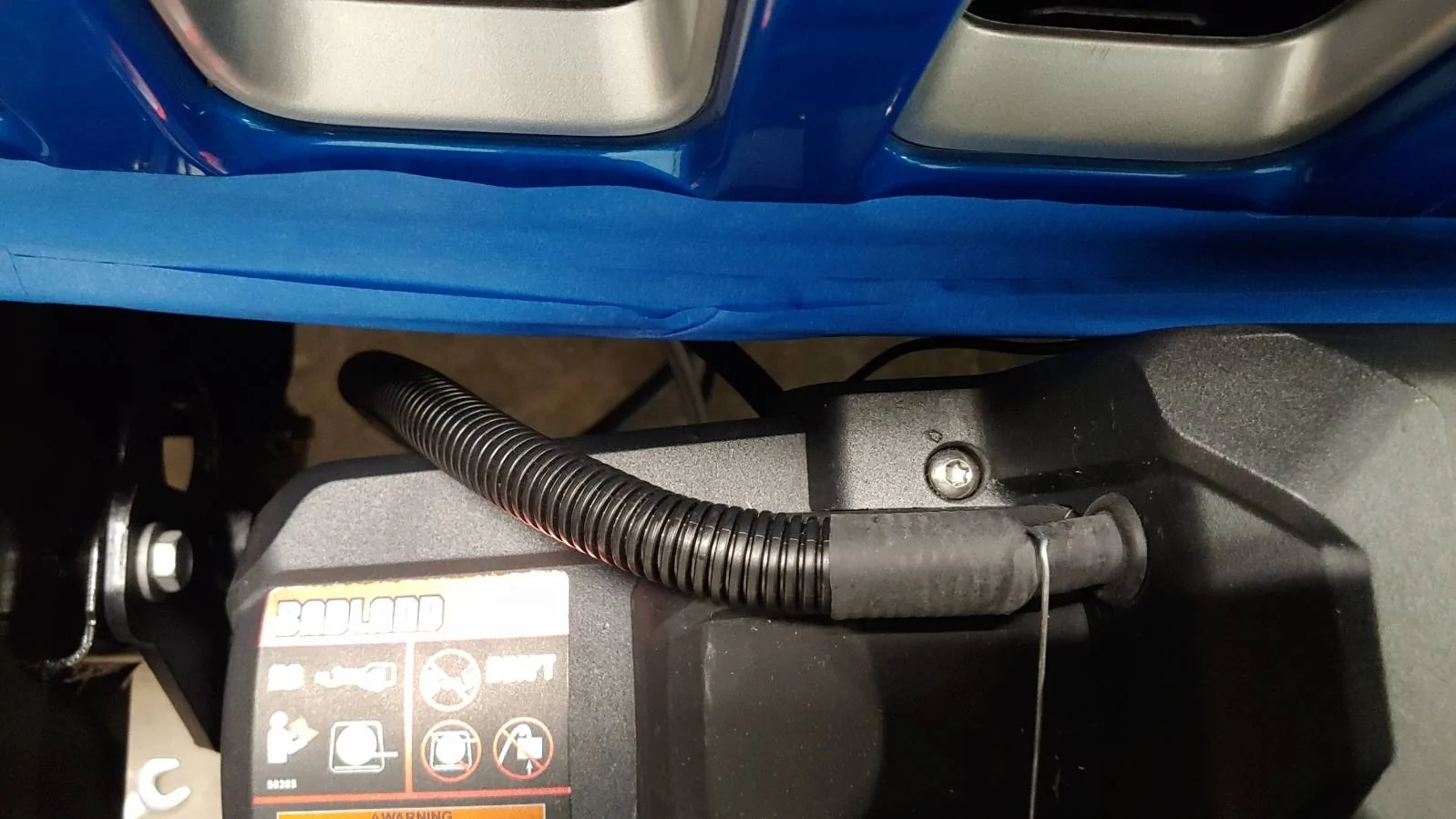

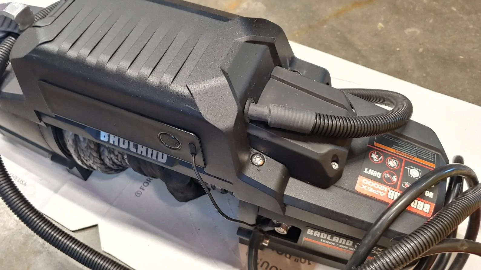

This is my 2020 ->
Jeep Gladiator HF Badlands 12K Winch 25% off until the 2nd. 20201015_170039_HDR

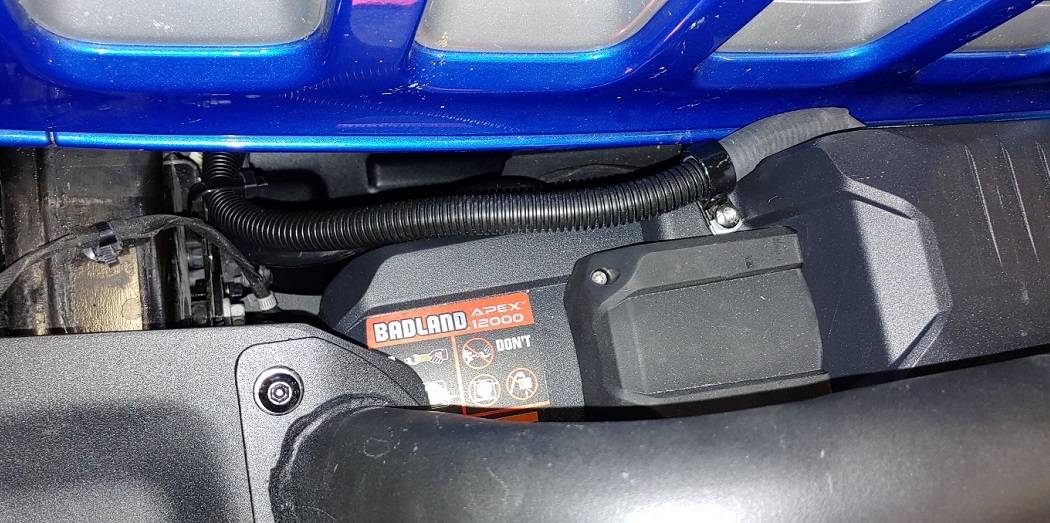

Same winch moved to my 2022 after I relocated the cable (that silver line is a wire I used to hold up the rope on the front to keep it out of the way while working on things) ->
Jeep Gladiator HF Badlands 12K Winch 25% off until the 2nd. 20220824_144945
I plugged and sealed the original hole the cable ran through with a solid grommet ->
Jeep Gladiator HF Badlands 12K Winch 25% off until the 2nd. 20220810_102016_HDR

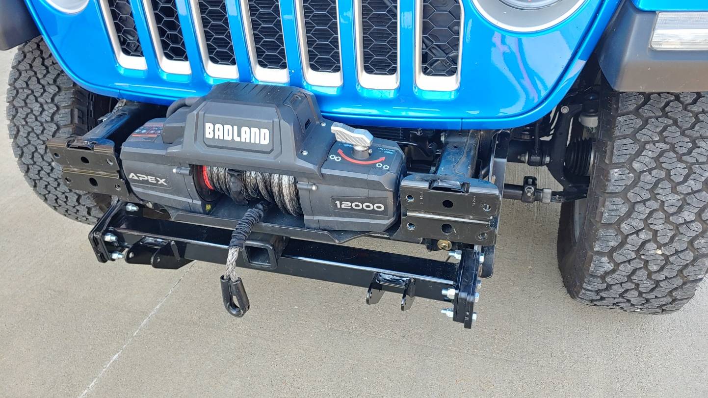

I also have read you can get spacers to make room off the front of the grill.
A forum member sells spacers that work to move the bumper out, but that won't help if you use a winch plate like the bull dog plate which goes behind the frame bumper mounting ears.
The spacers fit between ends of frame and the bumper to move the bumper forward to clear the winch if needed. But they won't help with many winch plates that fit behind the frame "ears" like mine ->
Jeep Gladiator HF Badlands 12K Winch 25% off until the 2nd. 20221006_103958_HDR
