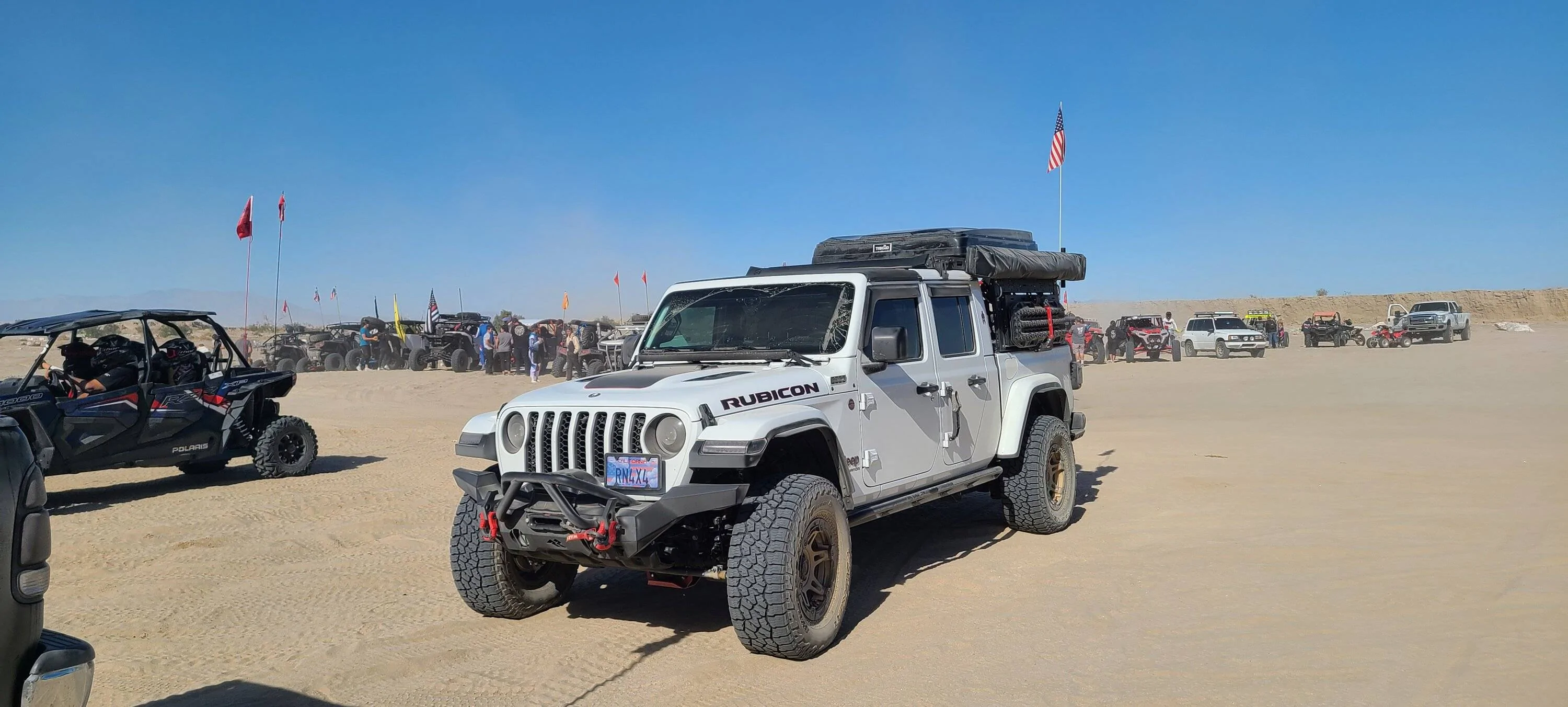

Took advantage of the deal!!!
Went with the rugged ridge hd full length… should be here this weekend. I like the looks and protection of a full size over the stubby.I have this combo and can’t recommend it. Its too tight a fit and will involve a bit of cussing. The bumper is a PITA to line up all the holes to get the front bolt’s through. It does look pretty good but personally I would shop another bumper.

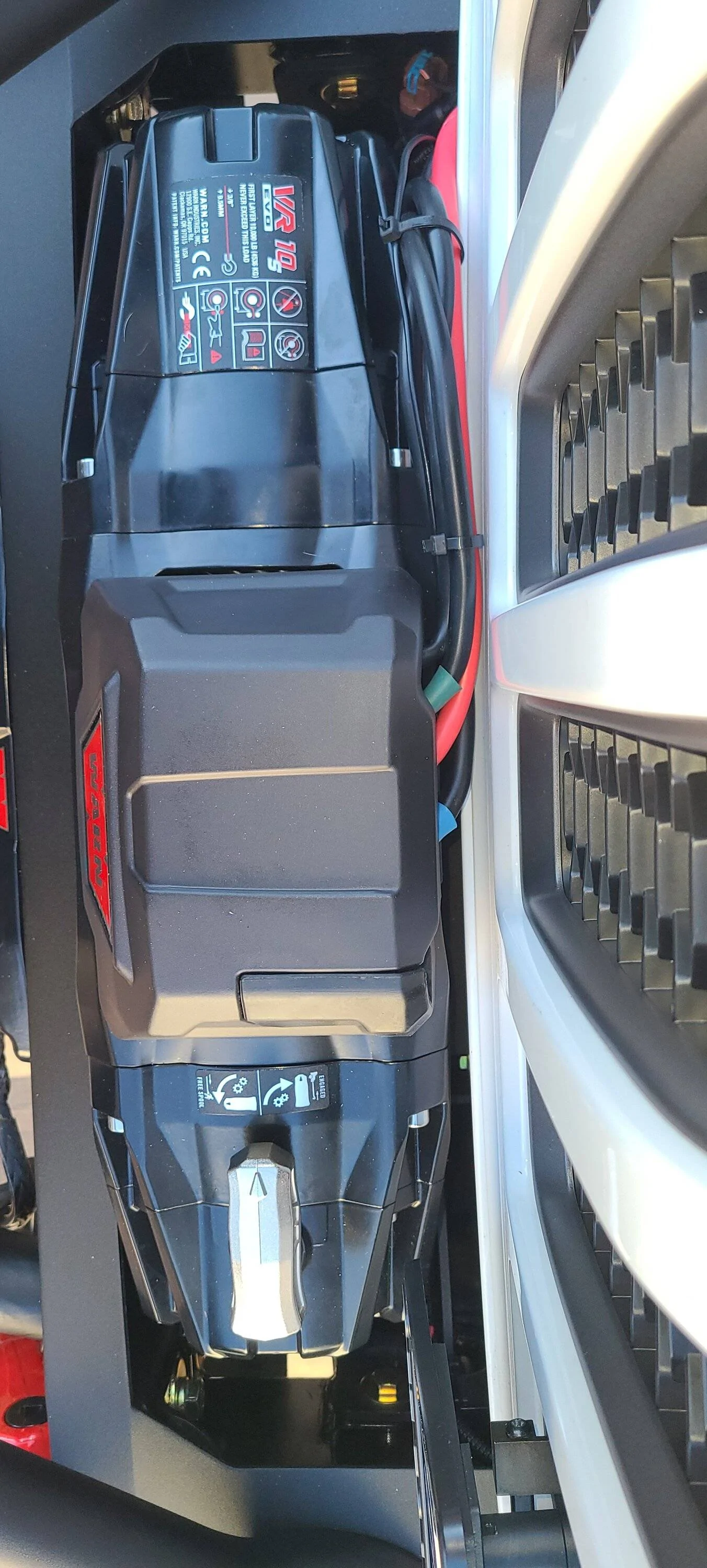

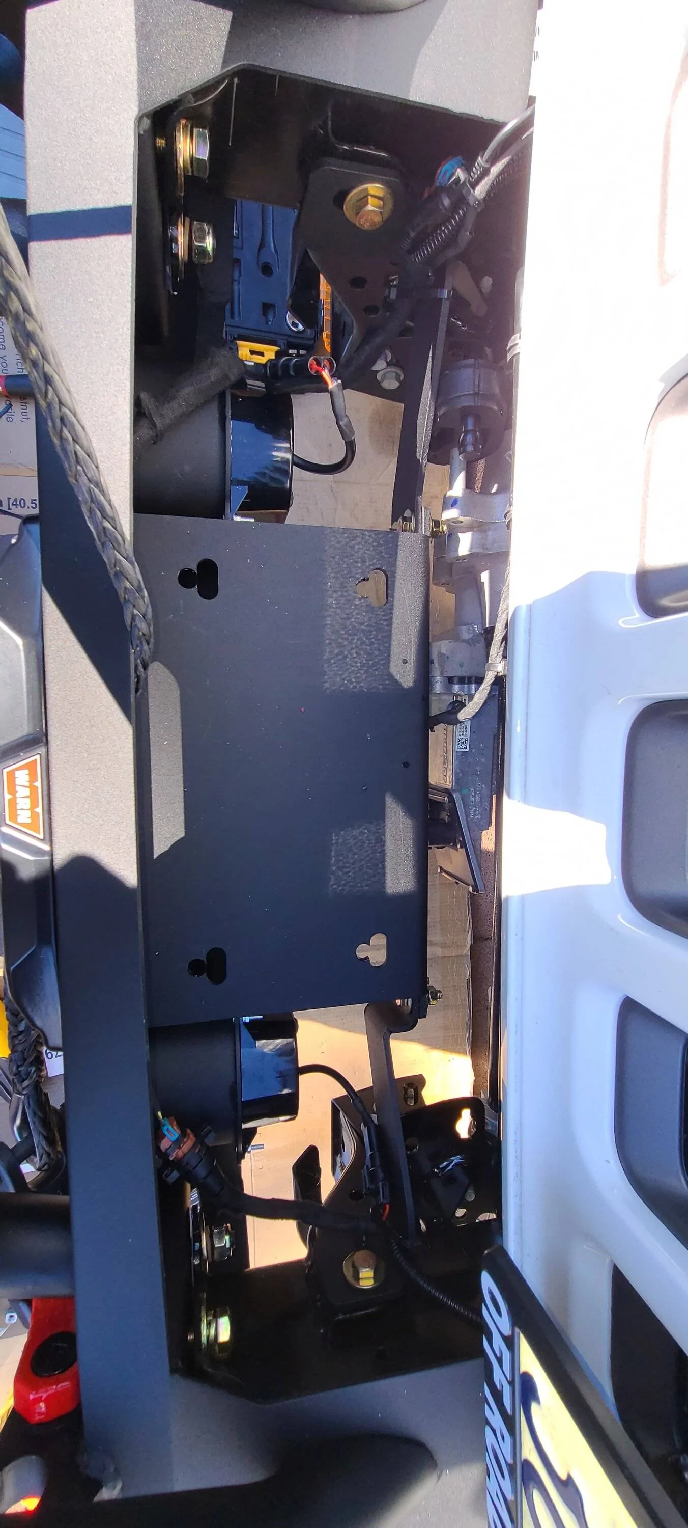

I've had the HD full length for the last year and I've been running 35s with it. The only issue that I need to tell people about is that the winch will be too close to the grill. I ended up slotting the holes on the winch mounting plate to get my winch to fit. I haven't had any issues since but I just want to give you the heads up. I'm about to go with 37s here in a week so I actually just bought spacers to bring the bumper further out by 3/8 inch for tire clearance. So that's another option for you because that will probably give you more clearance for the winch itself also.Went with the rugged ridge hd full length… should be here this weekend. I like the looks and protection of a full size over the stubby.
