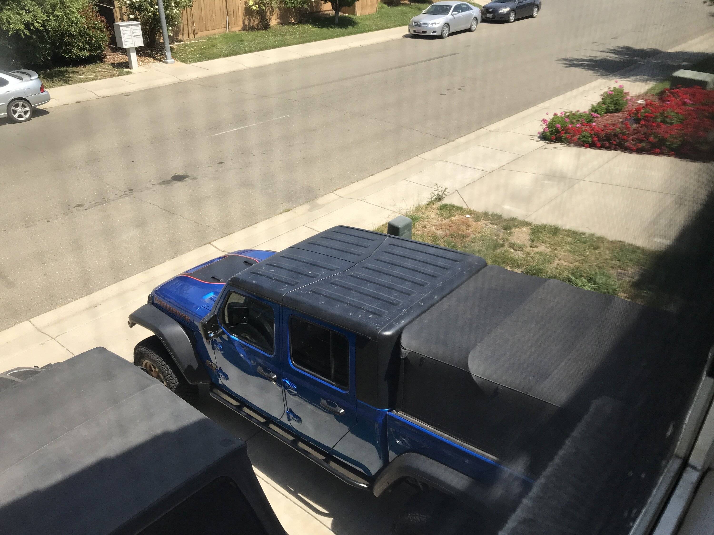

Where is your satellite antenna? I donā€™t have one on my truck. 22 Mojave. I do have satellite radio - I use the built in Sirius XM every time I drive.
Hereā€™s my roof. Excuse the crappy picture and dirty truck. Taken out my office window after a dusty week and a rainy afternoon, through a screen next to my neighbors dying lawn šŸ˜†

Oh, OK. Are you guys relocating your antenna because of the wireless signal being hampered by the camper? I thought it was a shark fin type antenna that was physically going to be interfering with the camper that hangs out over the cab.

Correct, the signal is blocked. In my case it would work only occasionally when driving due south.
