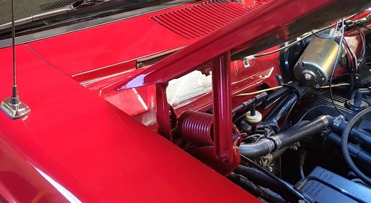

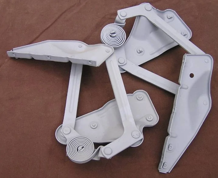

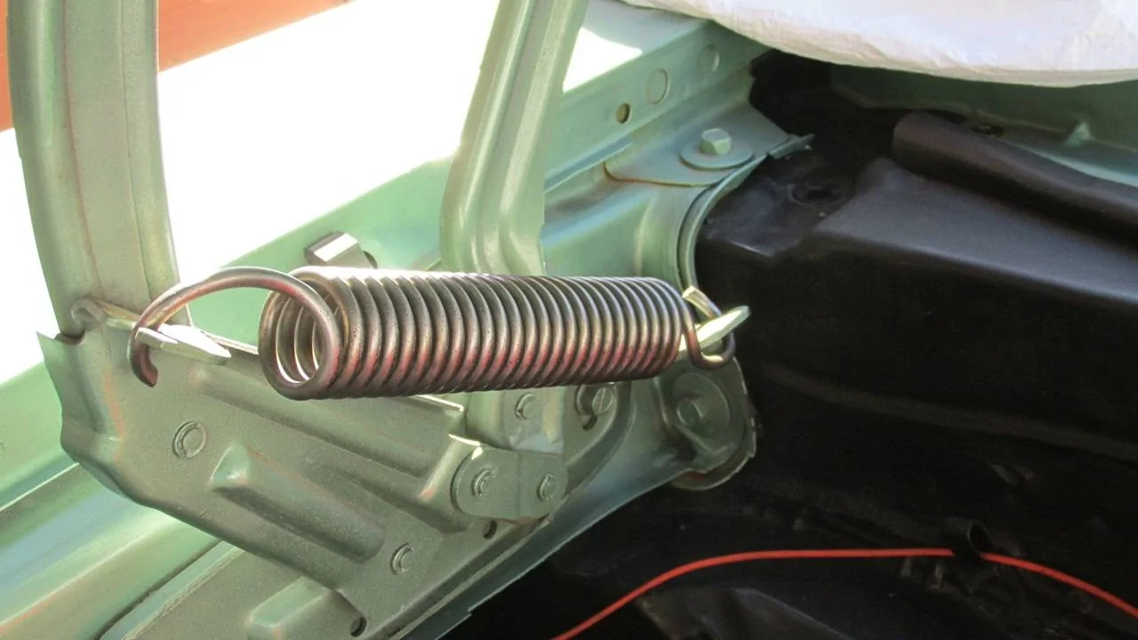

Back in the "old days," vehicle hoods were supported (when open) with hood hinge springs. Those springs put constant upward tension on the hoods when closed. If you had a fiberglass hood, the springs often bowed up (slightly) the hoods. Typical hood hinge springs photos below.
In the 80's GM vehicles like Camaros were notorious for bowed (upward) steel hoods because styling largely called for flat (less structurally rigid) hoods (they also had minimal hood underframe rigidity/support) so it wasn't uncommon (AKA was common) to have upward bowed hoods or even cracks in the hood skin just forward of the under-hood spring hinge mounting points.
We have a 1967 Shelby GT 350 with an OEM fiberglass hood, and a 1970 Mustang convertible with an aftermarket fiberglass hood that we do NOT use the hood hinge springs on any longer, to avoid bowing the hoods from spring tension when shut/in down down position. We just use a improvised prop rod to hold them up - when doing engine work/maintenance. Our 1974 CJ-5 HAS an OEM prop rod BTW, due to classic Jeep hood hinge design, just like current Jeeps.

It's likely (also) a hood latch adjustment issue. Try loosening the mounting bolts and move the hinges to tighten/remove the front hood gap. It's quite possible the struts are actually giving some uplift to the hood (or maybe not). We don't have any hood uplift issues on the wife's JTRX possibly due to heavier hood, that we also have a mask on (the leading edge of hood, causing addl weight) that minimizes flat towing rock chips.
If you're lamenting the demise of old-school hood hinge support springs (if you recall those), pls see next paragraphs for a caveat on that design approach - makes prop rods seem less bad. ;)

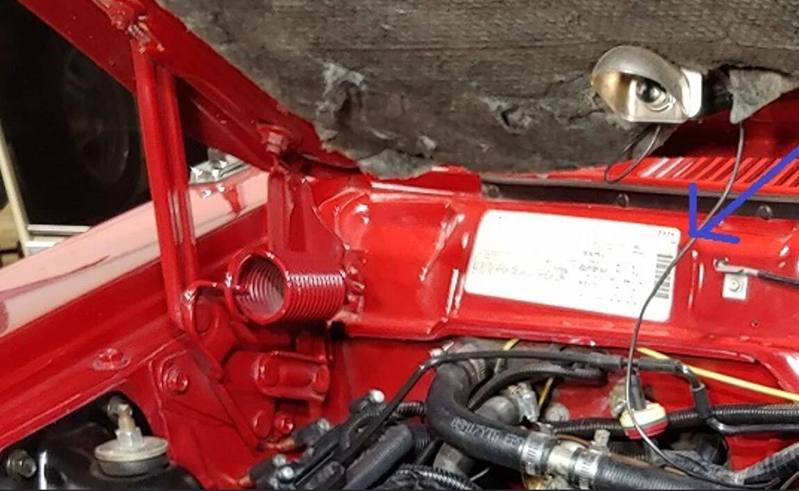

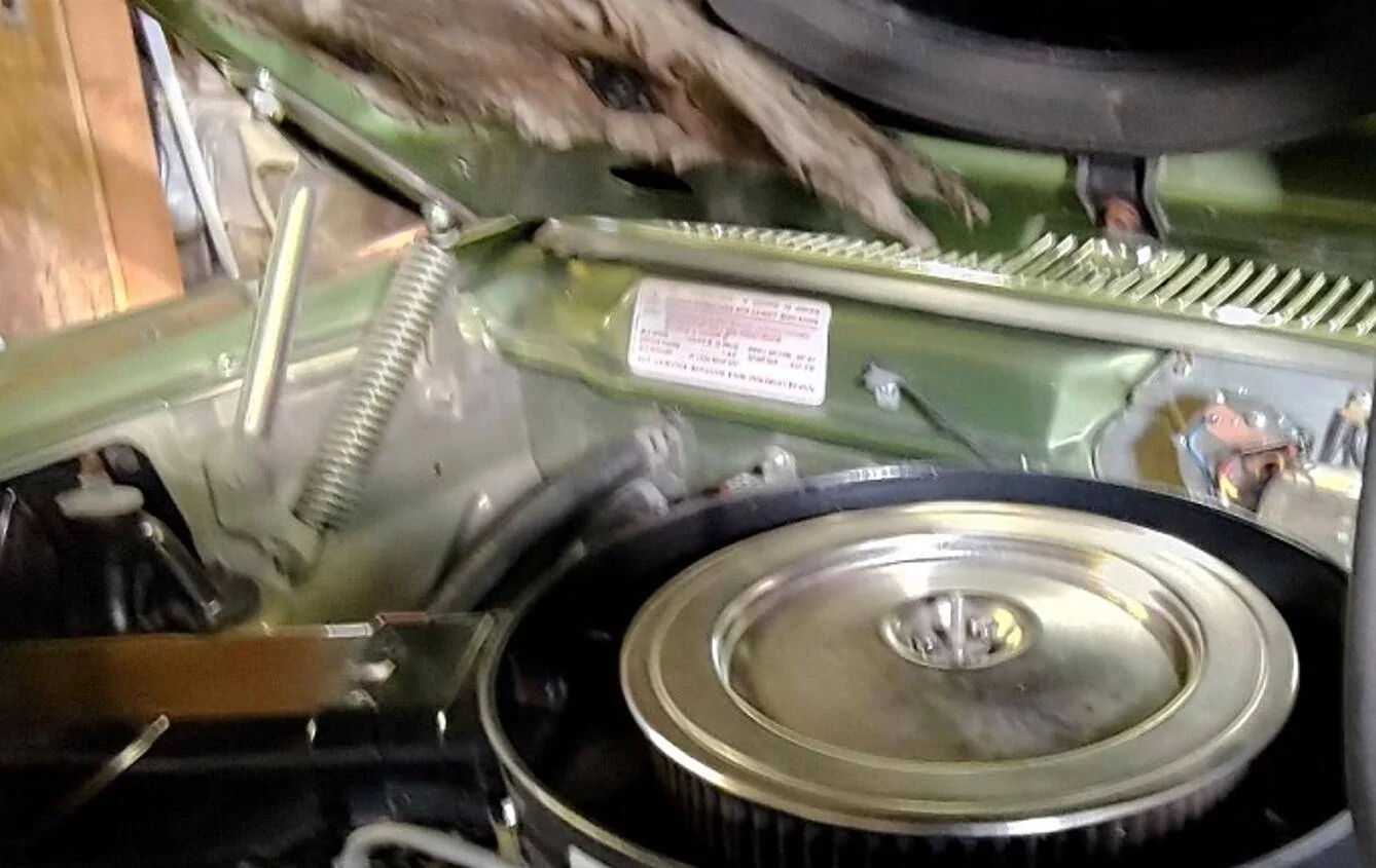

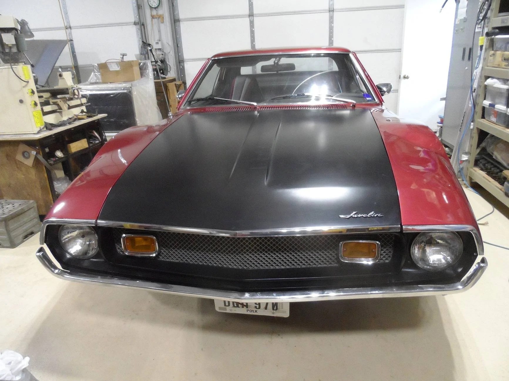

With my 73, the stress is on the rear of the hood. The front is fine. Same on my 70 - it laid perfectly fine, but you did have to ADJUST the heck out of the hinges to get rid of the bow. There's a trick to adjustment - off even a little, you have bow at the rear.
Also if the joints in the hinge become even a tiny bit loose or worn, you have troubles.
AMC ran some of the cheapest hood sheet metal out there - to save weight for economy, to save $$.
Jeep Gladiator Hood Struts - $40! 1746913266563-0k
Jeep Gladiator Hood Struts - $40! 1746913372155-lv
Jeep Gladiator Hood Struts - $40! 1746913481362-m9

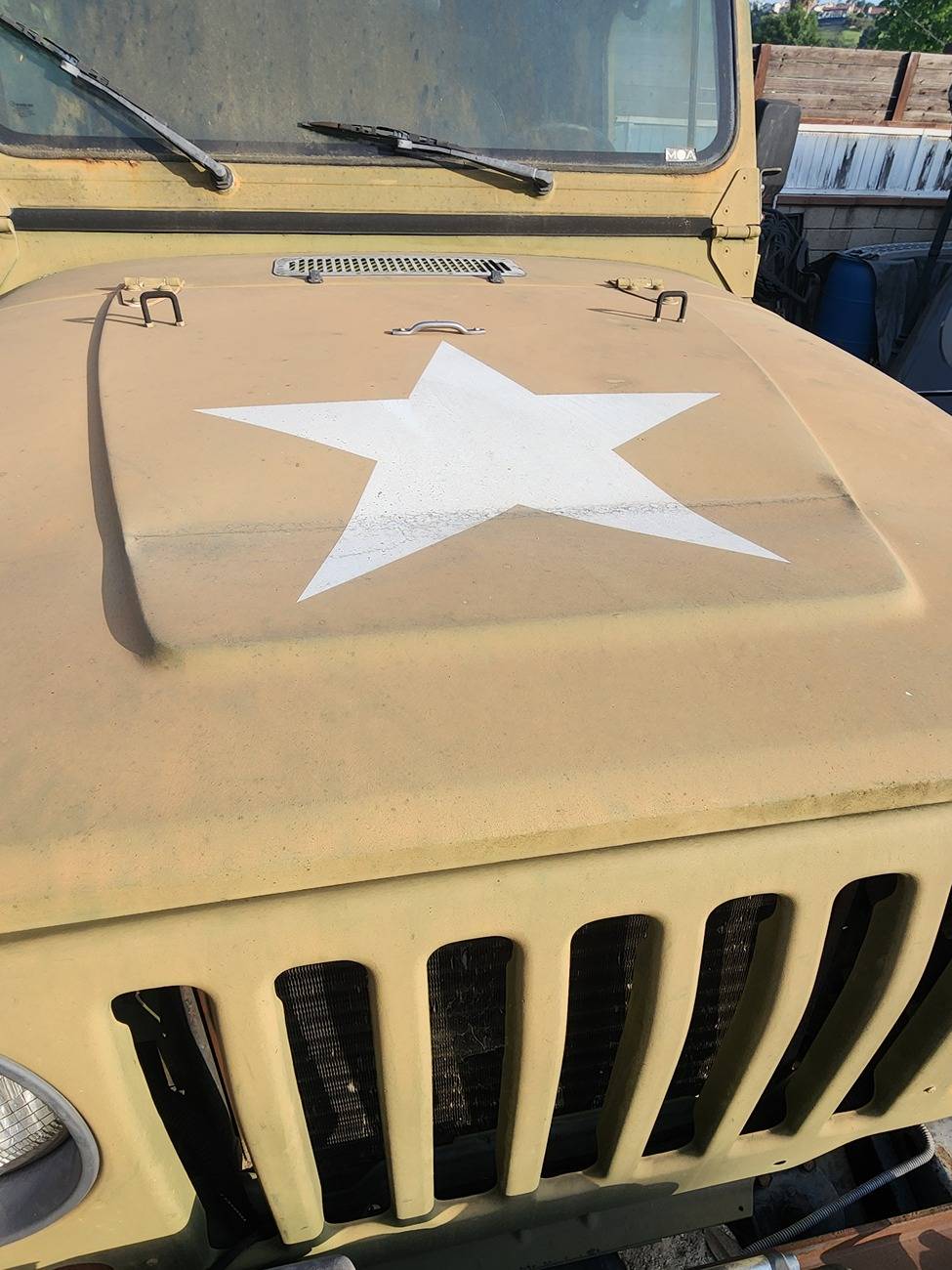

Flex in the hood is at the rear - it bows up just a bit. Worse with the hood that's cut for the taller air cleaners to stick up through. The hood is way too long for any stresses to get to the front end.
Jeep Gladiator Hood Struts - $40! 73-jav-cleaned 021
I note some of the knock-off strut setups use a different mounting point for the cylinders - likely changing the stress angles. Could be multiple reasons Redline Tuning doesn't have the problem with distortion. Takes some serious thinking and engineering to determine where the stresses will go based on the cylinders used, how and where they are mounted, hood FRAME and structure and so on.
