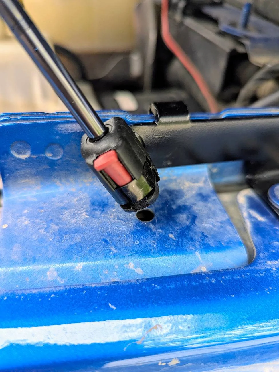

Yes, the Redline Tuning struts do have that quick (and easy) release, and it's handy when doing things like installing wiring harnesses and relays and control boxes for snow plows LOL
I'd certainly not want struts that didn't have that feature
These do.

Yeah, they copied every single aspect of the Redline Tuning struts. At least in the design.
I can see the fabrication methods of the brackets are somewhat different - But the design is the same.

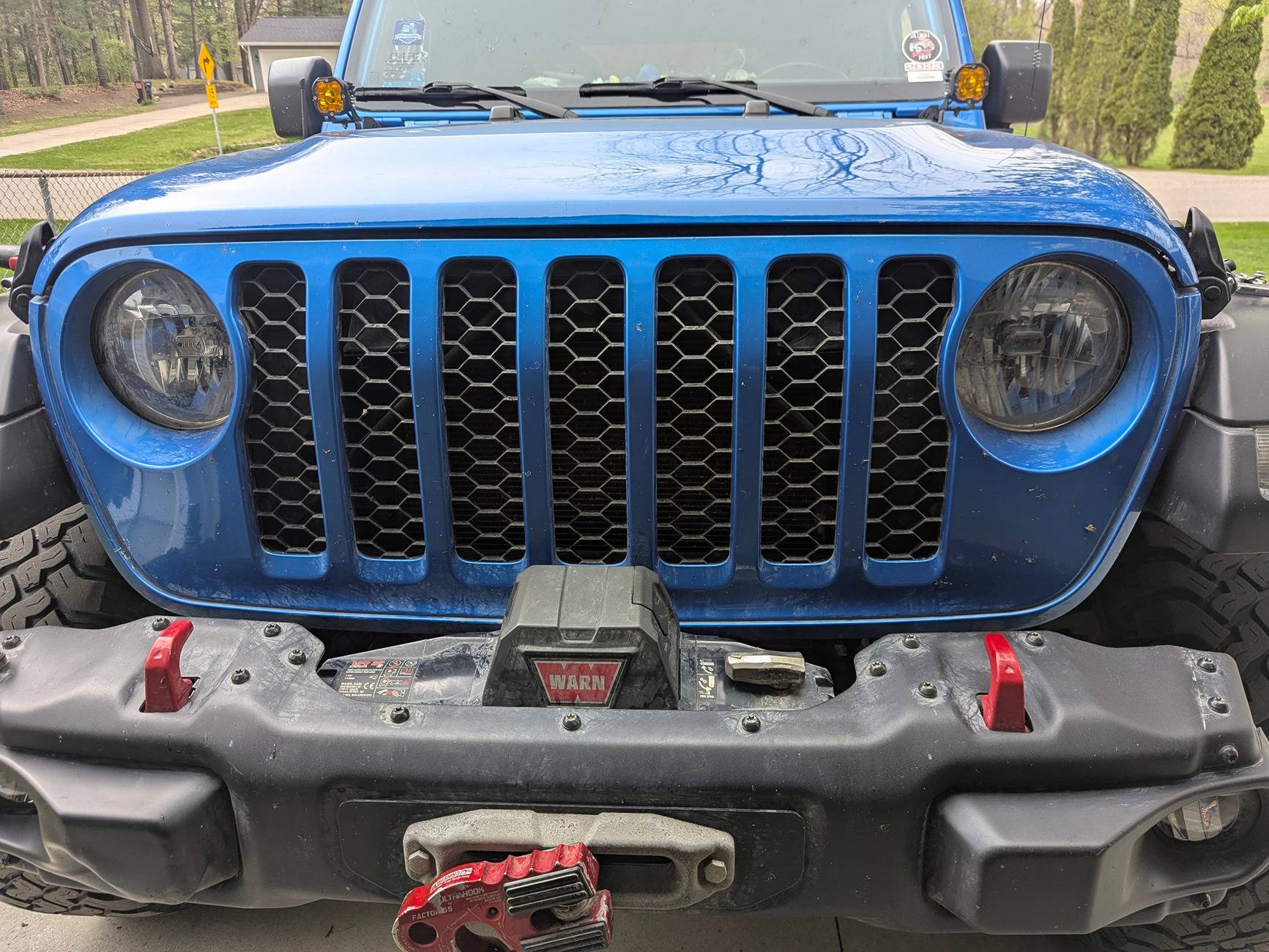

Sunday, before the strut install.
Jeep Gladiator Hood Struts - $40! PXL_20250430_210332368
After installing. I think the struts are too strong for the lighter hood.
I do not have that much play in my Mojave hood when it is latched. Once my struts come in I will take note if I see any deviation.
40,463
53,908
How will the struts, pushing up over half-way back on the sides of the hood, cause a gap up front?
it's the latches that control that. The struts don't push up on the middle.
One can tell if the struts are overkill by how FAST the hood opens.
Been through this on a lot of cars that use struts on the rear hatch or other areas.
Really hard to see something on the edges causing the front to be higher.
