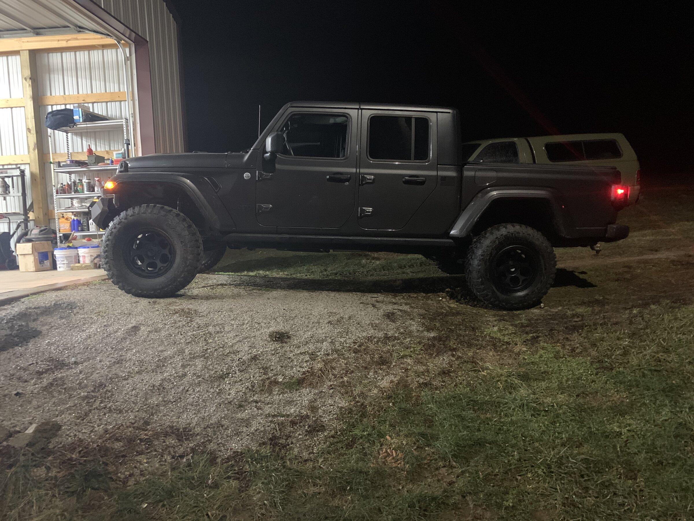

Being a child of the 70s, I think you're done ;) Just chrome up the rear diff and put wide slicks on the rear. :)
Jeep Gladiator Houston, we have a problem. 0E29B3A0-A10C-4D19-A9A9-64059F9CFA55
that was just the rear end, gave it a pulling truck vibe ? excuse the mess.

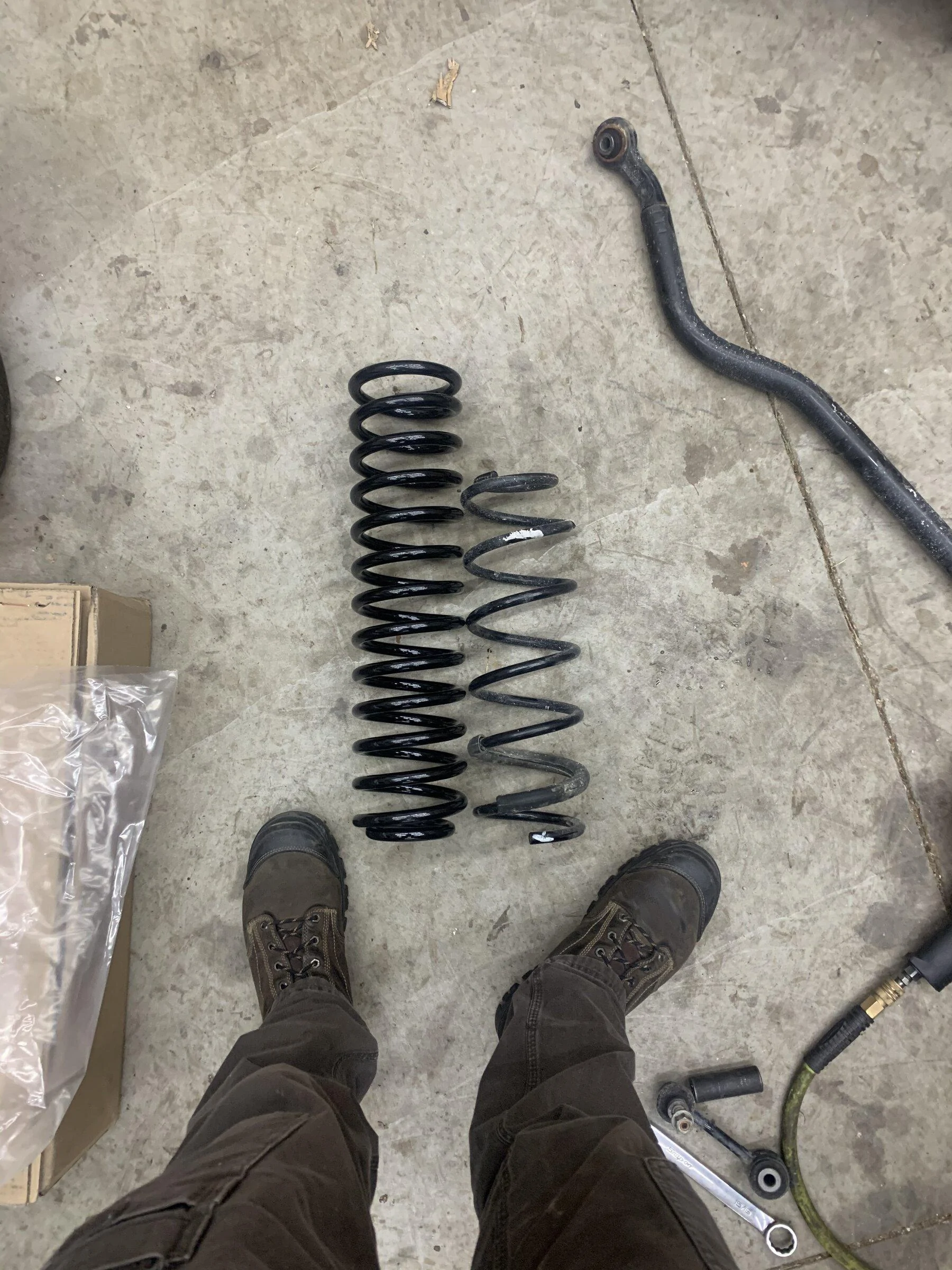

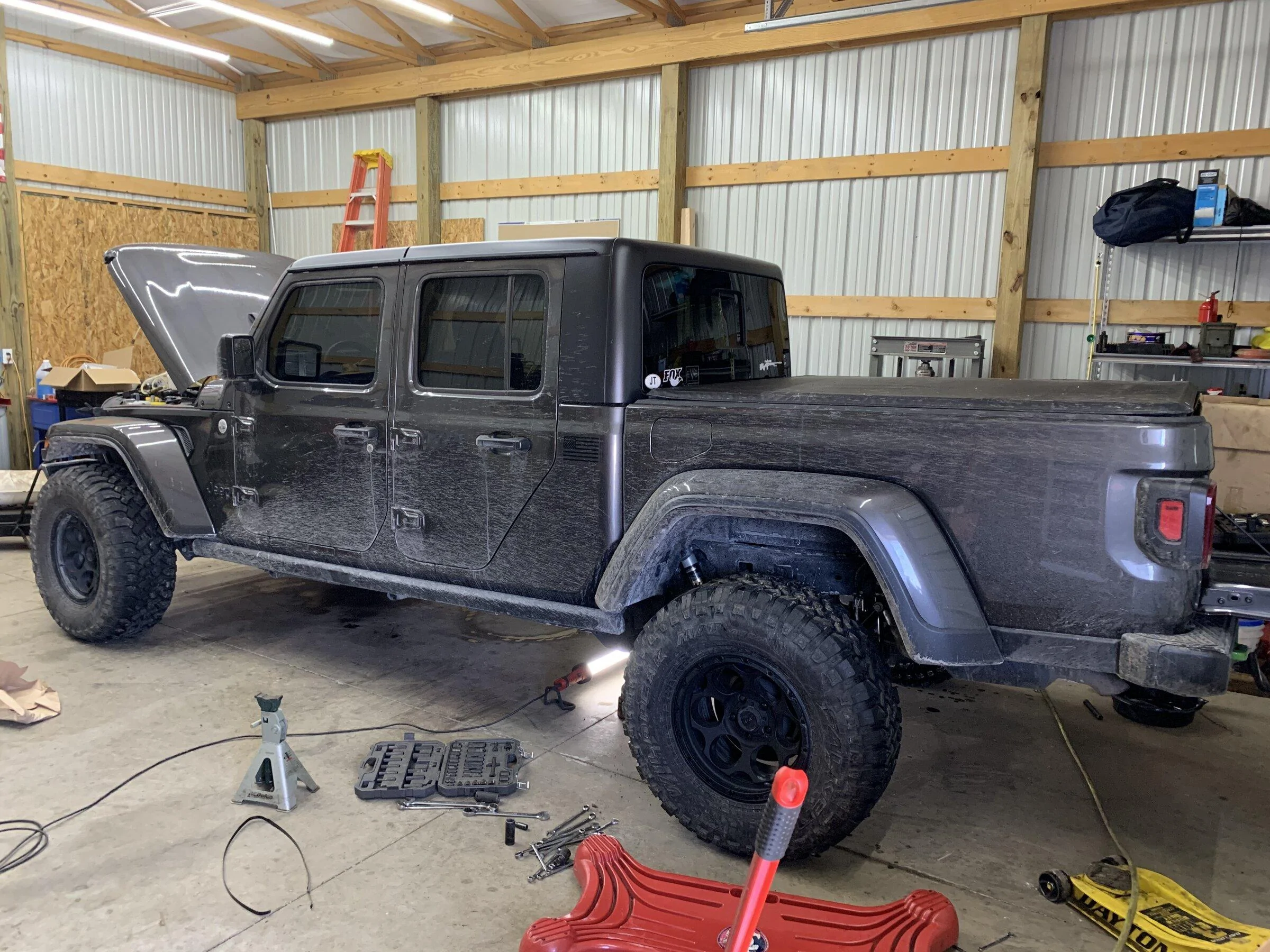

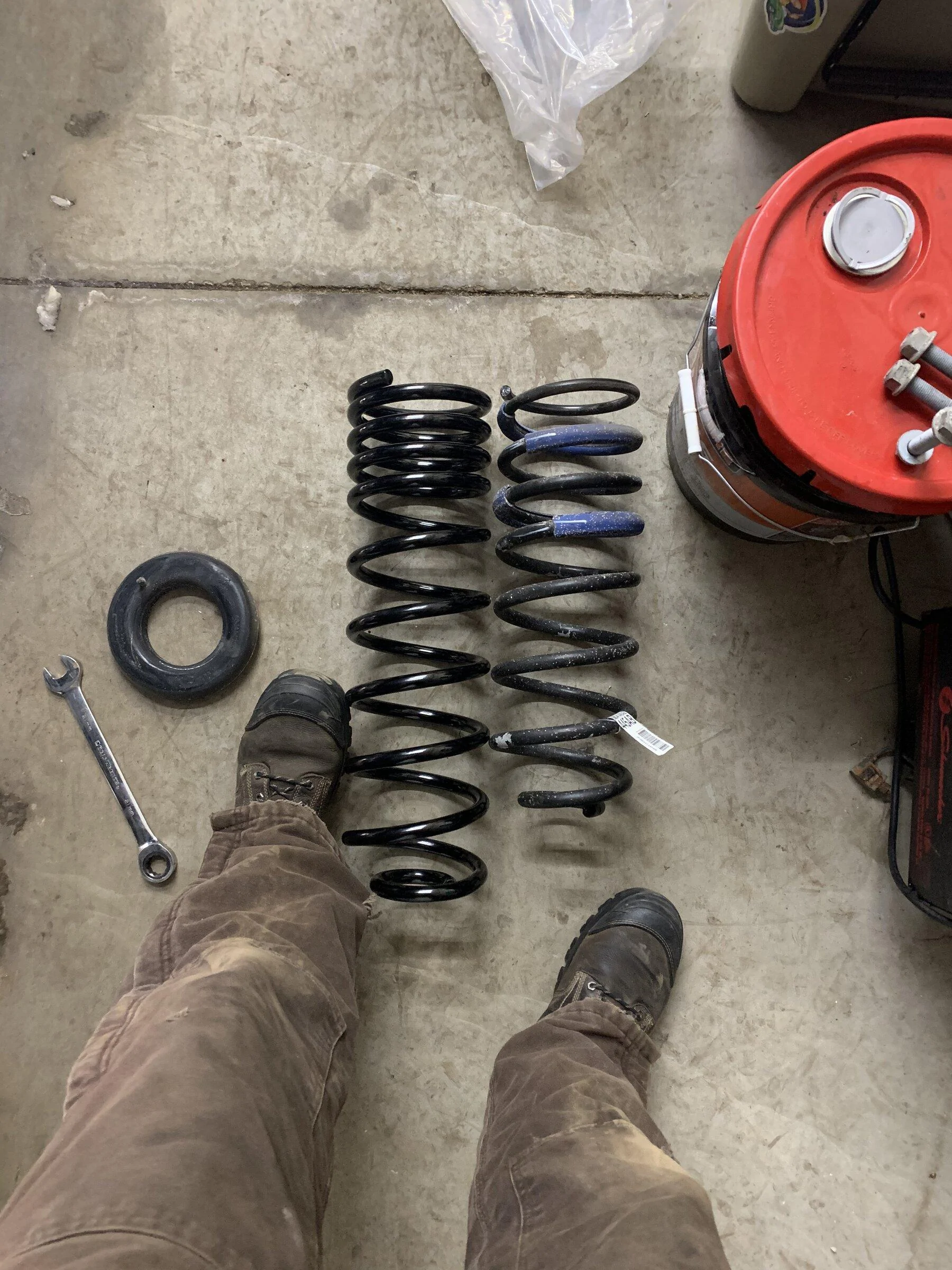

when I took mine apart the Max Tow springs had a slight tension on them when hanging, when I took the shocks out the axle came down far enough to just pop them out, the evo rear springs are a little longer in the rear than the max tow springs but the fox shocks are significantly longer than the stock rear shocks.
Jeep Gladiator Houston, we have a problem. 197FF208-931C-43A8-9CE0-9BB1EB1A68A7
When I installed the rears, with everything loose but connected they will fall out, I’m hoping the spring tension from the other components is enough to keep them in, if I were using free motion bearings/bushings on my joints I would need shorter shocks and possibly limiting straps just to keep them in. Since I’m running factory joints in the rear, if there is sufficient spring tension in the rubber bushings I might not have a problem. As far as I see it shocks on a vehicle without limiting straps are the limiting factor. “IF” the suspension components have no way of supporting the axle weight alone... my front springs are much longer and when installed with the shocks the spring will not fall out at all (shocks are too short to let them come out), I had to compress them to get them in...

Thanks so much for the spring comparison you posted! I have the front Fox 2.0s in that travel range for the front sitting in my garage. I wasn’t concerned about the front springs because they are 3.5” JKS springs, among the other things that keep a front spring from falling out.
However, in the rear, I have base sport springs and a 2” AEV spacer so I had concerns whether I could run the same travel shocks in the rear. It seems based off your pic, between the spacer and the sport springs being 1.5” longer than max tow springs, I may actually have a touch more free length than the EVO springs.
Who knows; it sounds good in my head but I could be completely off. Guess there’s one way to find out…

I hope it works well for you. I still need to get mine on a lift. I had trouble finding a whole lot of info on the EVO kit, I’ve seen some JT’s on here with this lift and I was struggling to choose between this and Clayton. Ultimately I chose the evo springs on assumption they were a little softer than Claytons, but I bought Clayton overland control arms up front. Clayton holds high regard on this forum and I like their stuff, if this doesn’t turn out like I was hoping Clayton will be my next spring.
