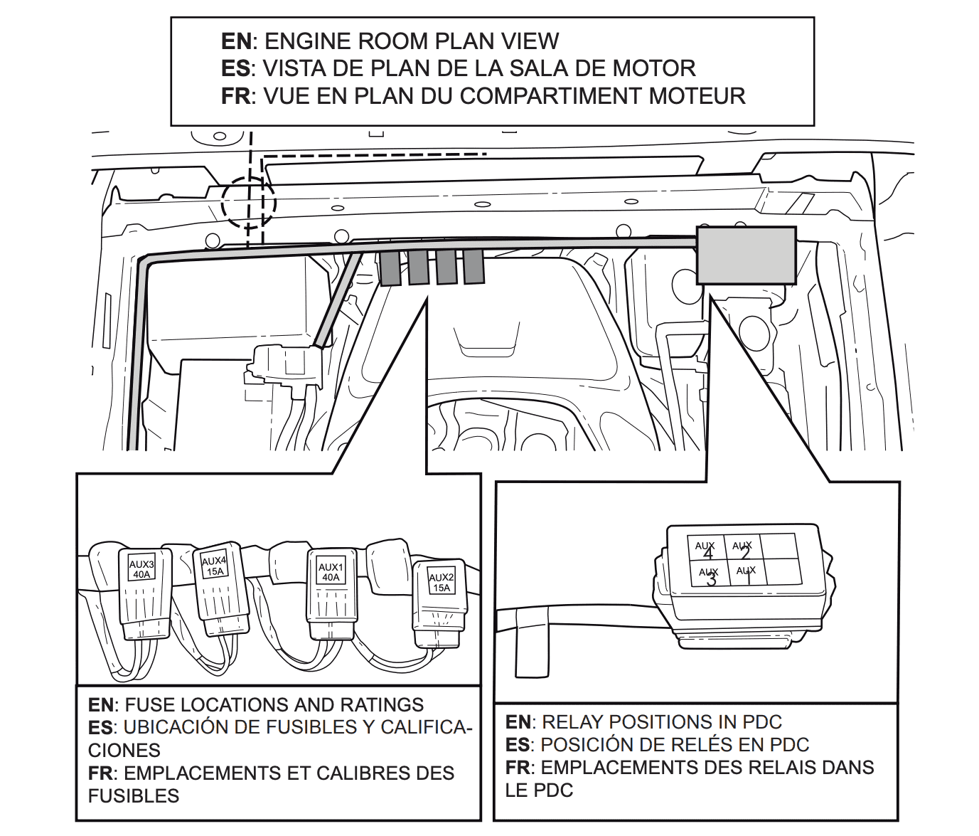

I ask because I just recently installed a MOPAR Aux switch bank. Two of the switches are 40amps the other two are 15.

FYI, these are at 6.8 A each. FYI #2, and probably more important, if you installed the aux switches (or the dealer did), Aux 1 and 3 are 40 A, while Aux 2 and 4 are 15 A. Careful on following the instructions, as they are for factory installed the Aux Switch.
Installed myself and wired my lights to Aux 2.

Awesome. I had no idea about the amps being diff, so I had to swap them.
