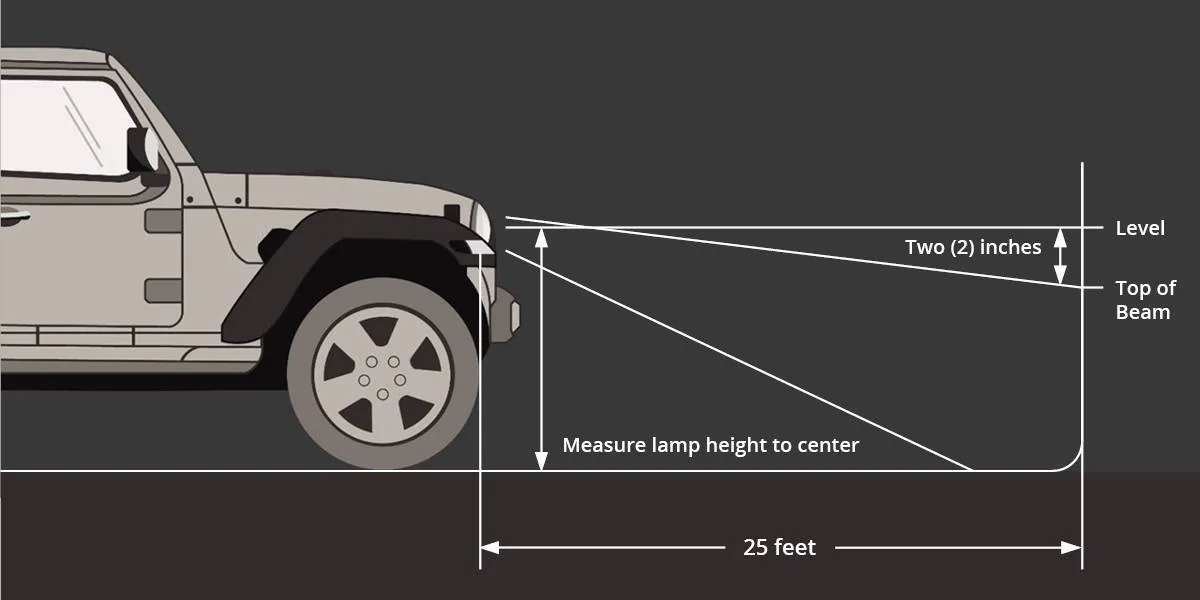

We've all been there - you’re driving down the road and get flashed because someone thinks your high beams are on. Or on the flip side, you feel like you don't have as much visibility as you should because your headlights are aimed too low.
Jeep Gladiator How To Aim Your Headlights | Diode Dynamics 7ueNECf
Jeep Gladiator How To Aim Your Headlights | Diode Dynamics cirx0Rr
Well, we are here to help! Our YouTube video will guide you through the process step-by-step, so you can achieve the most efficient beam pattern without blinding other drivers and maintain safety on the road!
Jeep Gladiator How To Aim Your Headlights | Diode Dynamics eYvBgV6
Follow the link to our YouTube Channel to watch the step-by-step video and get your headlights aimed properly today!
