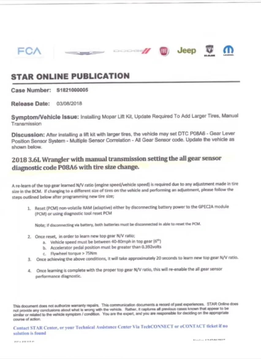

did you perform the 6th gear relearn procedure ?

lol! The what? Also my truck was in my driveway. Do you think that could have caused it? Nervous about trying the Tazer again… ehhhh.
if you use Tazer or JScan you’ll still need to do the relearn see image.
If you don’t it can cause issues not sure if it will set the service transmission light but will cause problems. So this may or may not be what caused your current problem.

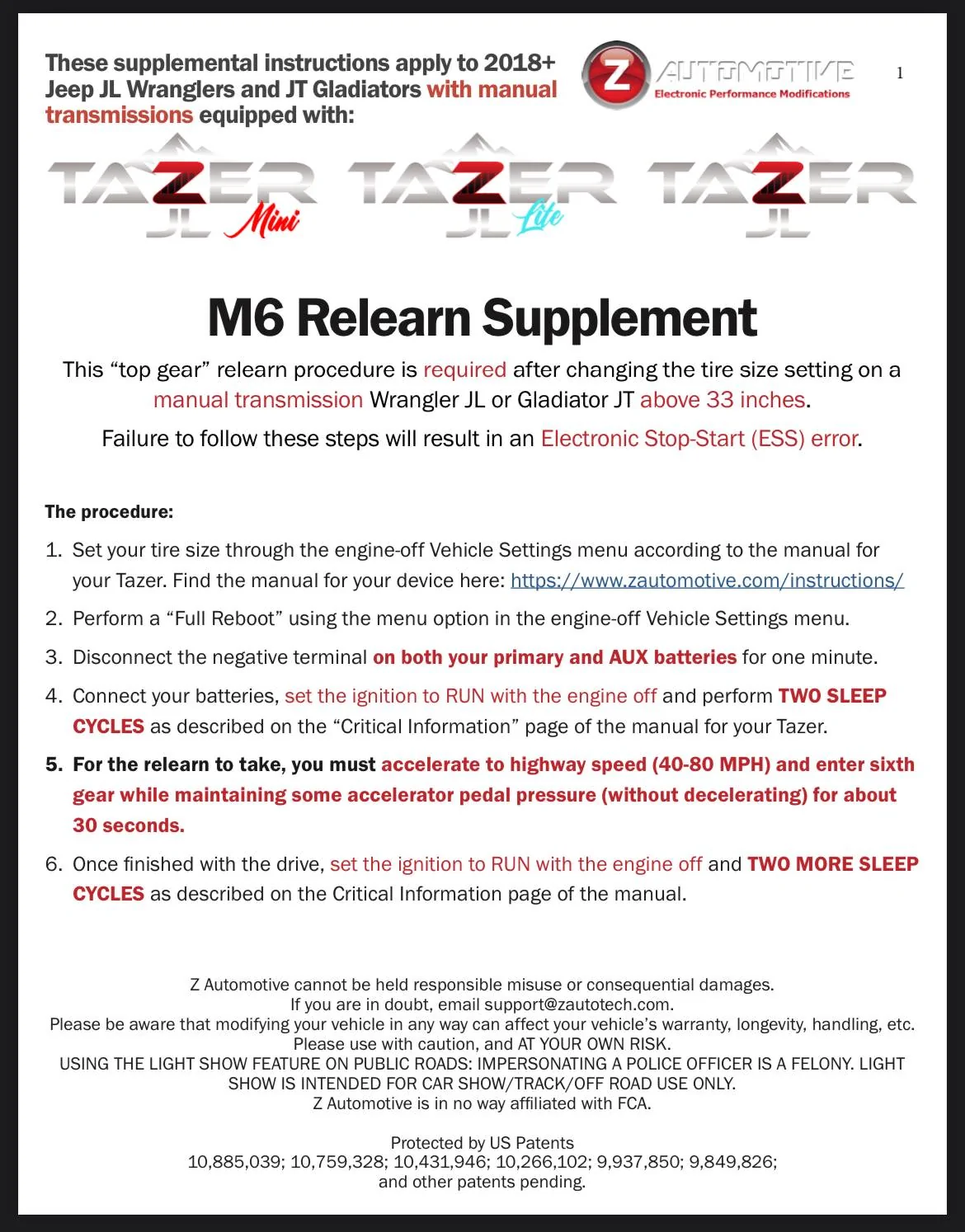

I tried searching around, could not find anything for relearn process for JScan specifically for manuals. Appreciate if someone can point me in the right direction. TY!
Jeep Gladiator How to reset service transmission light 1715631101688-fd
It says 2018 wrangler but is the same process and mirrors tazer directions.
Disconnect the negative terminals for 1min
Drive it and meet the conditions
After I’d clear codes if any but I haven’t had any from this.

Awesome! Thank you!
Gonna go J Scan route when I get my truck back from dealership. Will follow, step by step this time!!! lol! Appreciate the assistance!
