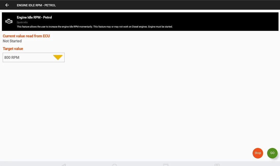

Anyone know how to increase the idle speed? I drive a manual JT and I think this would be beneficial when off-road to help keep from having to work the clutch as much on more technical terrain. Can you do this with a tazer or something similar? Thanks!

JSCAN will do it. Put your phone in a mount on the dash, fire up jscan, choose your idle speed.
I use it to control idle - set it up higher - when using the winch.
This is a shot from my tablet, but gives the idea.

Awesome! I’ll look into it. Thanks!
