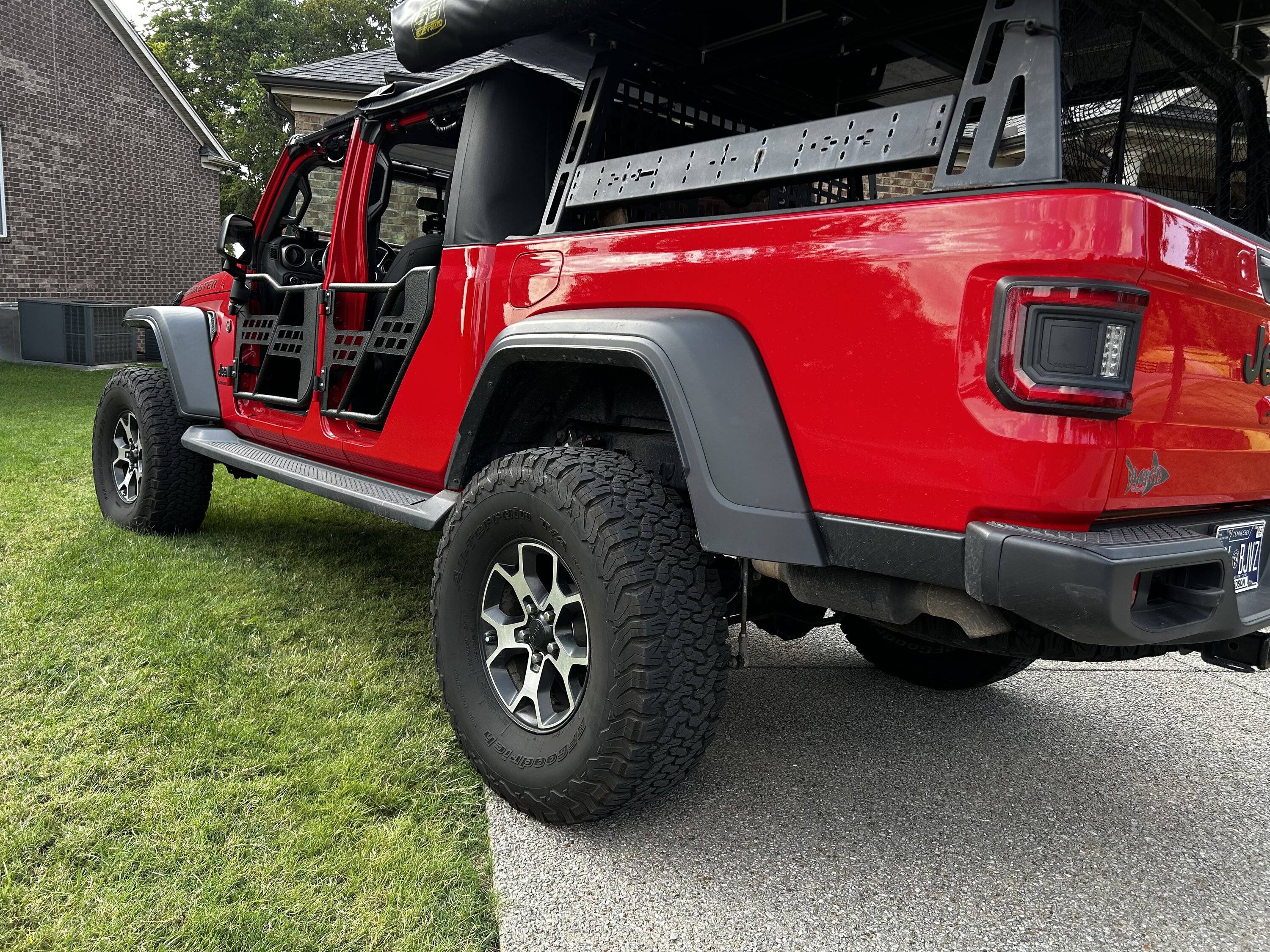

My set-up
- Clayton 3.5” Overland lift with Tereflex 3 Falcon reservoir adjustable shocks. Fantastic, but took me several months to dial in for Overland heavy and winter light daily driver modes. The ride is soooooo good! No rear sag under overland load.
. I have BFG AT KO2s “D” load range with over 65,000 miles of off-road and on road driving on them with just less than 1/2 tread.
. I sacrificed a little ride comfort with D load rating vs C for longer wear, but Tereflex Falcon shocks take care of that. PSI daily is 30-32.
. still quiet and better gas mileage than MTs
. I have a winch so if needed I can self recover.
. Currently will wait for new BFG AT KO2s to be available. Will buy in. 37’s again until phase 5 for the Jeep and that swaps all drive-trane. Then will go with biggest AT BFG makes.
- Tazer computer controller.

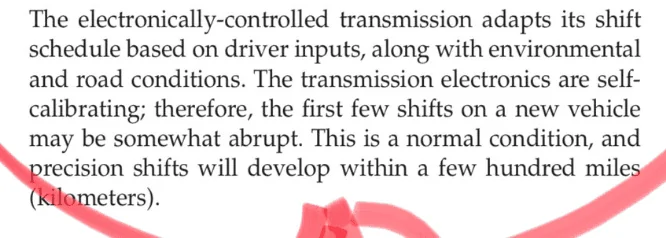

Tazer isn't doing anything for the transmission.
You can shift manually if you feel the transmission shifting is causing concern or problems.
There's no added power or zip from tazer. It can't help performance or make getting up hill better with the 3.6
Once tire size is correctly set (or when you change it) the transmission relearns. You may have to use tazer or jscan or whatever to force the TCM into relearning, but if you dig around the Wrangler areas they've talked of this for a while.
Jeep Gladiator Pentastar power increase 1703999532537
I noticed this when our JLU got a new transmission - man, some of the shifts felt harsh for the ZF 8 speed auto, but it's smooth and good as ever now that it's learned.

My set-up
I have plenty of mods but for what you are asking this is basics for an answer.
My answer for power;
- because of my relatively mild set-up though heavy at overland set-up with hard shell James Baroud XXL massive RTT, rack etc, weight at 1600 lb max load for Max Tow.
With the mini Tazer set for 36.3” tires and reset automatic transmission shift points, I can run up to 100+ mph , but who needs that with a JT (my GT 6 speed manual coyote Mustang will do over 150mph… again I don’t need that either, but it does it well and serves that need).
I can avg up hill and outwest mountains over speed limits to 80+ mph without a struggle.
For daily driving I can set cruise at 80-85mph and the JT gets it done. Passing at 90+ mph is fine. My avg mpg is 14, pushing mountains out west gets down to 9mpg.
- there is plenty of power in the stock pentastar V-6 with the 8 speed ZF auto and 37’s with 3.5” lift without making the motor less reliable by adding superchargers or turbo, IMOP, and well 106,000 miles of hard driving proof. I am not easy on my truck.
P.S. the traction control and the anti-rollover work, I’ve found that out.
for all around off-roading and DD my set-up works so well I haven’t even needed to add lockers. Modern traction control works for me in everything from medium rock-crawling, to snow (drove last year in up to foot of ice, then snow on interstate for 8 hours in 2 wheel drive, tires at 29 psi. No problem! Yes the BFG is a very capable snow and ice tire!).
If you want speed and more power try Tazer first, but if you have a manual… well you are SOL and IMOP more power with the stick manual is failure prone probably more often than the motor.
full sized trucks just are too big. I was on a shelf road 2 summers ago camping in Utah. 1000ft drop 6”es to my right, and shear wall of dirt and rock with my left mirror pulled in and 2”s or scraping on my driver’s side. This was an accidental shelf road rocky ruttted climb at 2200 hours, night time pitch black, cloud covered. A full-size truck would be a complete no-go here. Another reason I love my JT.
Get a tazer with the auto run a max 3.5” Clayton Overland Lift with Falcon 3 reservoir adjustable shocks on 37 BFG AT KO2s and the truck is absolutely amazing and does everything well… including totaling idiot that run into the stock rear bumper with class IV hitch Max Tow comes with.
towing up to max tow capacity is also not a problem.
OR, go to America’s Most wanted and buy one of their turn key builds if you need a Gladiator Truck like that.
OR, buy a muscle or super car to compliment your JT.
