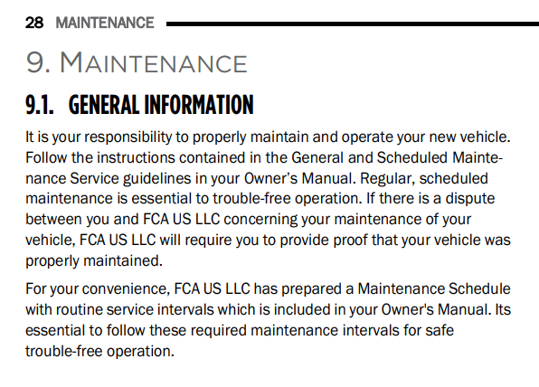

there's already a comment that 'it says explicitly in the manual you must save all your receipts'
Where does it say that? Not in the owners manual - they would never address such a thing in the owner manual. They recommend intervals but don't get into that type of thing in the manual.
The closest thing to saving receipts is in the MOPAR warranty, and I have read it cover to cover more than once, and this is all it says -
interesting on the owners manual, I'll ask for the reference but that was what the district manager said...maybe he's referencing what you posted? stay tuned
