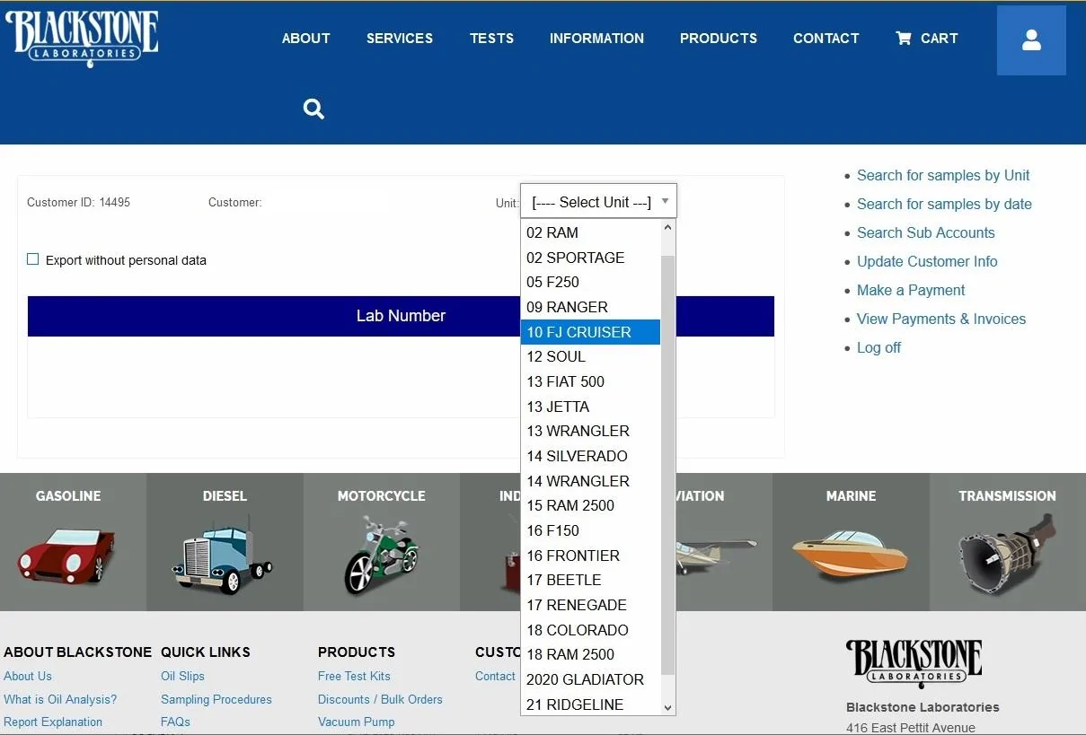

I get Blackstone Oil Analysis on most my oil changes. Including my Yamaha jet boat with twin 1.8L HO motors. Peace of mind if nothing and can detect early troubles otherwise. Never had any of my vehicles show coolant in the analysis.
