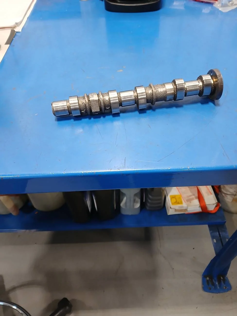

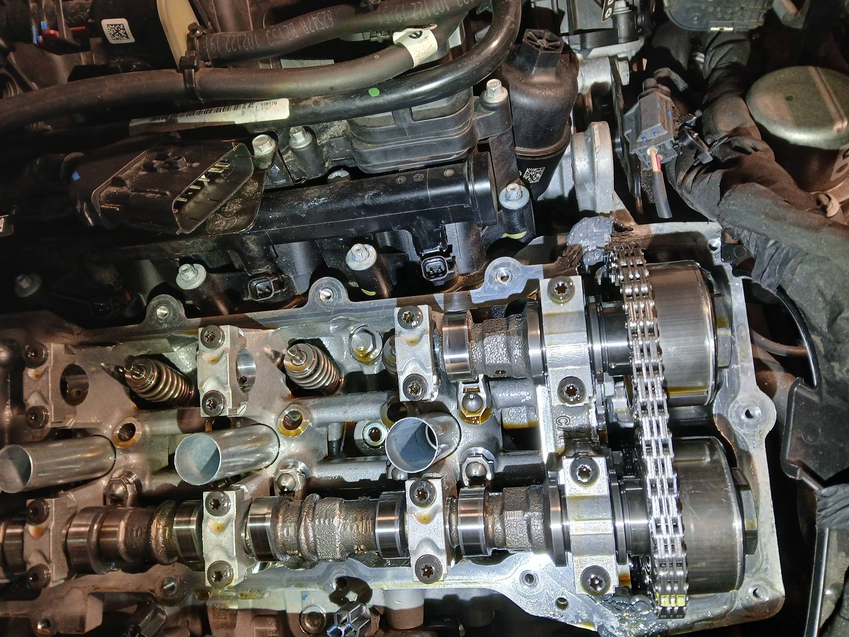

Intake cam from a Classic Pentastar in a Jeep Grand Cherokee. I have long considered inconsistent quality control to be a factor in the rare 3.6 Pentastar failures, both the Classic Pentastar and the PUG.
Holy Crapola , I would never have ever imagined that one would snap 😳 they dont accelerate that fast
40,514
54,041
Crankshafts snap due to twisting under load, acceleration forces and such, cams have impact loads on them.
