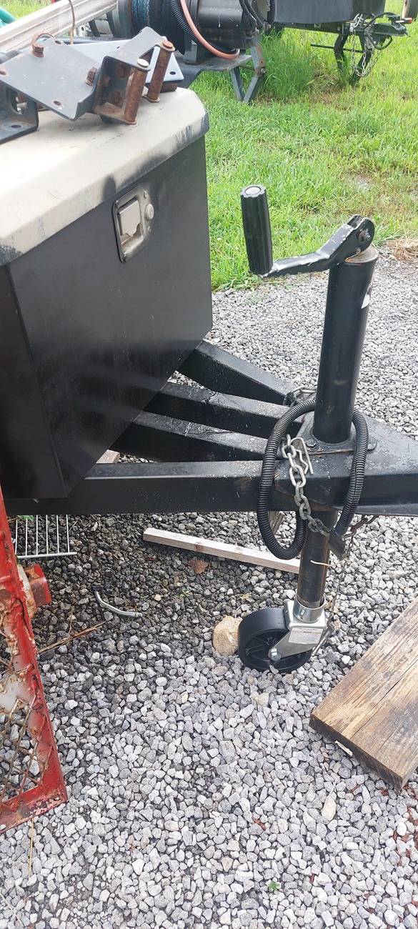

After reading though this thread... I guess I'm driving around with a 3.6 ready to hand grenade it's self. 101406 miles spent more than half of the miles towing trailers up to 5k, running slightly larger than stock tires, in hot weather, up & down hills, down shifting to 3-4 gears and rpms in 5k range oftenly plus with topper and probably 1000-1400 lbs of s### loaded most of the time. My one utility trailer is made by a company that their main business is building then to haul commercial mowing equipment and like equipment, so over built with either 1 or 2 3500 and 5k axles. Mine was built with additional reinforcements and single axle but narrow enough not to fit anything ridiculously heavy "aka" a car, truck or farm tractor. To identify the over built (read heavy) a picture of the hitch end.
Jeep Gladiator 3.6 pentastar 2020 major problems - Is the newer engine better in 2025 etc. 17499321953762044064903760041660
Now, some other perspective, I don't try to drive it like a sports car racing from traffic light to light or stop signs. I change oil & filter before the maintenance is at 10%, I don't try to run the fuel down to E. before filling up.

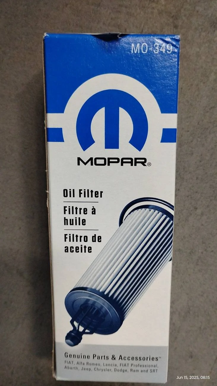

What I use is Valvoline 0/20 synthetic oil and Mopar oil filters. I order or buy a few at a time and normally keep a few on hand along with enough oil to do a complete oil change.
