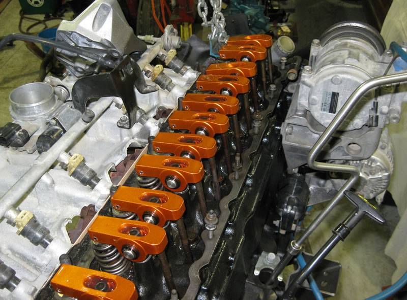

You can't prime a 3.6 in this way by spinning the pump, but you can still pressurize the system and watch for oil to be where it's supposed to be. Below, the blue line goes to my oil pressure gauge while i spin the oil pump. Got oil running over all of the rockers, through every push rod. I built up 50 psi spinning the oil pump by hand.

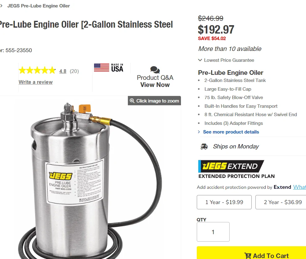

Something similar to this. Might have to make some adapter for the 3.6, but if you can access the oil galleries in any way, this can help.
