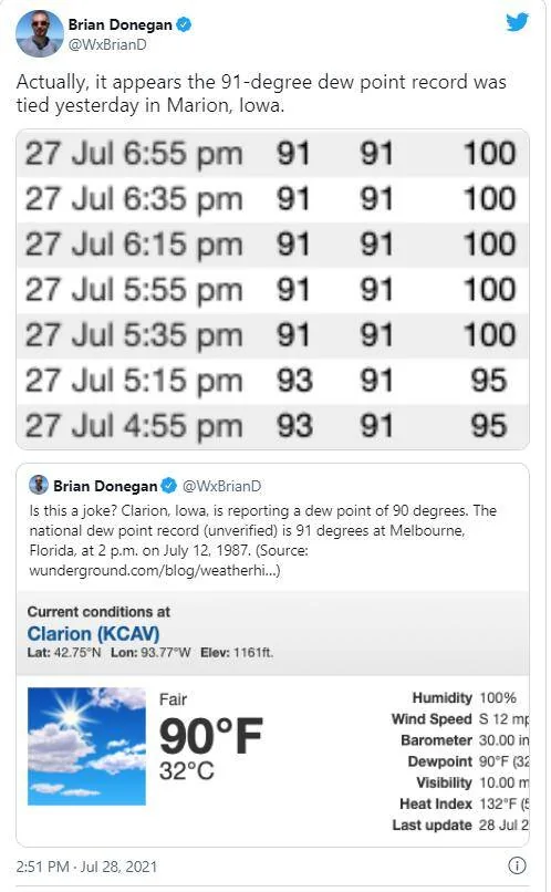

Yeah, the 'hot August nights" is a thing here for sure - not as bad as Florida, but humidity? Yeah........... July and August get right up there, so bad that when you kill weeds, they don't dry up, they rot and get mushy and stay that way for weeks. The ground smells from the mold.
