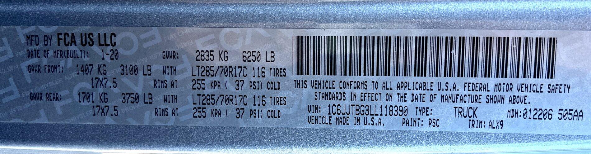

Here's my build info. I didn't actually get a pushed notice from anyone. I tried putting the truck on Turo to rent it out, since I was never using it. They told me I couldn't list it because it had an open recall. That's when I decided to just sell it.
Jeep Gladiator Pentastar V6 idle 1638202875511

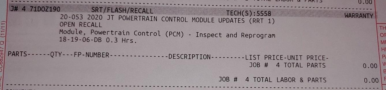

Hi all, I just wanted to share what I'm currently experiencing related to this. I bought my 2021 JTHA on December 18, 2020. I took it in for an oil change on January 8, 2022 with 2,000 miles on the odometer. Dealer tech said there's "recall" on my truck regarding the rough running engine. Since they don't have time to do the recall, they told me to reschedule. The tech said that it is okay to drive the truck. I dropped off the truck on January 29th and got a call at 2pm from the tech saying that it will take another day to finish it. I got a call this morning (1/31) at 10am saying that the truck is not yet fixed because it needed three parts and they only have two out of the three so they told me that I can pick up the truck and go back three days when the part has arrived. Since I have a spare car, I told them that I'll just pick it up when it is done. The work order says "RRT 1 (RRT 21-086 2021 JLJT 3.6 Cel and Rough Running Engine **). I'm a first Jeep owner and love the driving it. My oldest daughter, who is 7, always asks me to drive her to school in it. I hope this engine issue doesn't haunt me in the long run since I plan on keeping it for a very long time.
It's typical for a dealer to check for an open RRT, or Rapid Response Transmittal, when a vehicle comes in for service. It's not quite at the level of a recall but it's above a TSB. I am not familiar with the specific one you mention but there have been some rough idling issues with the 3.6 Pentastar. I personally had recall Y68 performed recently and it was just a software update to the PCM. It made a night and day difference - no more rough idling for me. Software and electronic gremlins aside, the 3.6 Pentastar is a very solid engine with a track record of reliability. I wouldn't worry too much about its longevity. Let the dealer take care of it under warranty.
I appreciate the response and agree to let the dealer take care of the issue. The JT is still at the dealer. I am hoping to call today. My daughter misses the "JeepJeep." Yeah, I miss the JT too. :)
October 2020 - took my truck in for WAVE service/tire rotation. They plugged in their OBD device, and the service writer looked on his tablet and said "it looks like your VIN comes up for a recall for PCM flash, should we do it"? I said yes - do it.
It was all automatic, they didn't look up anything, it popped up seconds after he pulled up my vehicle on his tablet after connecting his OBD interface.
That was October 2020 - possible this is the same one. I never did have any misfire or rough running, mine is always very smooth and I never get a MIL for anything, either before or after that date. I bought the truck November 2019 - it was built 11/05/2019. The RRT was done 10/2020
Jeep Gladiator Pentastar V6 idle my-pcm-dealer-update
