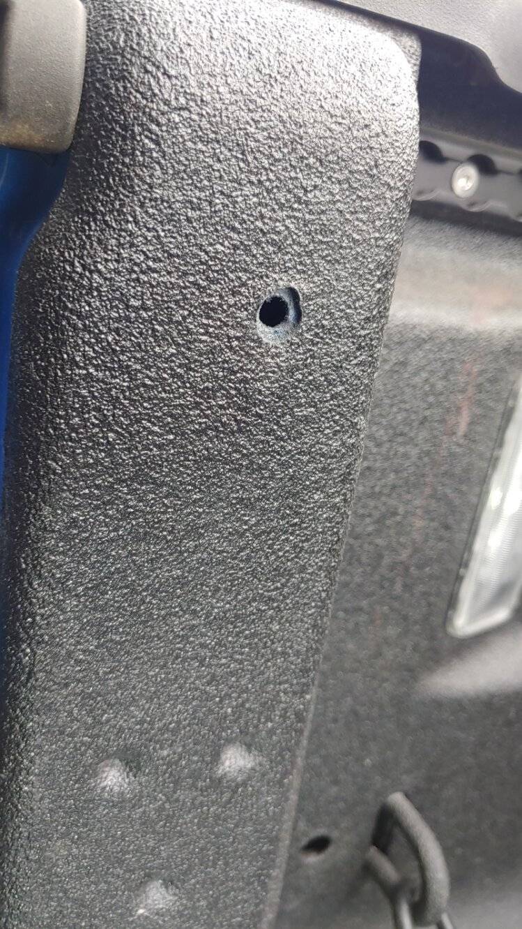

I ordered the factory bedliner. There's an easy trick to installing the rivnuts AFTER bedliner and if this was tiktok you could say I came up with a LIFE HACK!
Drill the hole, cut the bed liner out for the rivnut with a spade bit.
If it was me, I'd do before because I don't want the rivnut shoulder on top of the bed liner. I want it even with the bed liner so it's more flush and the shoulder doesn't hold out the item you are bolting in place. I've tried both and hate the rivnut on top of the bed liner.
But since I ordered mine with liner from the factory, I came up with this method of drilling the holes, cleaning the bed liner away for the shoulder of the rivnut, etc.
I did this for tonneau cover latches I made/installed and the bed rails I put in (not MOPAR)
This way anything I install is flat and not held out from the bed liner by the shoulder of the rivnut, they install flush, not sticking out, and if you use a company to put the liner in later, they protect any threaded holes with plugs so no worries there.

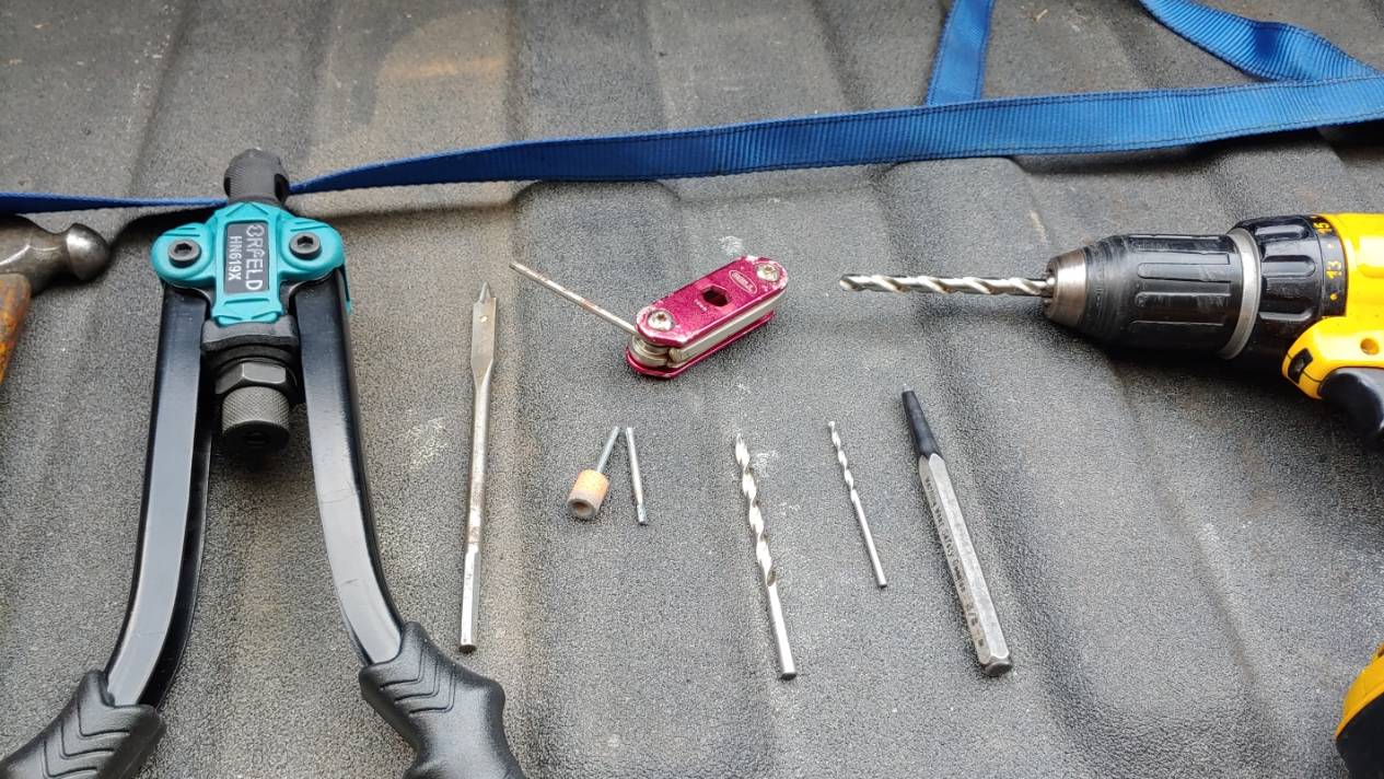

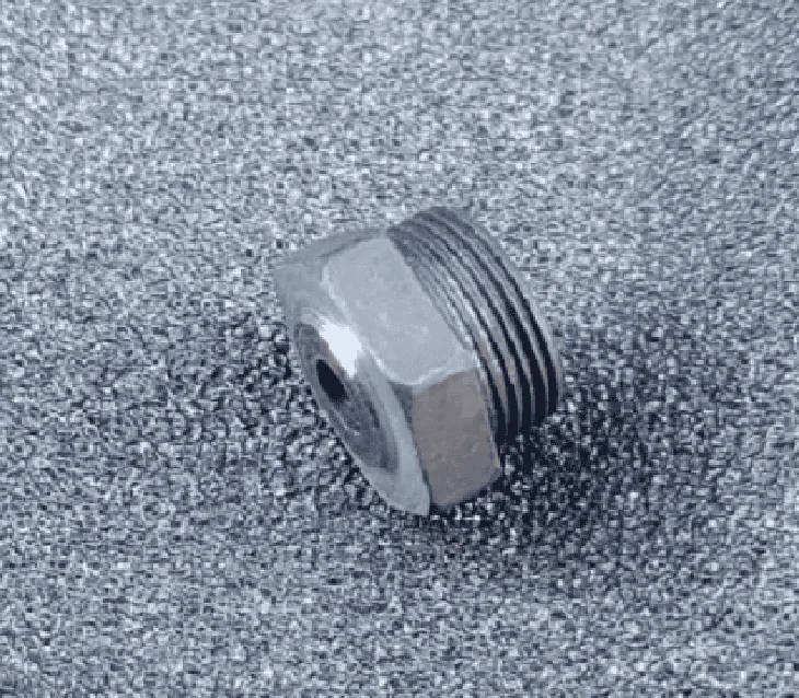

There is a trick to get the rivnut tool to work with thick bed liner and that was to cut the tool on my lathe to reach back into the recess.

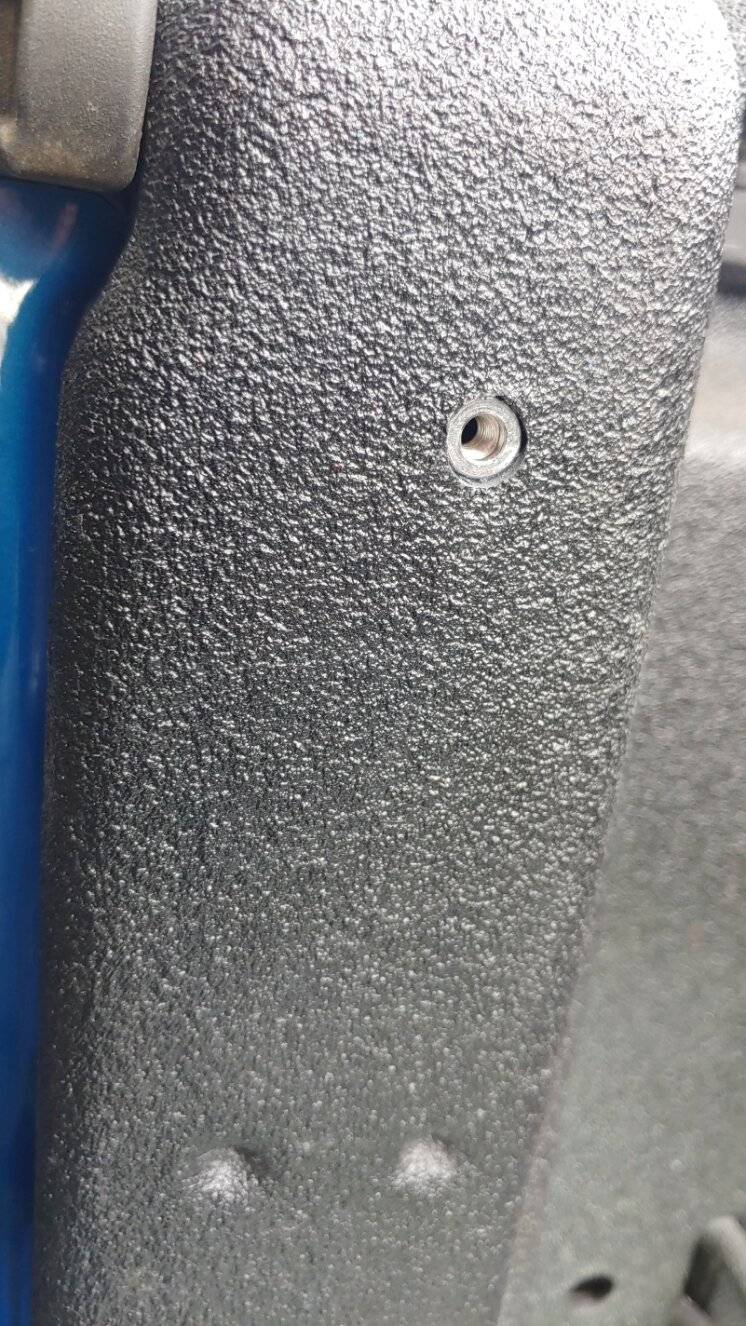

I used a small grinding bit in the drill to make the recess in the bed liner a bit larger - that's the grinding bit you see there, from my Dremel tool assortment.
