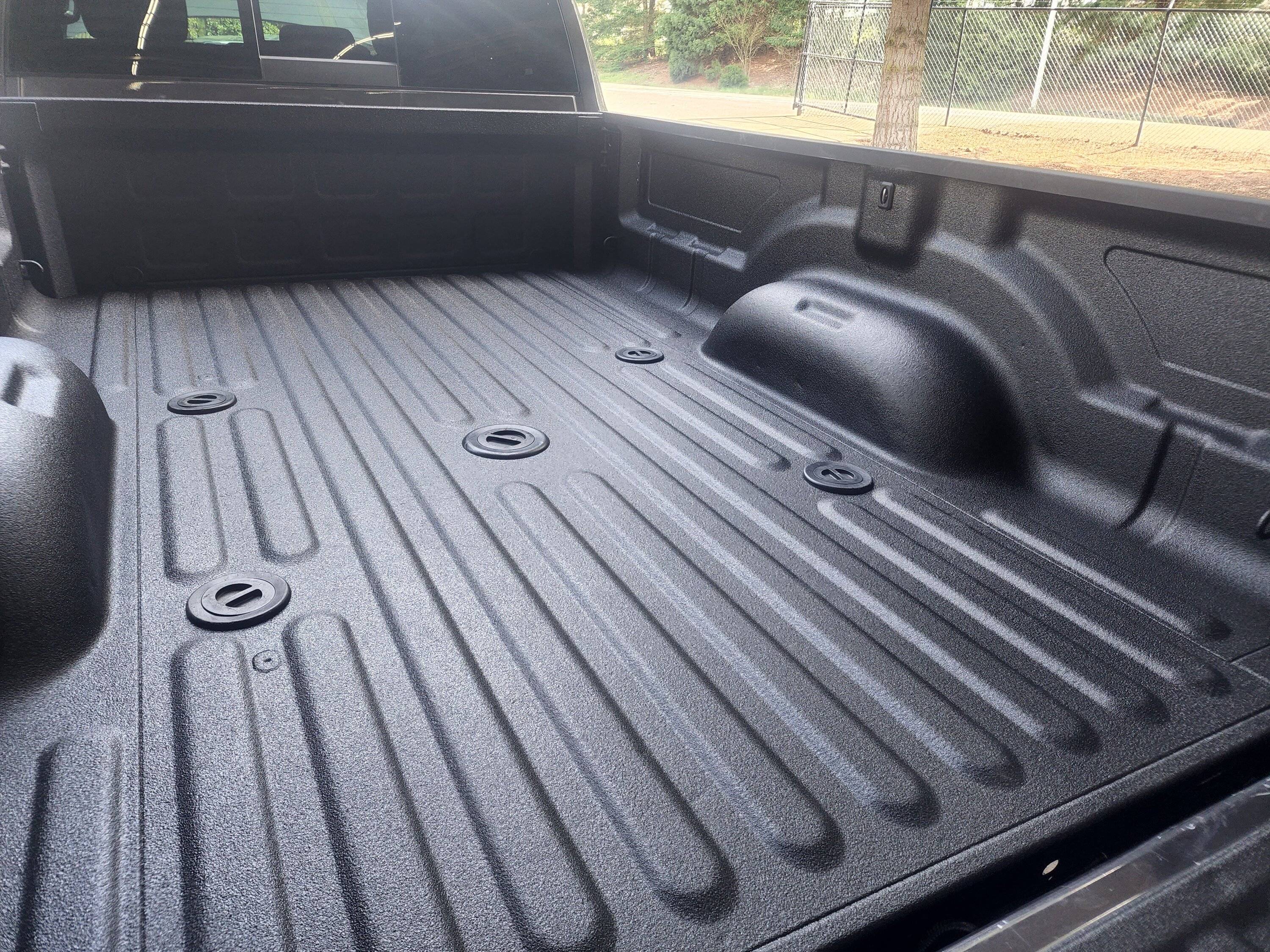

I think most places doing spray in professionally are that way now a days. The place I went to used Xtreme coatings bedliner. Most places will have samples I am sure.
Question, what are the 5 circular holes in your bed? My '21 JTM does not have them.
