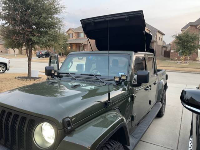

I used the K400SNMO mount on the hood and routed the antenna cable through the cowl around the door seal.
I did not use the thin metal strip between the set screws and hood. Instead, I let the screws dig through the paint on the inside of the hood to make a solid ground plane connection.
