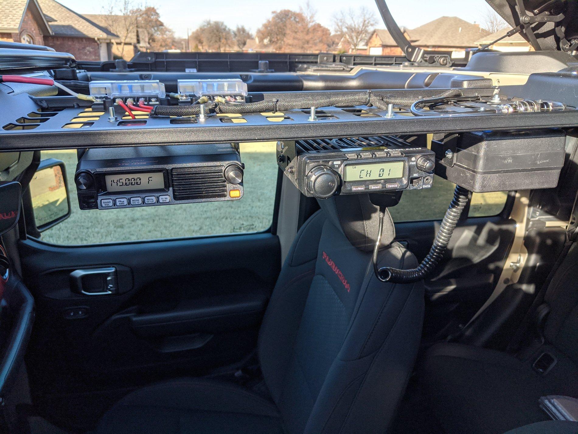

Yeah, I don't have the mics plugged into the ham or GMRS, but they are similar to the CB mic you see hanging in the background. Radios are ham 2M/70CM (General class, callsign KG5LXN), GMRS (callsign WREN924) and CB (just a small junction box for it hidden by the speaker). Plan for antennas is one NMO mount on the hood, and switch antenna to whatever band folks are using on that particular trip. FRS also works, but is awkward to use while driving because can only be used as a handheld radio ...
Nice set-up. What overhead rack is that? MPS?
