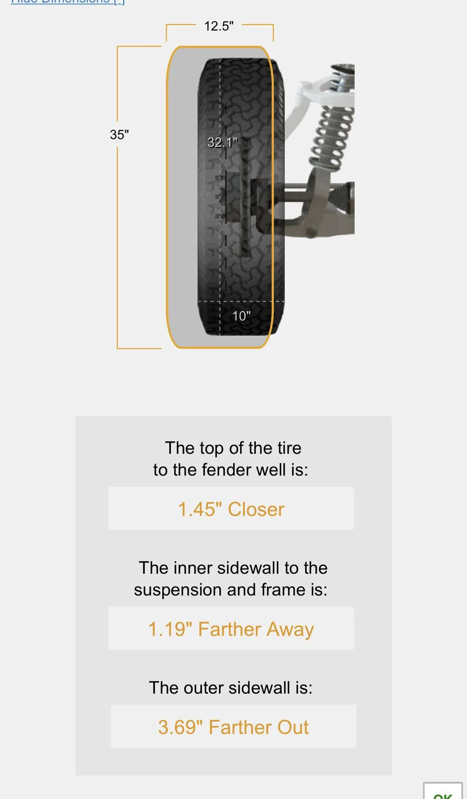

Interested in this Tire and Wheel combo, what do you think? Got some questions.

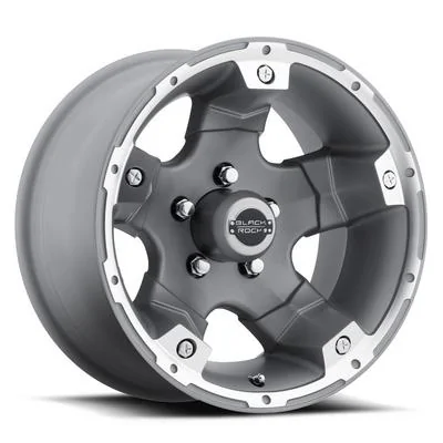

I think i found a good compromise. Viper 900 has a zero offset wheel option. So if grab those with a not so wide tire i wont have to worry about sticking out of the fender so bad.
The Mojave Wheels have additional Back Space to clear the Fox shocks.. I run 4.5" B/S with 17x8.5 if memory is correct about -6mm offset wheels with Toyo ATIII 35x11.50's and have between 1/2 to 1 in (tread block) outside the fenders. Also be aware that the stock lugs might not fit thru the holes in the wheels.. I experience/I know.
I am currently debating between 34 x 11.50 or maybe 35x 12.5 i know its not a big difference i just need to select some choices and see what the weight is, im trying to save weight if its at all a significant amount. Poking out of the fender is not a big deal to me as every single off road rig i has some crazy amount of tire sticking out of the fender.
