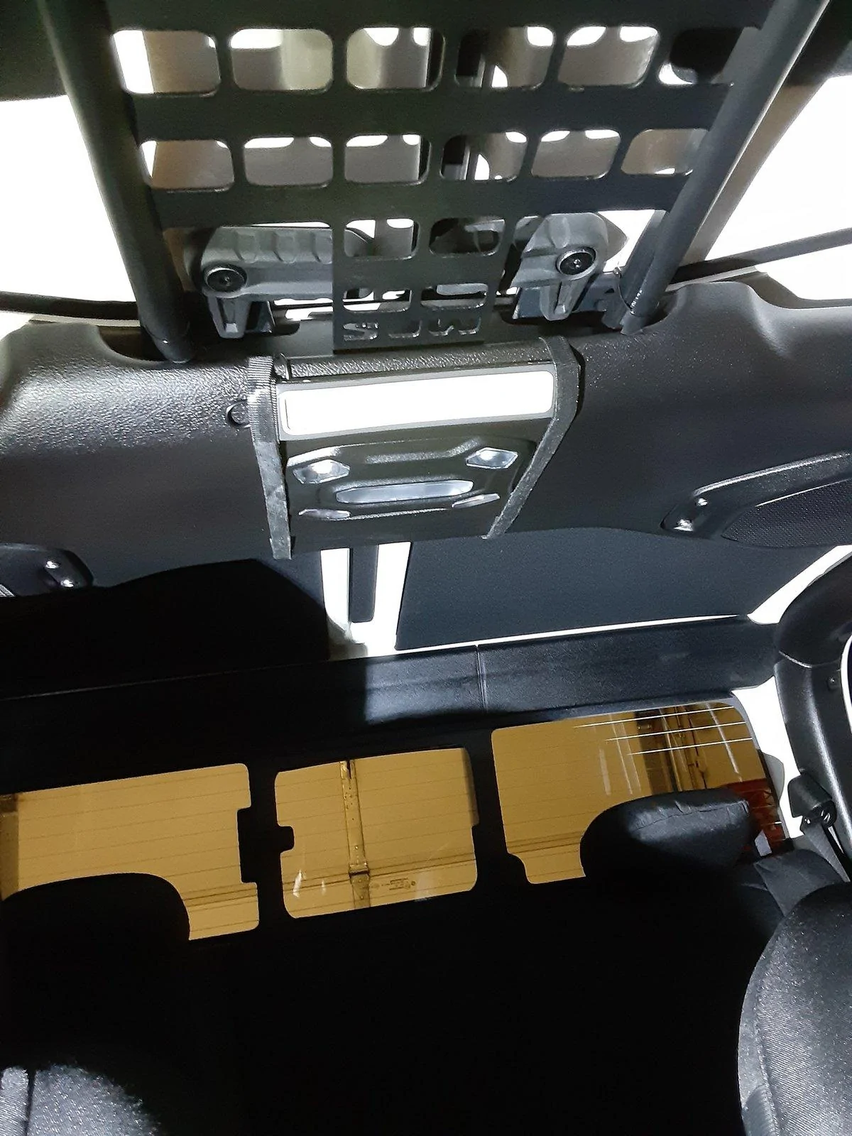

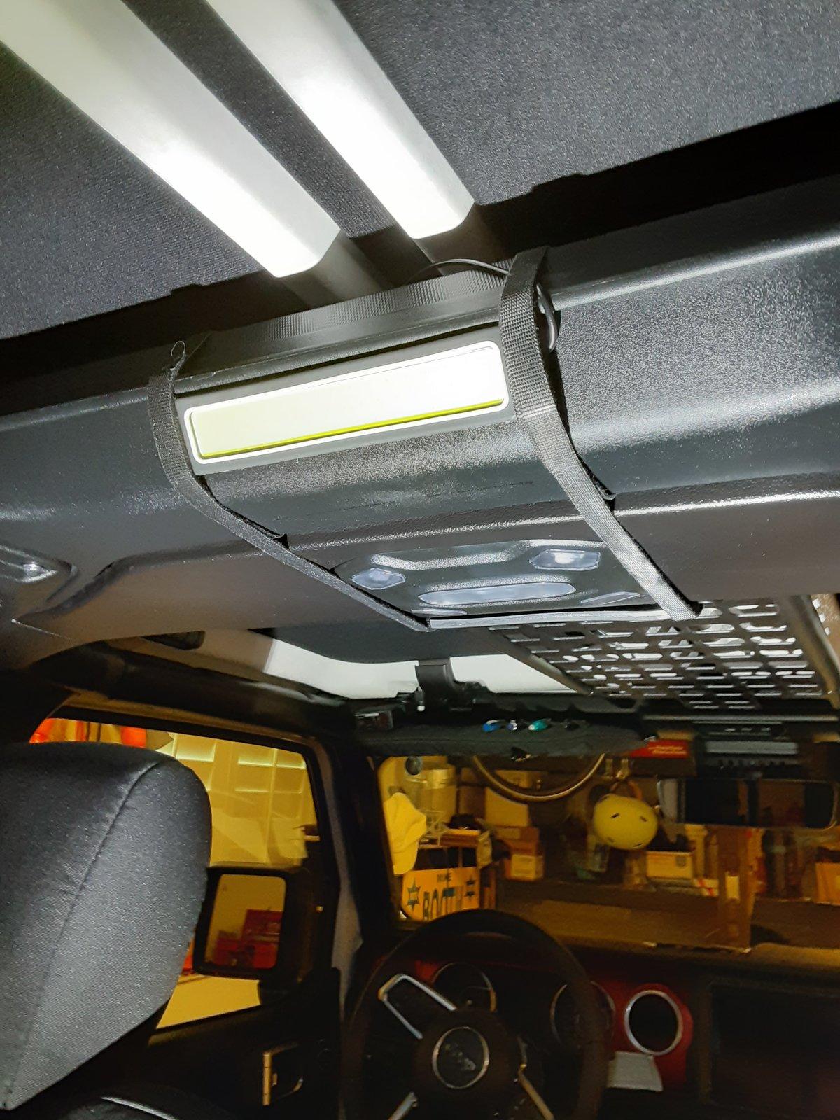

Installed two LED lights for auxiliary front and back dome lights, they will not turn on unless the dome lights are on and a separate on/off toggle switch is also on. VERY bright and draw low power when extra interior light is needed. I fastened them with elastic strips of Velcro for now, don't want permanently glue or fasten them until I consider other lights or mounting options.

back

front
Jeep Gladiator Interior lights, I can't see sheet. 20200213_163750
**** You would not want to turn these on while driving at night. ****

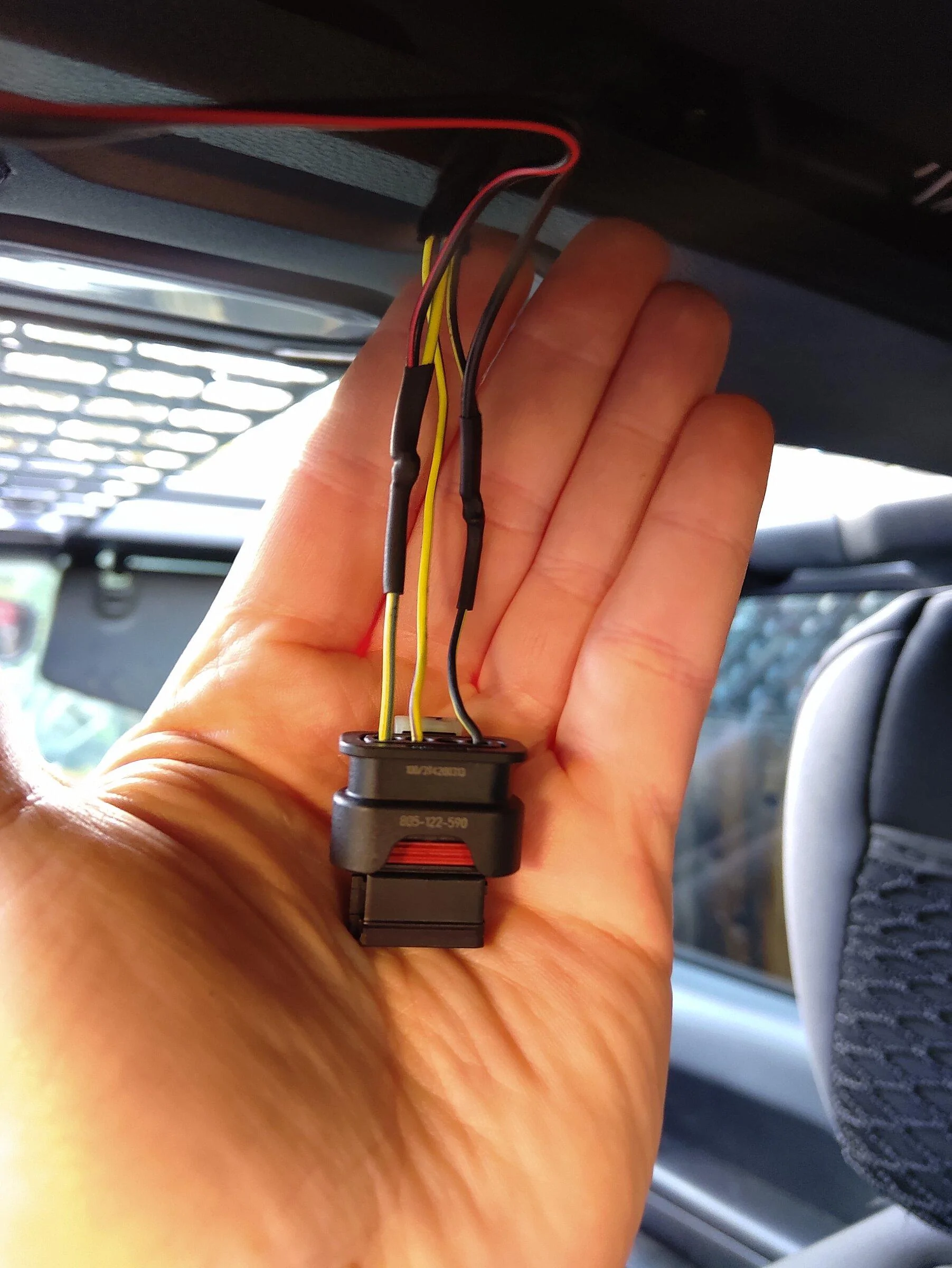

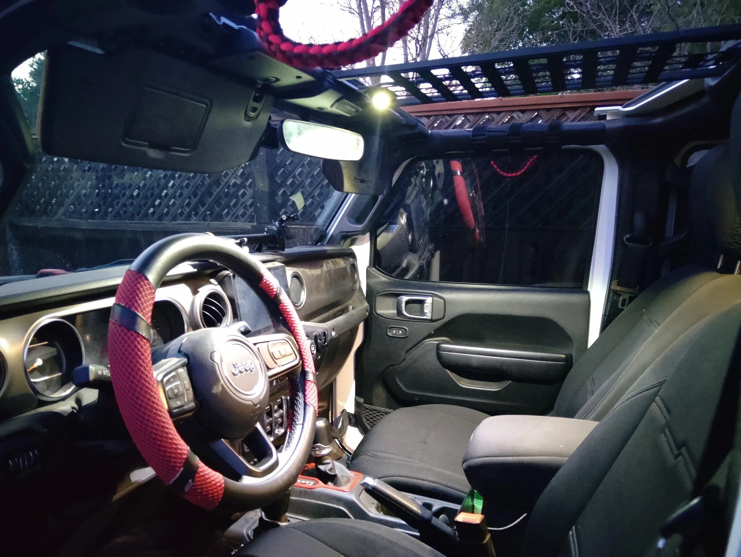

Resurrecting this old thread because I found it when searching and it gave me some ideas.

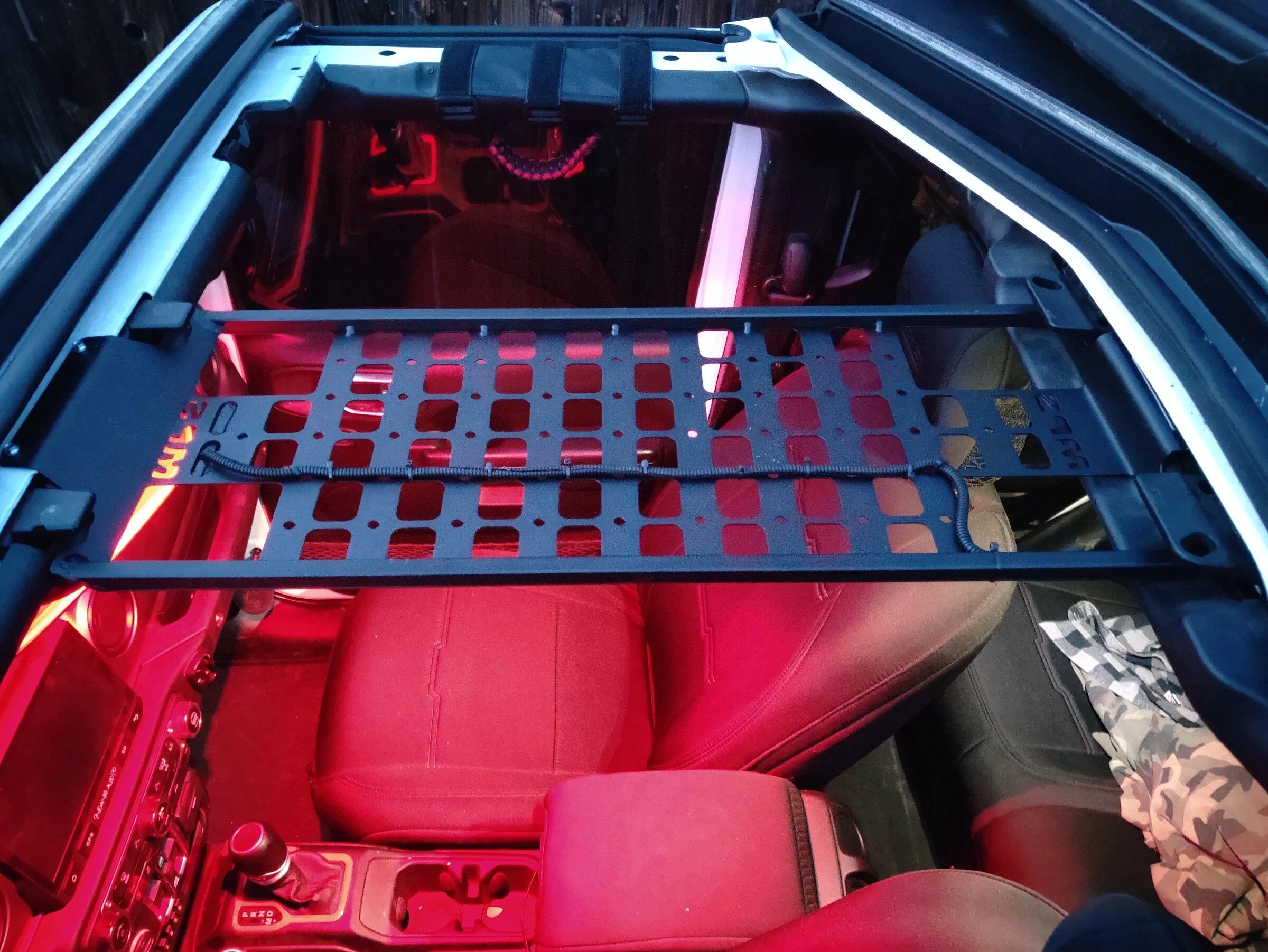

Purchased the MPS Overhead setup a few months ago and finally got some time to install it.
Went with this combo red / white light from the Zon:
https://www.amazon.com/gp/product/B0932JQFW9/

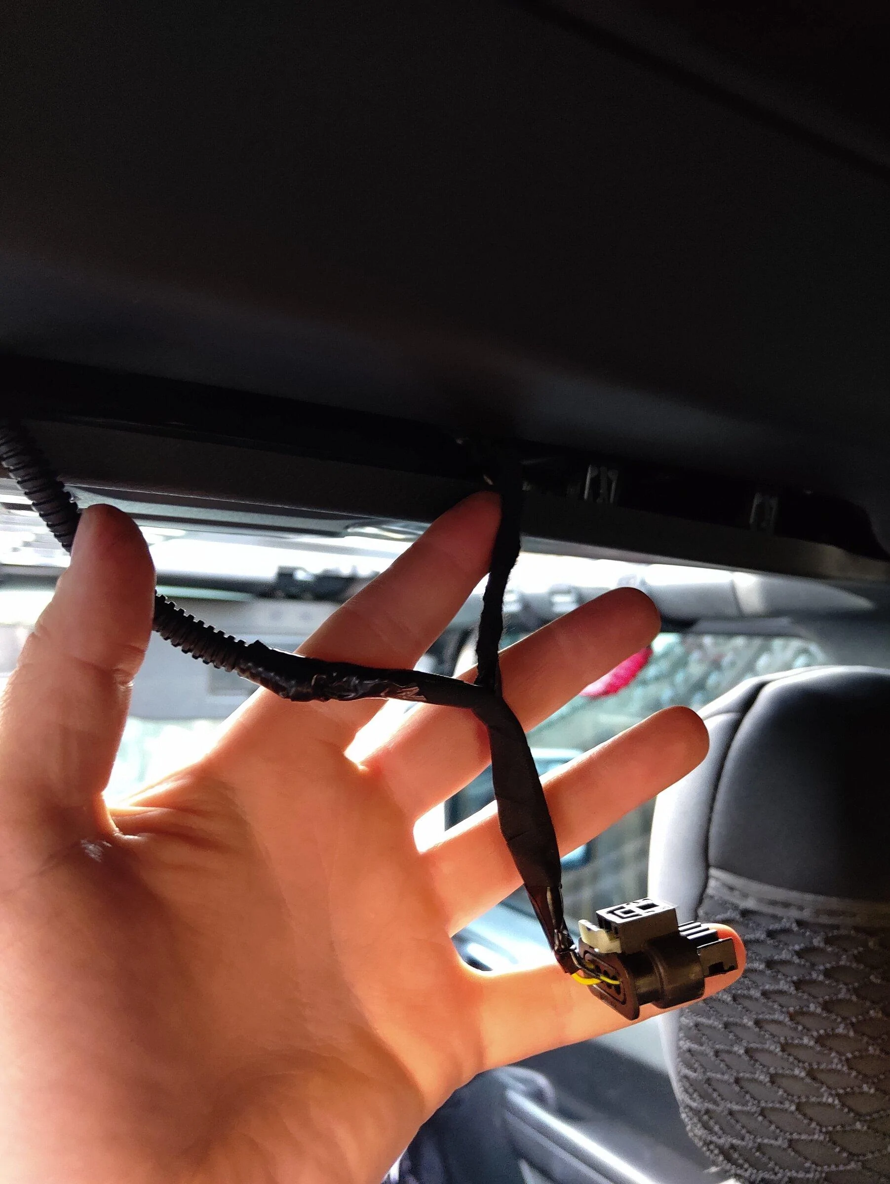

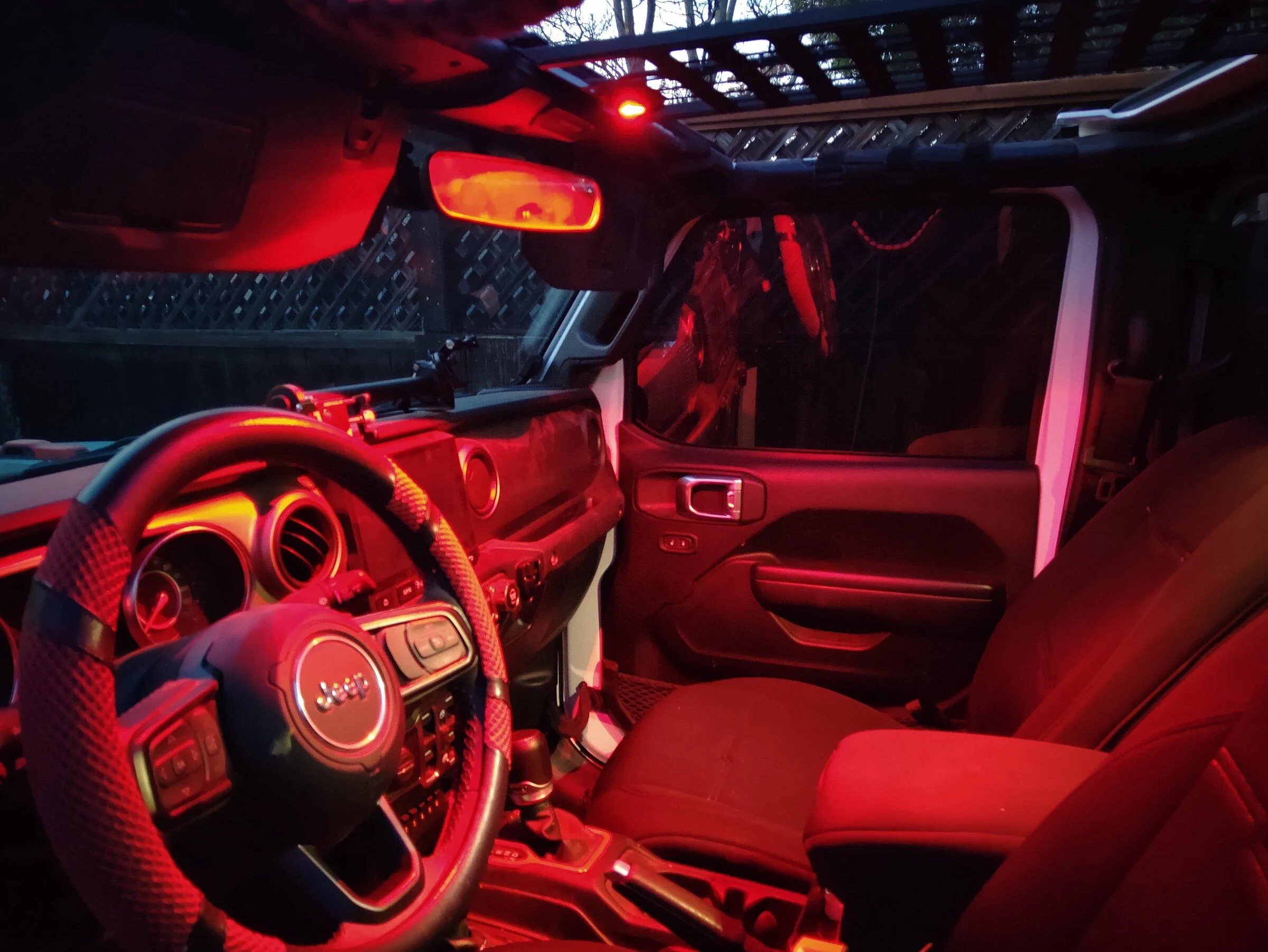

Popped some of the clips on the sound bar and lowered the trim just enough to unplug and remove the harness for the Dome light and spliced into it. The Yellow / Blue wire is switched, works when the truck is in Acc / Running. Attached the light to the MPS panel with 3M VHB.
Was well worth it, this is going to make duck season a lot easier, less fumbling in the dark, can save my headlamp battery for the trudge to the blind.
