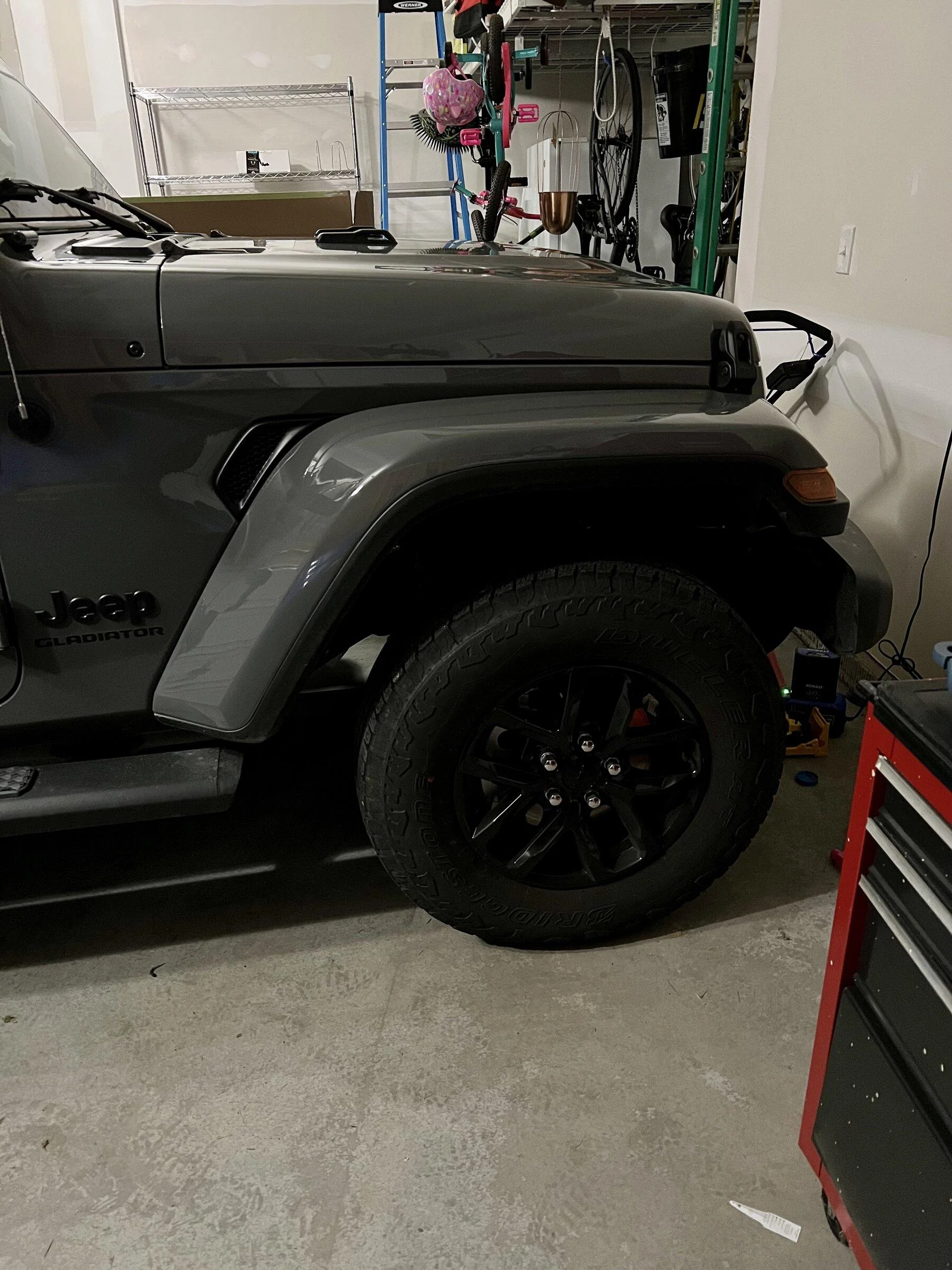

Ive read read myself into confusion... Will 315/70/17 fit on my 2022 Sport S Diesel (Non-Max tow obviously)?
JinxyJ08
Jordan
Apr 24, 2022
43021
2022 Jeep Gladiator EcoDiesel Sting-Gray
Data dude and Realtor.
Ive read read myself into confusion... Will 315/70/17 fit on my 2022 Sport S Diesel with the stock wheels (Non-Max tow obviously)? Picture below for wheel model.
Jeep Gladiator Ive read read myself into confusion... Will 315/70/17 fit on my 2022 Sport S Diesel (Non-Max tow obviously)? IMG_4122
Some say will rub on LCA, some say doesn't. If it will rub exactly where is it? I do not want to run wheel spacers so trying to find my biggest size here with no lift (will do a leveling kit at some point but not right away.)
The deals this weekend aren't bad so would like to find out.
You all are awesome so I appreciate the help.
