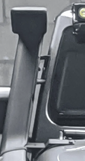

I pulled the snorkel mount off the A-Pillar and slipped the lightbar mount under to mark where it would sit, then pulled it out, tapped a hole and put a small flush head screw thru from behind and padded the head with a little foam. best pics I can find right now.
Jon, Just to be clear, IS THERE 1 OR 2 on that A Pillar? It looks like just 1. Again thanks for your help with this!

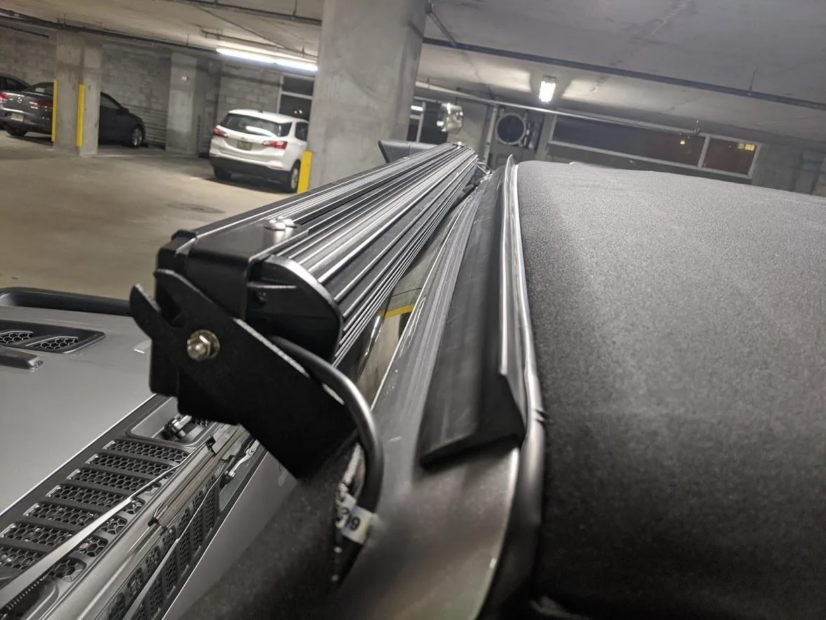

So, I've had a noise issue with the Sunrider.
I know it not the Top's fault, it's the Lightbar.
The bar doesn't whistle, but the air beats on the top like it's playing "I don't wanna work, I wanna bang on me drum all day"
sooo, with beer, comes drunk-engineering, which sometimes actually works....

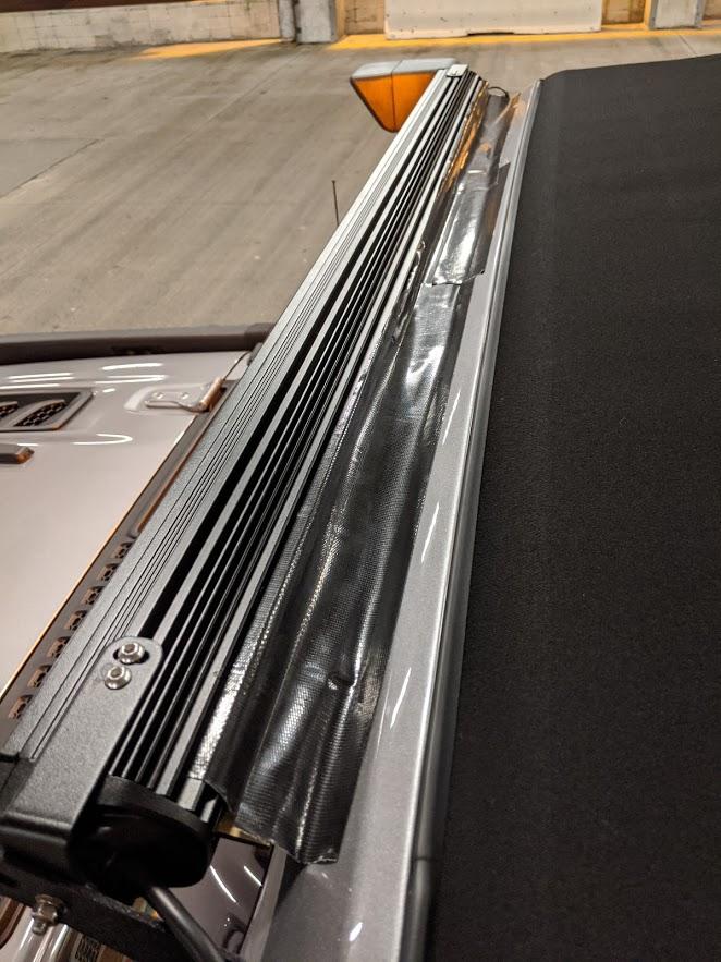

Plan A:
Let's even the air over the top of the bar.
eVAkqiFMLveOcwdmN3_GhmEVJ5KMxp5RScyyRpnN3f7ZCs4ErRtc2Q3UfbWe-dZHfQCX8mkiyH8ZAvjcJdU=w663-h883-no.jpg
Nope, air still beating the drum all day...

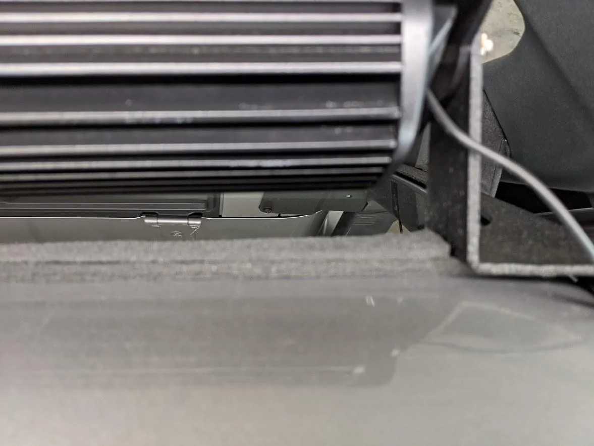

Plan B:
Let's stop the air below the bar.
put two strips of expansion foam between the windshield and bar, took the heat gun to it and expanded.
xtomXri1zJ9GeZDRrW7UdfTYzUAeMVW4R2NzSQsdaYpJHBDNcJdl7k7MMP08tRpr5YxeHWIOkF9BmAwdQA=w1178-h883-no.jpg
Nope. seemed to help, but no Bueno.

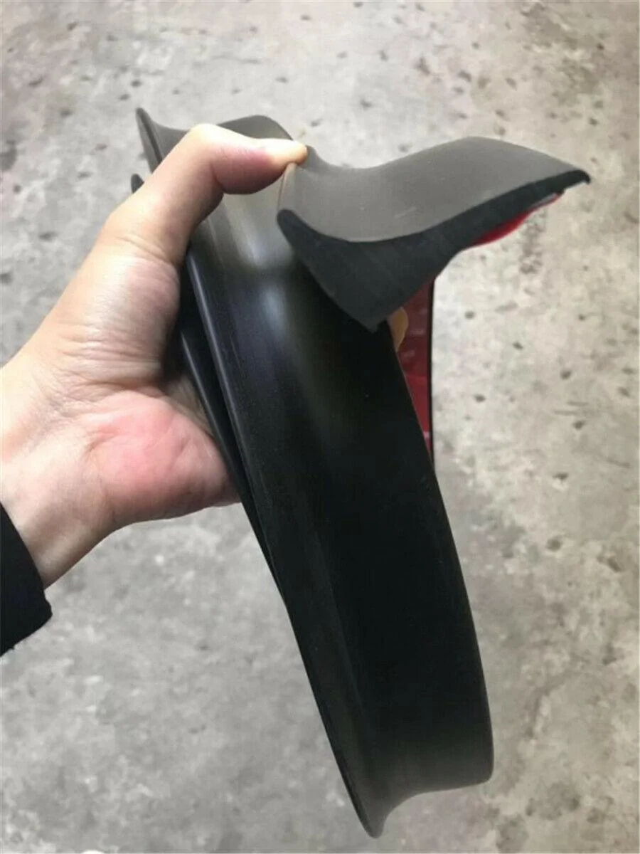

Plan C:
I need to get the air between the bar and windshield to force the air going over the bar higher, cause drunk-engineering...
W4LRiZBGVlV50yh8hWVAAyOdWmzha7TkkUtzsbl3iHxYrRodKz6DP29kNC7c9tmWXSMquiwzNeUXYEV22k=w1178-h883-no.jpg
BINGO!!!
This took the air coming thru and up, forcing the air going over the bar higher, and making the turbulence go away.

Very inventive.. I assume you did practice proper scientific methods and wait at least 1 hour between uhh test runs.
jous so silly....
This is one of those, "ya, I'll check it tomorrow" issues that went over a couple of weeks.
The Plan C rubber 'deflector' took a week just to arrive.
(it's a rubber side-skirt trim, came in two pieces, just installed the 2nd one on a buddy's JL with that fancy electro-top-thing they have).
https://www.ebay.com/itm/Black-1-57-Width-Universal-Rubber-Car-Side-Skirt-Lip-Scratch-Guard-Strip-78-2x/113851197076?ssPageName=STRK:MEBIDX:IT&_trksid=p2060353.m1438.l2649
gGCTDY3uTnbJinc3R6B6JIBdFxc8aJ0ucdfER-dHAL844AX5BO9MWNvapTWkY4GK0FmbUOakqTid6OaHYw=w1098-h824-no.jpg
