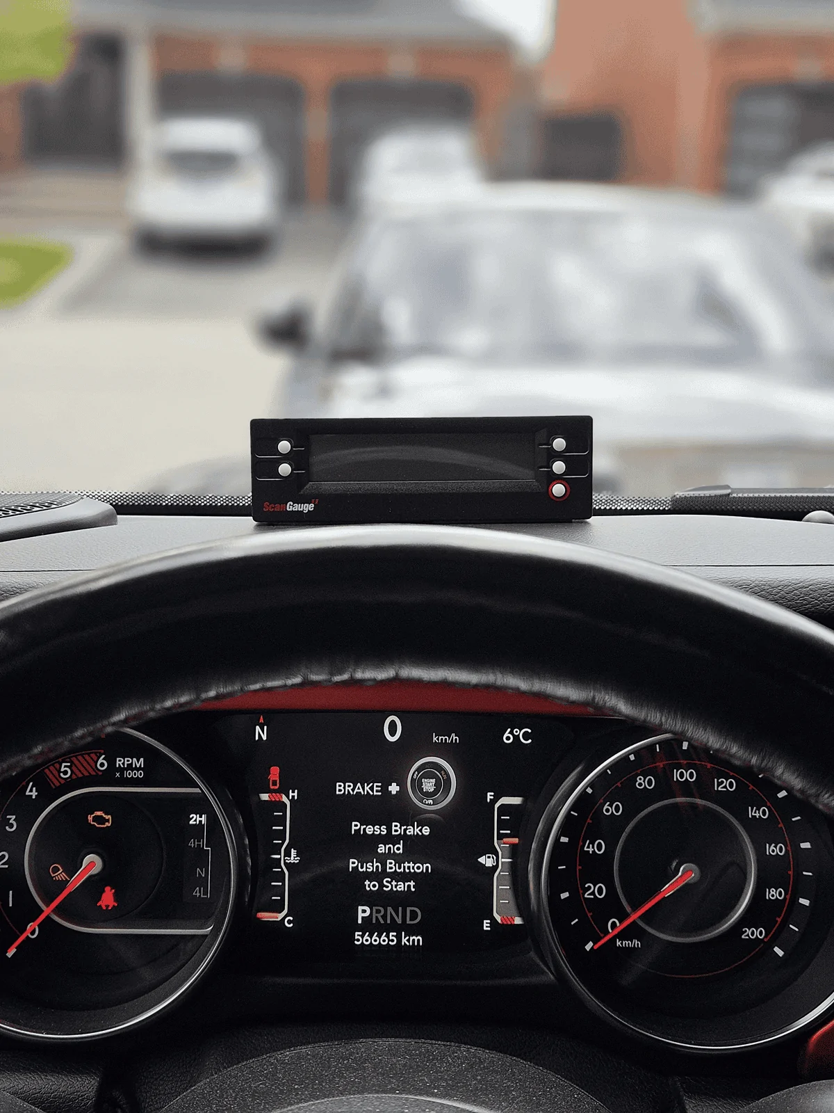

Mounted up the scan gauge temporarily on the dash just with some 3M tape. Brainstorming a better location to mount it, trying to minimize things sitting on the dash. I originally wanted to carve out a nice location in the dash for it, but there isn't a lot of real estate that keeps it visible easily while driving.
Not a fan of the window suction mount either. I'm thinking about getting a ball mount for the A-PIllar handle and then using 3M tape to mount a ball mount on the back of the scan gauge and seeing how that works.

Your the second person I have seen with a scan gauge today. I personally have never heard of it. Is there a big difference between it and the iDash?
I would say the Scan Gauge is a little more basic than the iDash, a lot cheaper if I recall as well. I literally just wanted the ability to see my EGR temps, regen status and soot level which the Scan Gauge does great for a sub $200 package. It's really common with truckers, was recommended to me by a family member who is a trucker.
Thanks, I just never heard of it and then I suddenly have seen it a couple times so I was just curious.

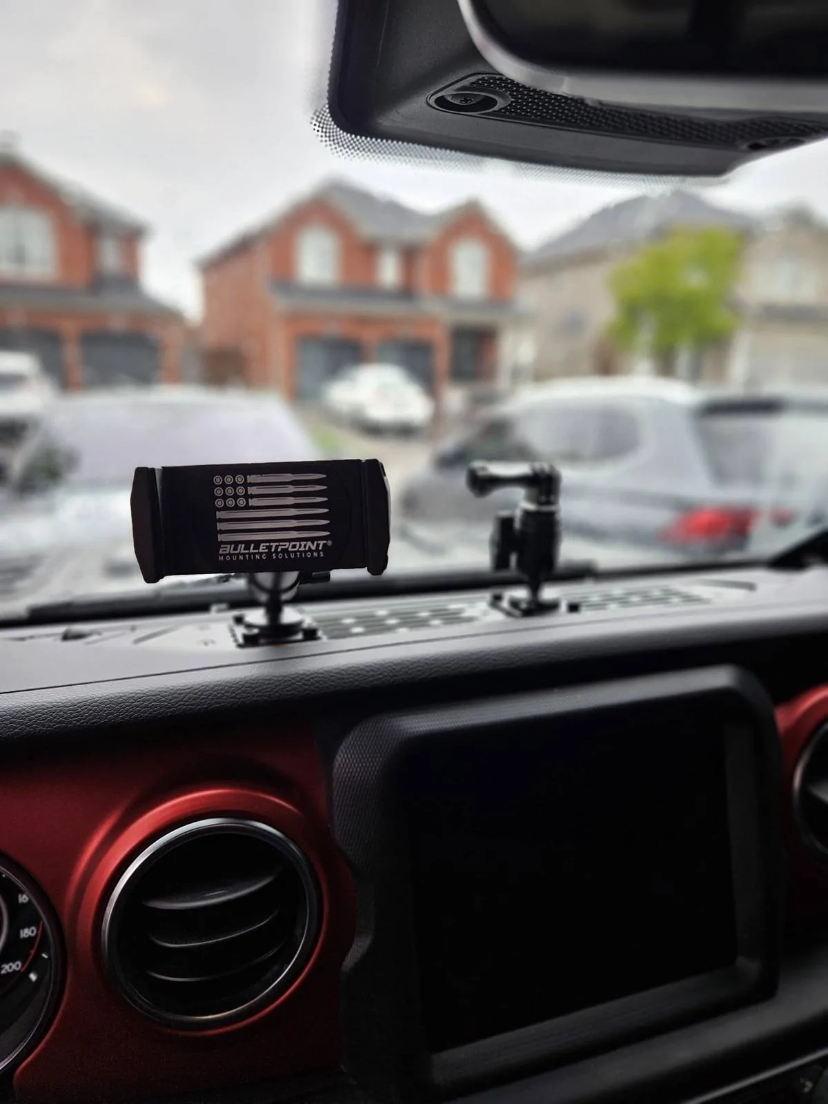

Another minor mod to the Jeep... installed the Bulletpoint mounting system for my phone/action camera and will eventually add a tablet mount. So far I'm impressed with the quality of the mount and the functionality.
I have a few smaller but pretty important mods happening over the next month, I'm getting surgery in a week for a torn meniscus so anything major will be held off for a few months while I do rehab.

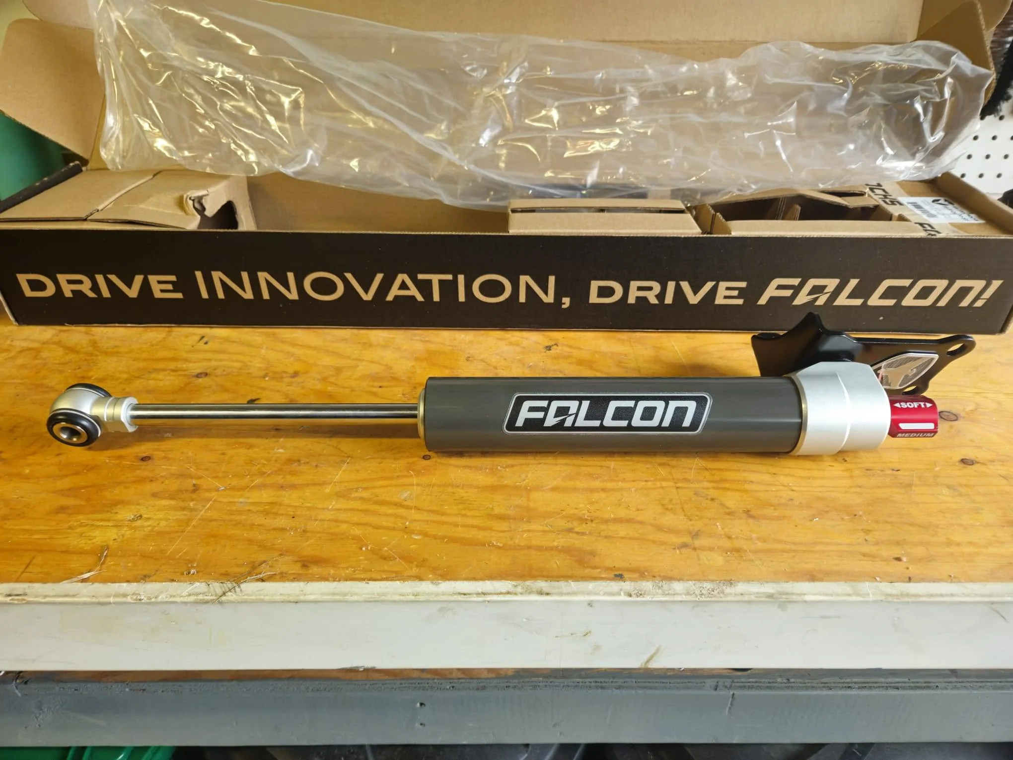

Picked up a Teraflex Falcon 2.2 Steering Stabilizer for a wicked deal, so slapped that on today. It's a night and day difference from the stock stabilizer, especially on the firm setting on the highway. Wind doesn't toss you around like cardboard in the wind anymore. Took maybe 45 minutes to install. It's a bit pricey, but I do like the adjustment capability. I can't see myself using firm around town as the rebound is pretty slow, but on road trips that firm setting is a god send. I had my hand off the steering wheel doing 105-110km/h and it was tracking straight as an arrow.
Its made me notice the slop in my steering wheel though. I have the upgraded steering box so might need to do that 1/4 turn to tighten it up.
I have to share on this product you installed, I’ve had one installed for a year now, replaced the stocky on my Sport, read the marketing info but most of my use has been on the medium setting around town and gravel roads, trails the soft setting was perfect. I never really used the firm setting. Since upgrading to 35x1250x17 MTs some mild wind pushing me around and some wandering on uneven pavement I just chalked it up to the first set of MTs on the JT. After reading your post and a quick 450 mile freeway trip to fetch a grandchild from college, I locked in the firm setting and hit the road, a steady 80 mph in ID and 70 mph in OR. Empty going, just me, my power tank, and 40lbs bag of tools. Coming back, loaded back seat area, and bed. Ballpark quess, 500 lbs. The wind was relentless down and back…35 mph gusting, steady 20 mph the entire trip. I was blown away by the Falcon performance!!! It absolutely planted those 35” MTs, no wandering, and a very planted feel in the wind. This product if your running a stock stabilizer should be your next modification!!! OP, THANKS for this post, it got me off my butt to actually use all the features of this product. I ran my usual 36 psi in the 35s and they heat up and expand to 39/40 psi at 80mph.

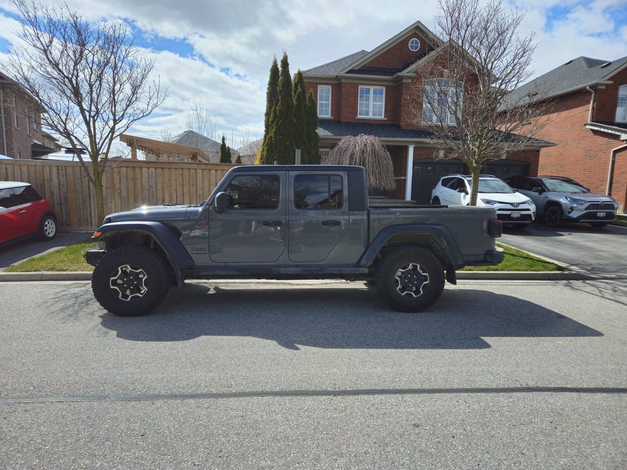

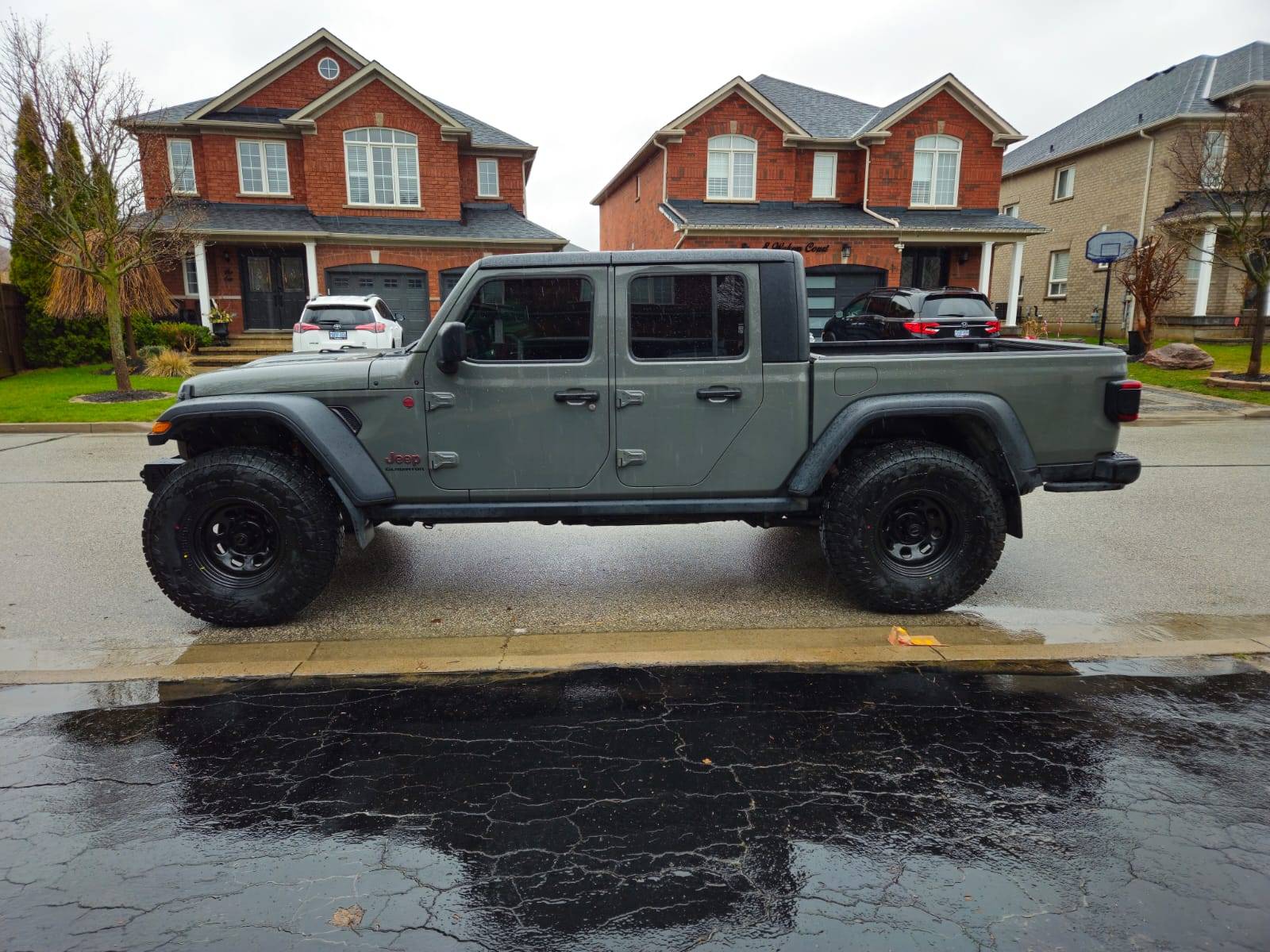

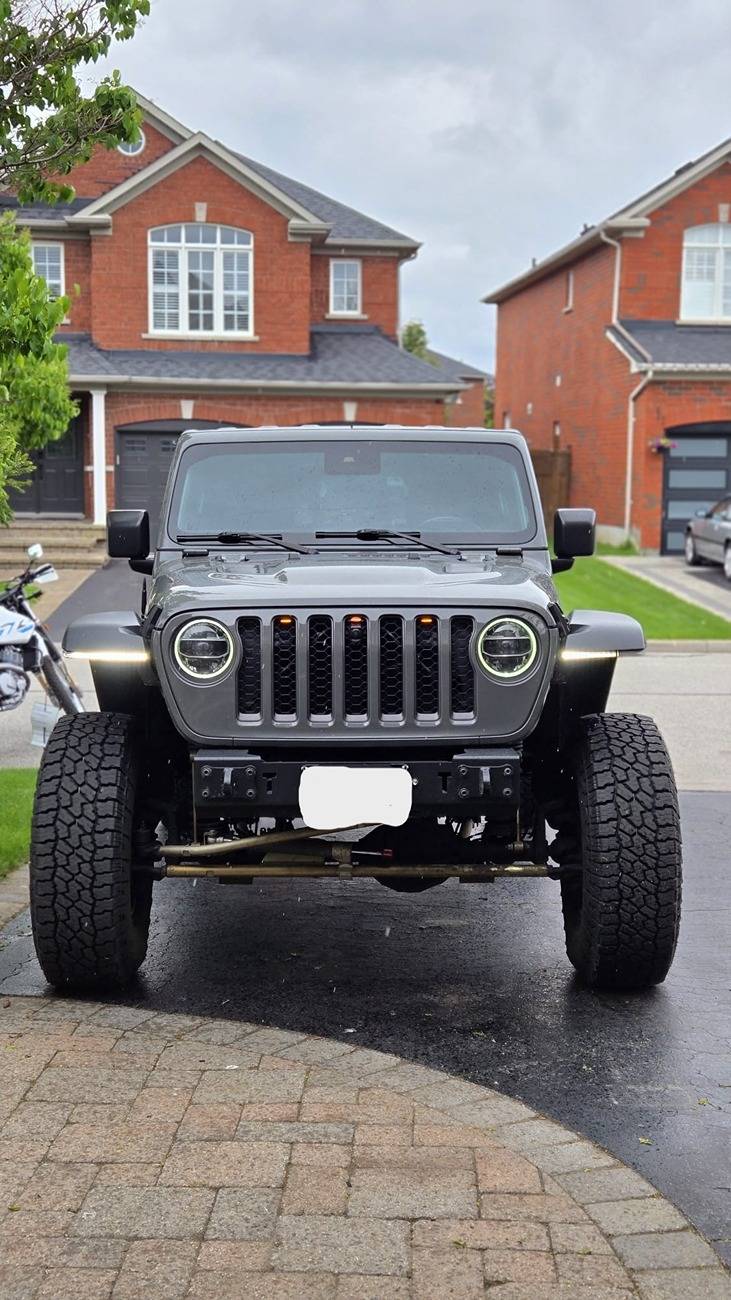

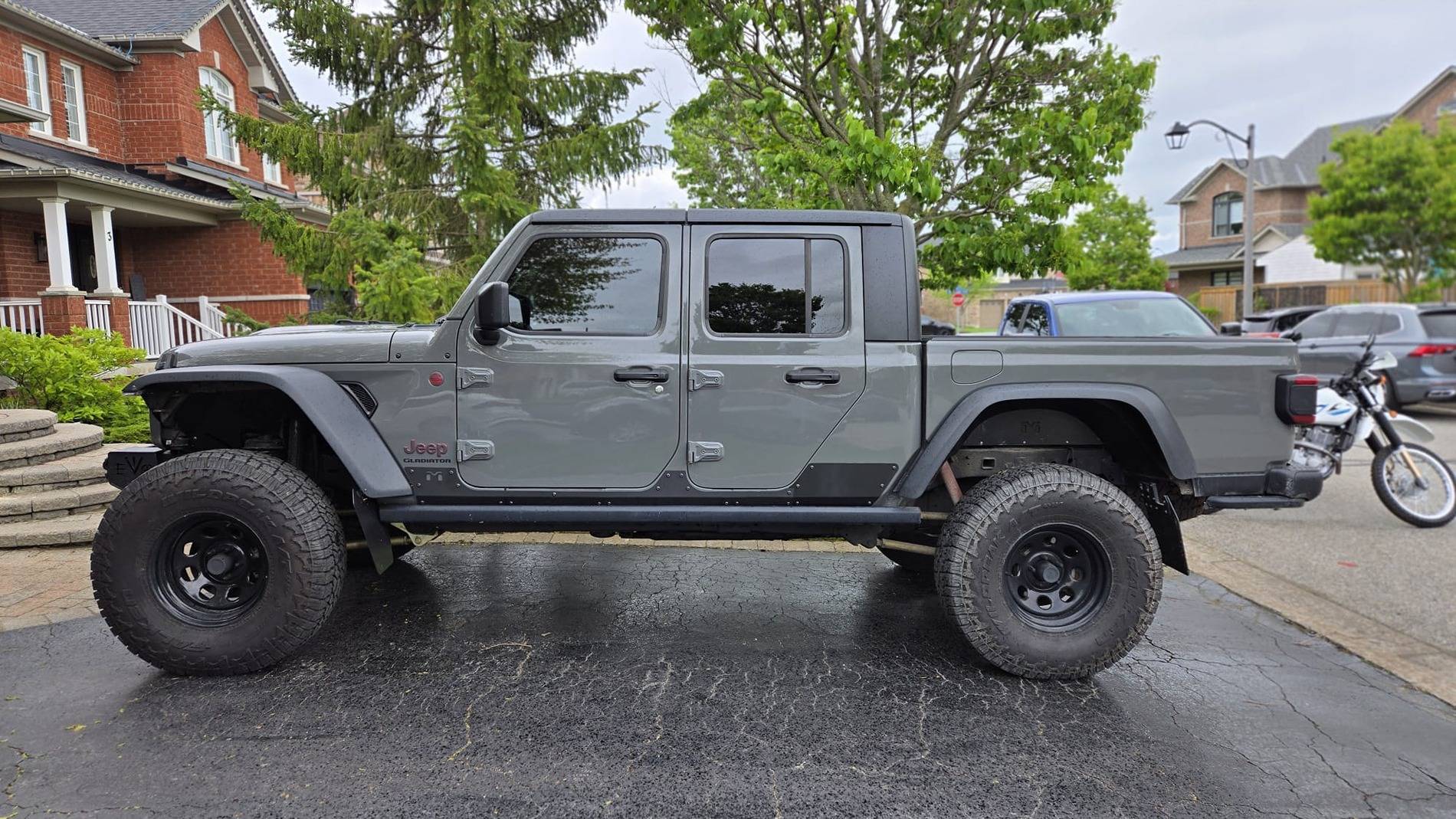

Been a little busy! Thought I'd update the thread with a few pictures... Rough list of what has been done below.
  • Metalcloak 3.5 Rocklander Lift w. Drop Brackets
  • Metalcloak Full Steering Replacement w. Falcon 2.1 Stabilizer
  • Metalcloak Aluminum Fender Liners
  • Metalcloak Aluminum Side Armor
  • Metalcloak Rear Sway Bar Link Bracket
  • Full Frame Blast & Waxoyl Rust Coating (Live in salt central)
  • AAL Fender Chop Lights (Highly recommend against purchasing American Adventure Lab Products - Terrible customer service)
  • Rokblokz Front & Rear Mud Guards
  • Full Front / Split Rubicon Fenders
Going to be replacing the front driveshaft and adding full MC belly skidplates in the next month or two. Windshield just cracked so replacing that with a Gorilla Glass windshield + Exoshield.
Can't recommend @Metalcloak products enough.

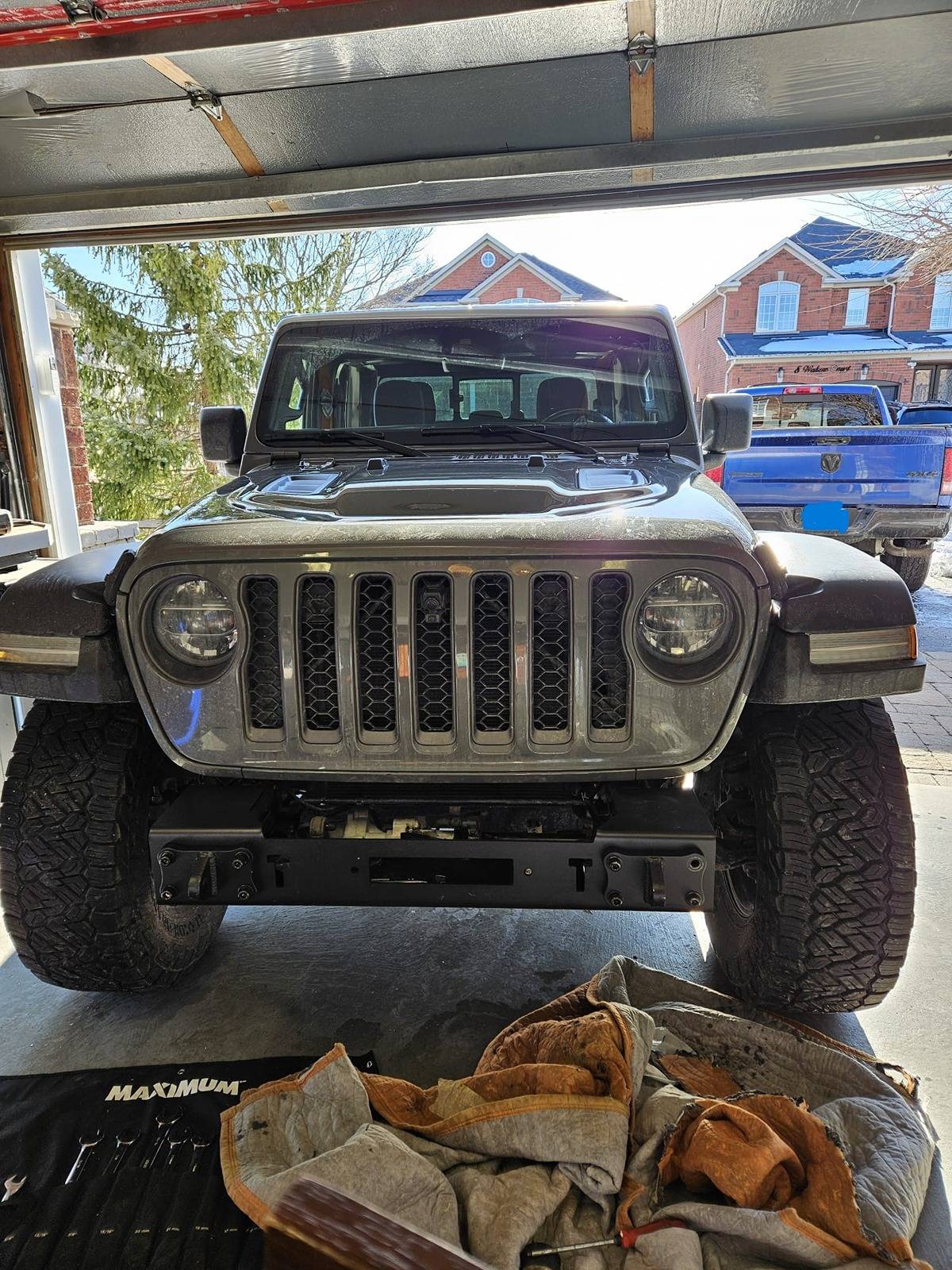

Good afternoon folks!
I wanted to get a start on this thread so I can document my poor spending habits. I'm an avid off-roader who swapped from a built out 2015 JKU to a 2021 Gladiator Rubicon Diesel, as I am getting more and more back into camping, fishing, etc and wanted a more suitable vehicle. I'm huge into travel and the goal is to build this vehicle out into an Overlander while maintaining some fairly good offroad capabilities, with the eventual goal to do both the Trans Canada Highway & Pan American Trail.
I'm quite hands-on and will normally do everything myself unless I don't have room due to my other projects (poor spending habits). I've done a few modifications so far, otherwise, the vehicle is stock but I have a very long list of modifications lined up for this thing. Below is what I've done since owning it (February 2024).
  • 15% Window Tint (Minor, but necessary!)
  • Rugged Ridge Locking Hood Latches (Live in an area where Gladiators are stolen daily)
  • Engine Kill Switch (Vehicle will not move unless this switch is activated)
  • Rubicon Motor Flip (Did this for bumper clearance... I'm swapping this out later this year anyways)
  • EVO 1/4 Quarter Pounder Front Bumper
  • Teraflex 1.5" Leveling Kit (Temporary)

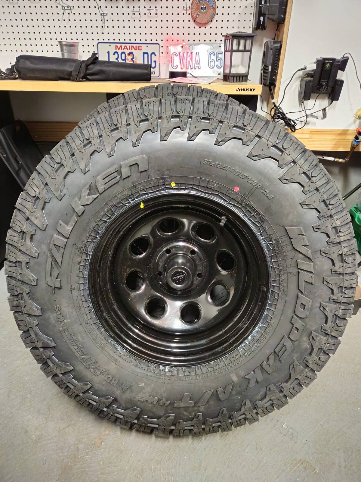

I also have 37" Falken AT4/Ws on Pro Comp 17" Steelies that are going on this week. The truck has brand new 315/70R17s on them, but they're going on my other truck so I thought this would be a good time to go up to 37's. I likely will go back down to 35s when aiming to do the Pan American Trail (3-5 Years) but for now, 37s are good for staying within North America.
I'm planning on starting an Instagram and YouTube to document my build and travels... I'm learning cinematography as a hobby right now, so thought it would be a cool way to practice and improve.
(I'm aware its missing a bolt. The bolt came with mangled threads, trying to fix it with cast before contacting @EVO MFG)
