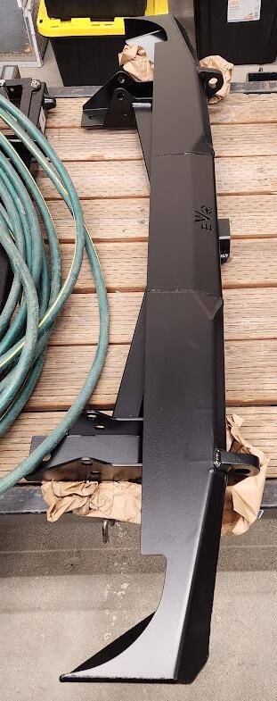

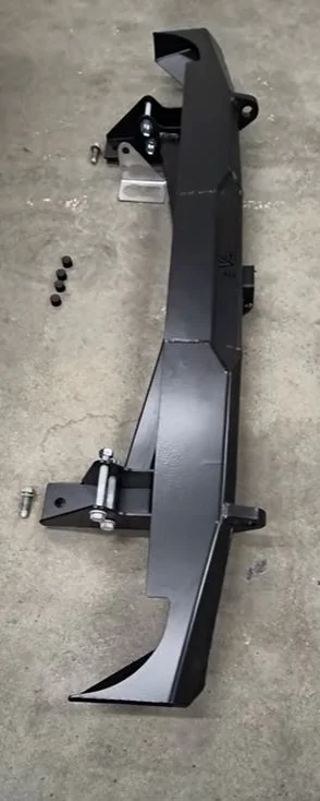

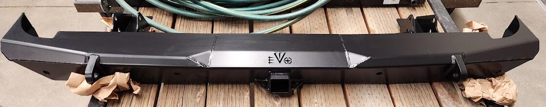

Sorry for crappy pics, but just got bumper back from powder and snapped off a couple pics.
Hoping to provide some details, install pics and impressions vs OEM in the coming month.

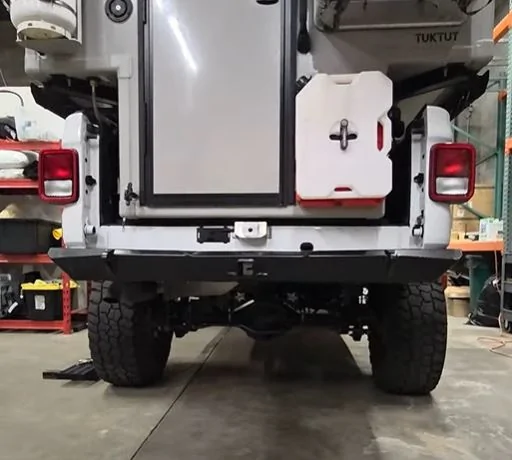

Finally got around to install and I'm super happy with the outcome! I've never owned an EVO MFG product before and I am very impressed with the fitment. The holes lined up perfectly and the body lines were uniform... no enlarging or elongating mounting holes with a grinder bit to make it fit.
Here's a couple stats:

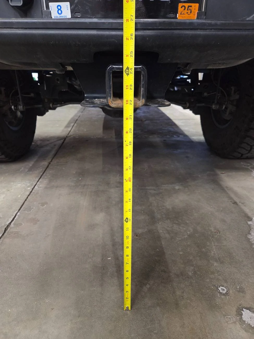

1) OEM Steel Rubicon bumper with bed sliders/tow hooks/receiver = 125lb

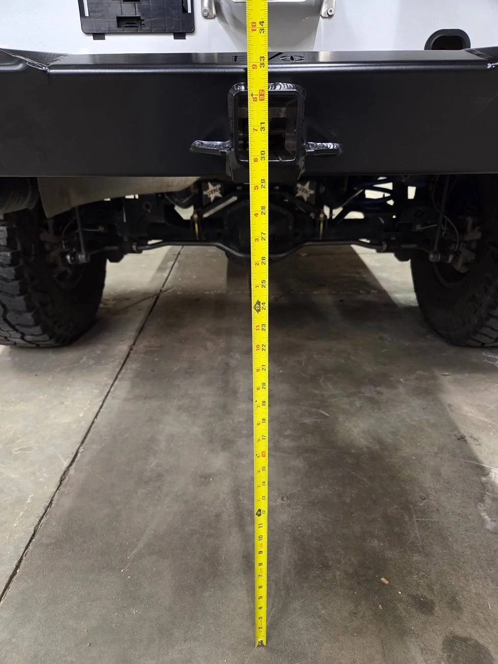

2) EVO H&T w/ receiver = 67lb (raised the center of the hitch by 8")
I'll get some more pics as this was a late night and I didn't have a chance to touch up the white color bed panels (with black paint) that are now exposed.
OEM hitch height = 23" center from ground
Jeep Gladiator JT High N' Tight Rear Bumper 20250305_174325
EVO hitch height = 31" center from ground (+8" of additional clearance)
Jeep Gladiator JT High N' Tight Rear Bumper 20250305_195636
EVO H&T hitch reuses (4) OEM long bolts thru frame + (2) OEM short bolts at bottom of frame. Also included is a bracket for the trailer wiring harness and backup sensor plugs. The kit also comes with back up sensor brackets if you have OEM sensors (pictured below)

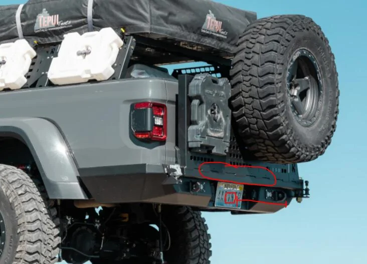

The Relentless Fab bumper has ben on the top of my list for a long time, but it didn't fit my application for a few reasons...
1) The optional tire swing carrier has no receiver provision for a bike rack. We use the Jeep mostly for MTB/camping trips and this is a deal breaker.
Jeep Gladiator JT High N' Tight Rear Bumper 1743463747696-3d

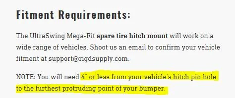

2) Yes, I could have purchased just the Relentless or Artec high clearance bumper portion with receiver, BUT I still wanted the tire swing from RiG'd and they specify that fitment requires 4" or less from the furthest point on the bumper (i.e. recovery points) to the center of the receiver hole. To be fair, I didn't called Relentless or Artec to verify this distance but from the pics on the website it appears that the recessed hitch pin location of both bumpers (due to license plate mounting) was greater than 4" and wouldn't fit the RiG'd Ultraswing. The Evo H&T has the receiver at a further out point in relation to the recovery hooks and you can still see how close the RiG'd Ultraswing "sucks up against" the recovery tabs ... nice and close.
