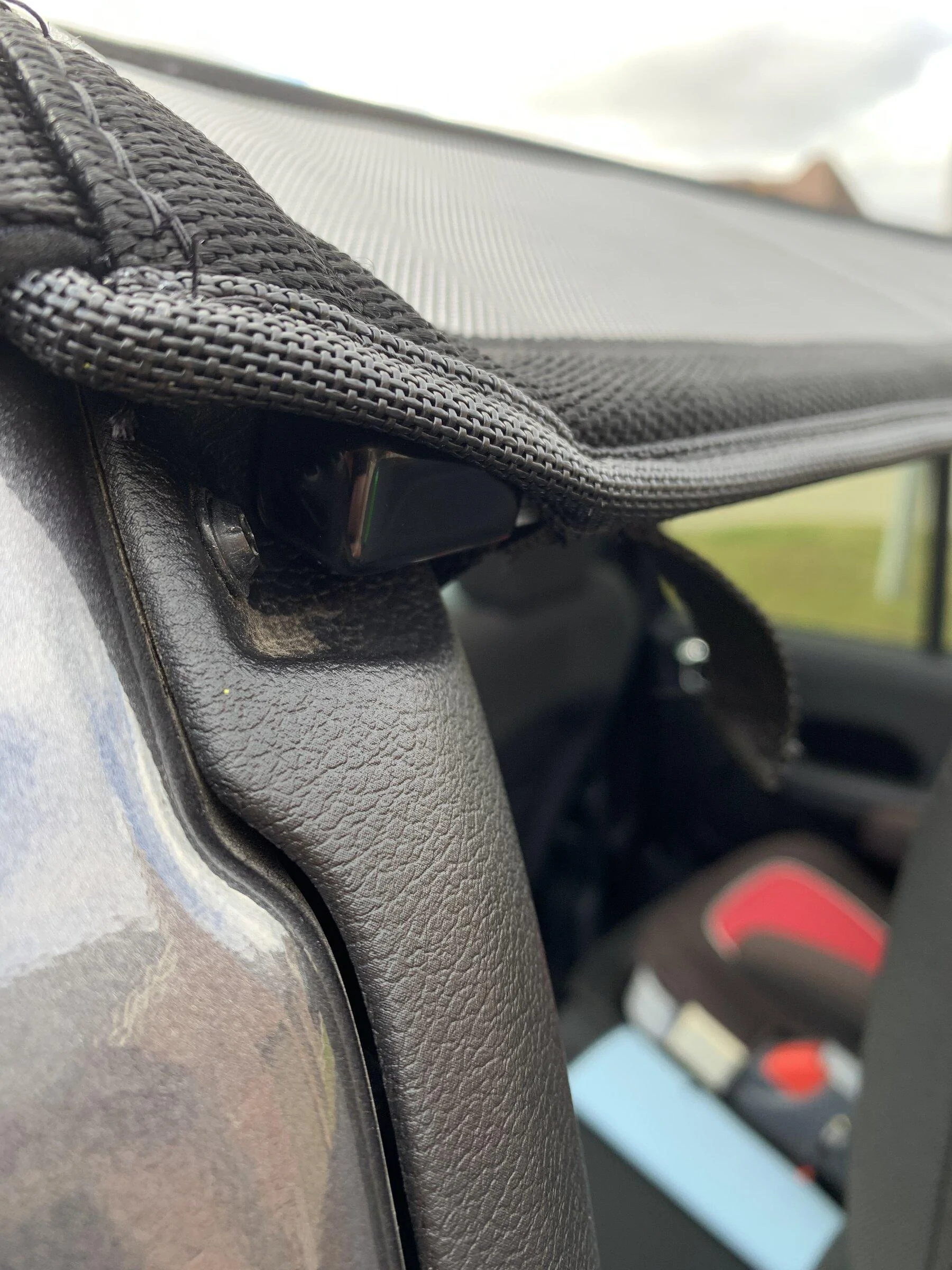

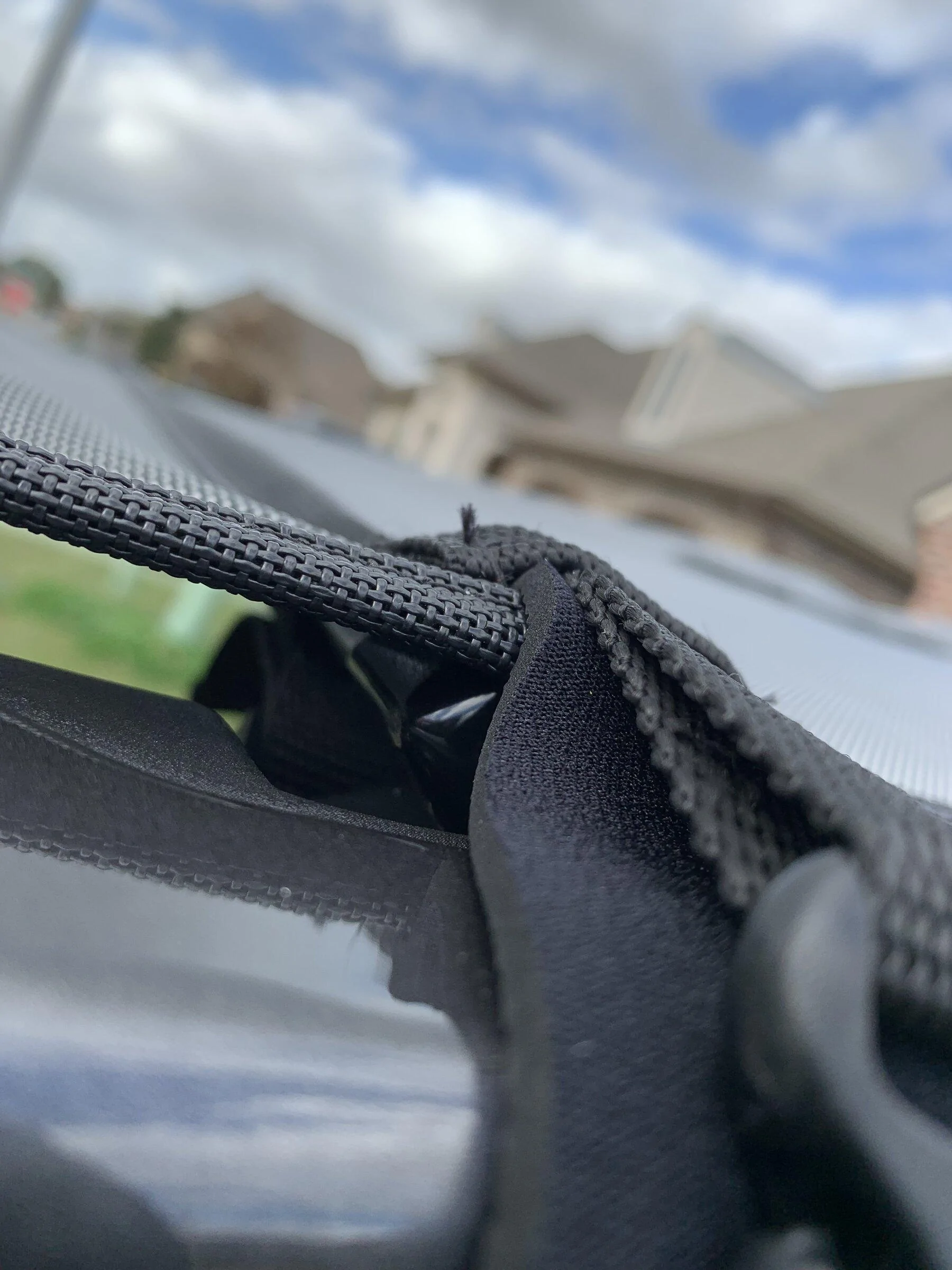

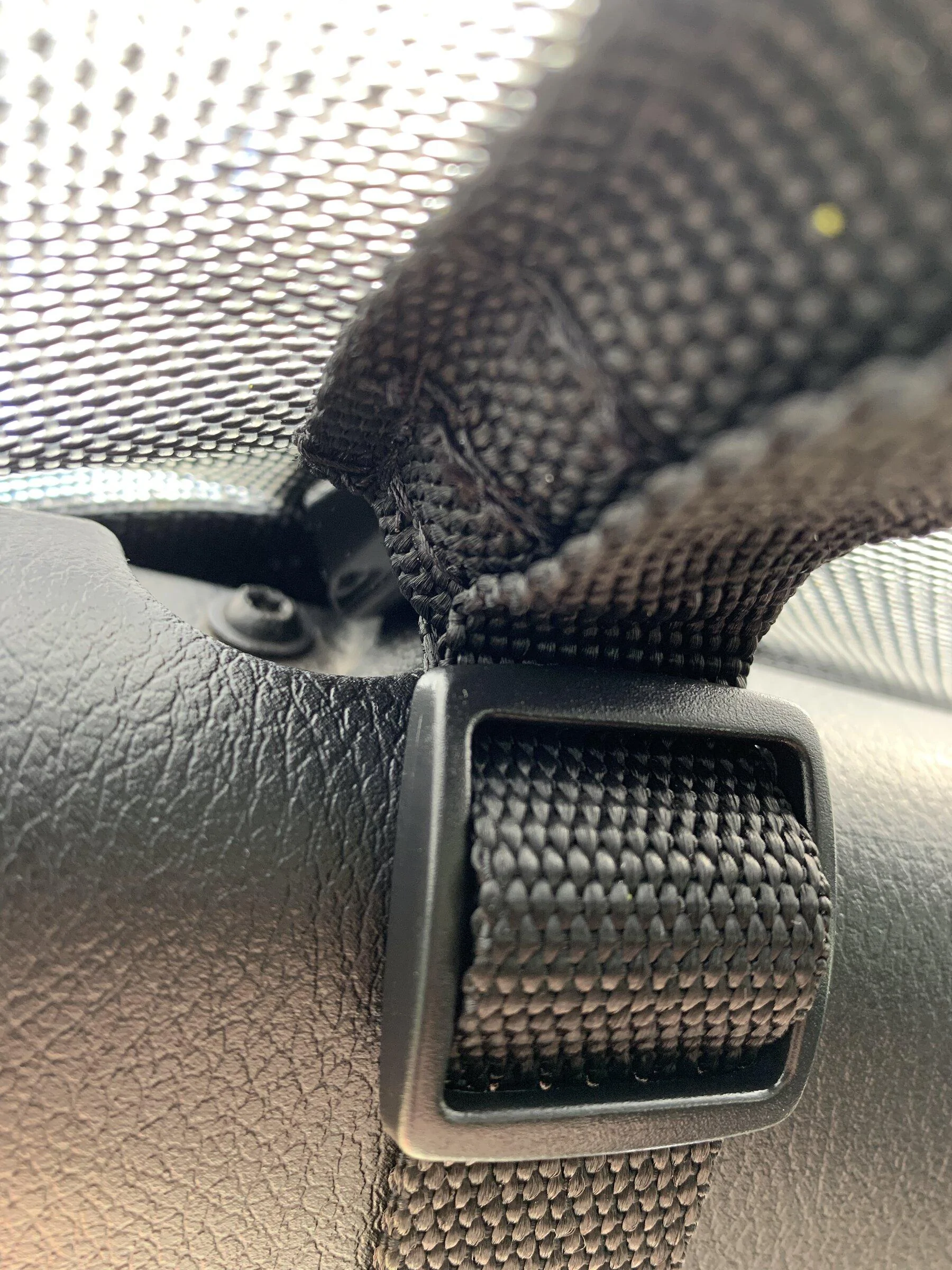

I just put the hard top back on for an evening trip. I did grab three pictures earlier of the bars and the notch that corespondent with it. So far the best fit for me is to force the rear cross bar into place. The rear bar is easier to keep in the notch because of the way the rear roll bar curves it sort of catches the bar. The pictures I have are of the rear bar holding in place and the other two bars pulling backwards due to the strain. First pic is rear bar, second pic is if the front bar being pulled and rolled out of its notch. Last pic is the center bar which is pulled completely out of its notch.
Jeep Gladiator Jtop install help from those that have one EE7F3626-B07C-45F7-9712-10AE3813E2A1
Jeep Gladiator Jtop install help from those that have one ECD0BE3D-E650-4814-A472-9589315B3503
Jeep Gladiator Jtop install help from those that have one 3778E0AA-6A04-46F7-AB43-382DA8BC6192
The sunshine did not add any extra stretch. If the top had about a quarter inch of extra length I would be good or maybe one of the bars is attached to the mesh a little bit off of spec. The top is supper tight and made it a fight to get the freedom panels latched in the corner without a cut out.

Weird. I thought you’d get a little help from the sun. When I put mine on, I just kinda set it all in place loosely and then tightened it down. If you can’t do that, you may need to exchange it for another one.
