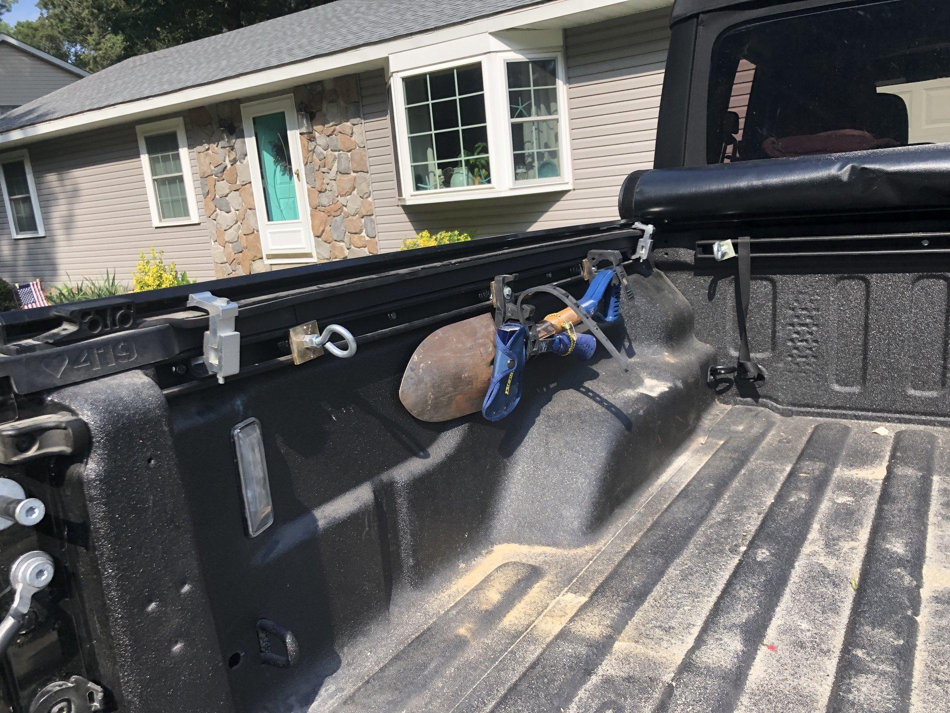

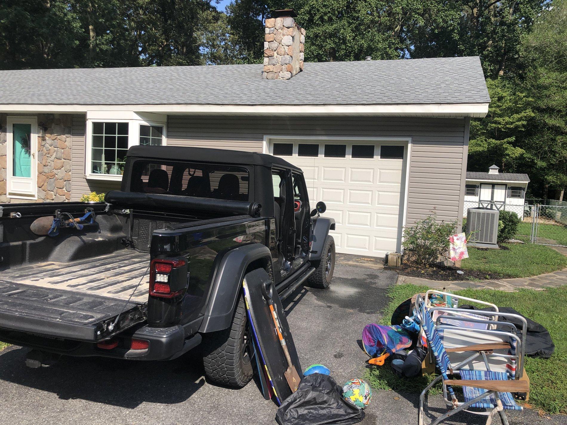

Stalled on mods. In a holding pattern on a Centerforce clutch. Forward facing camera sitting there silently mocking me and waiting in Rockhard control arm skids. Is removing beach stuff and sand considered a mid...lol.

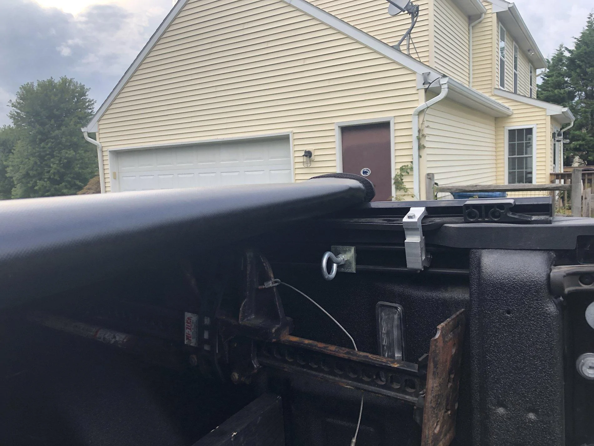

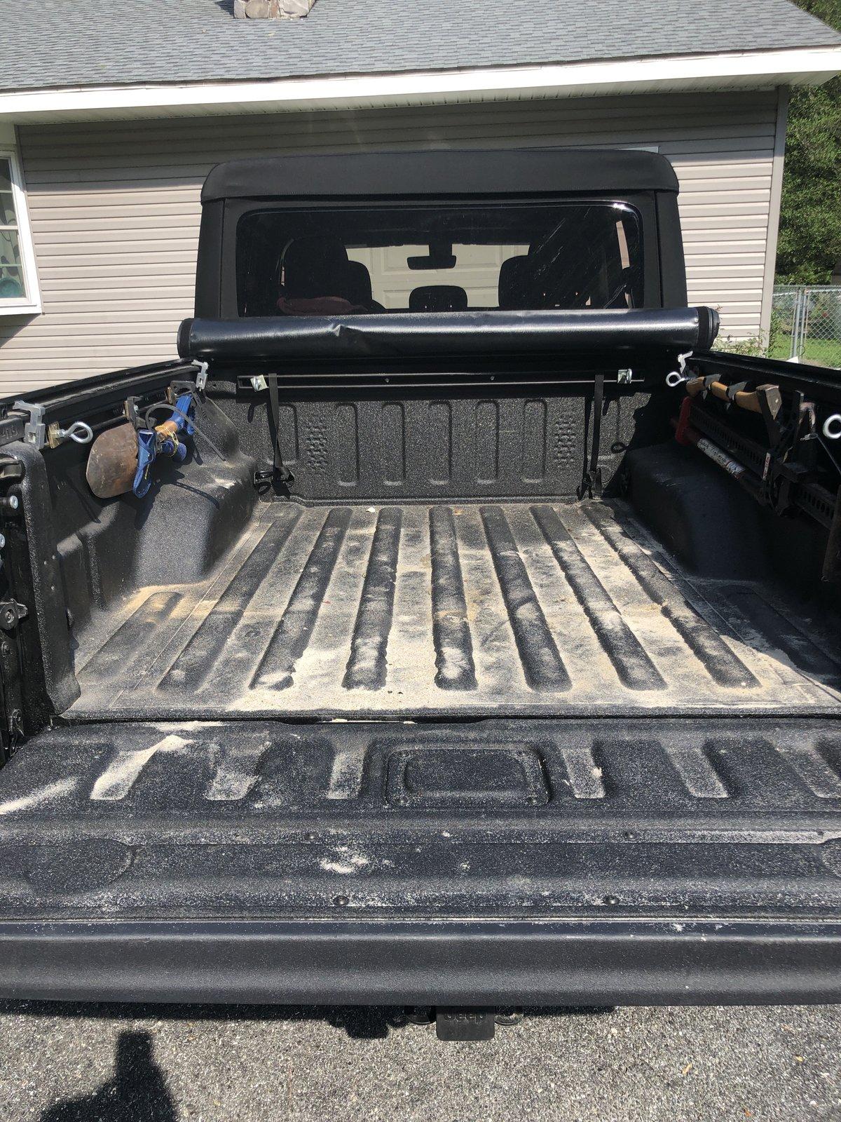

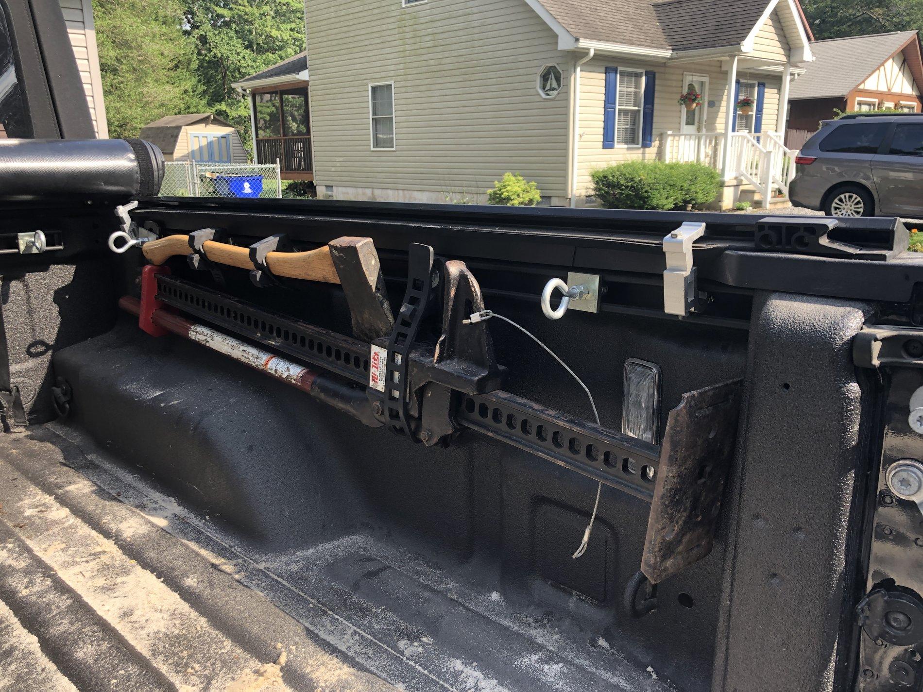

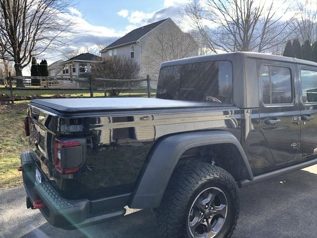

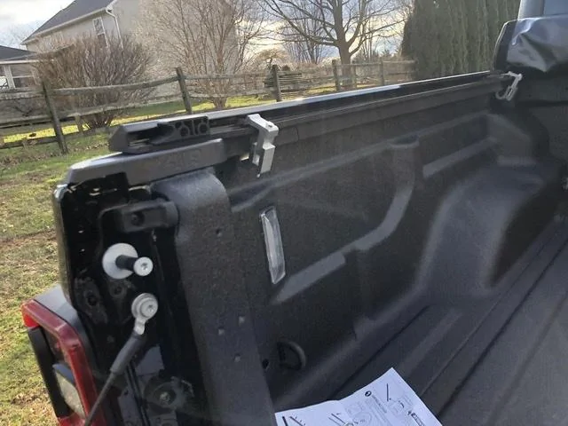

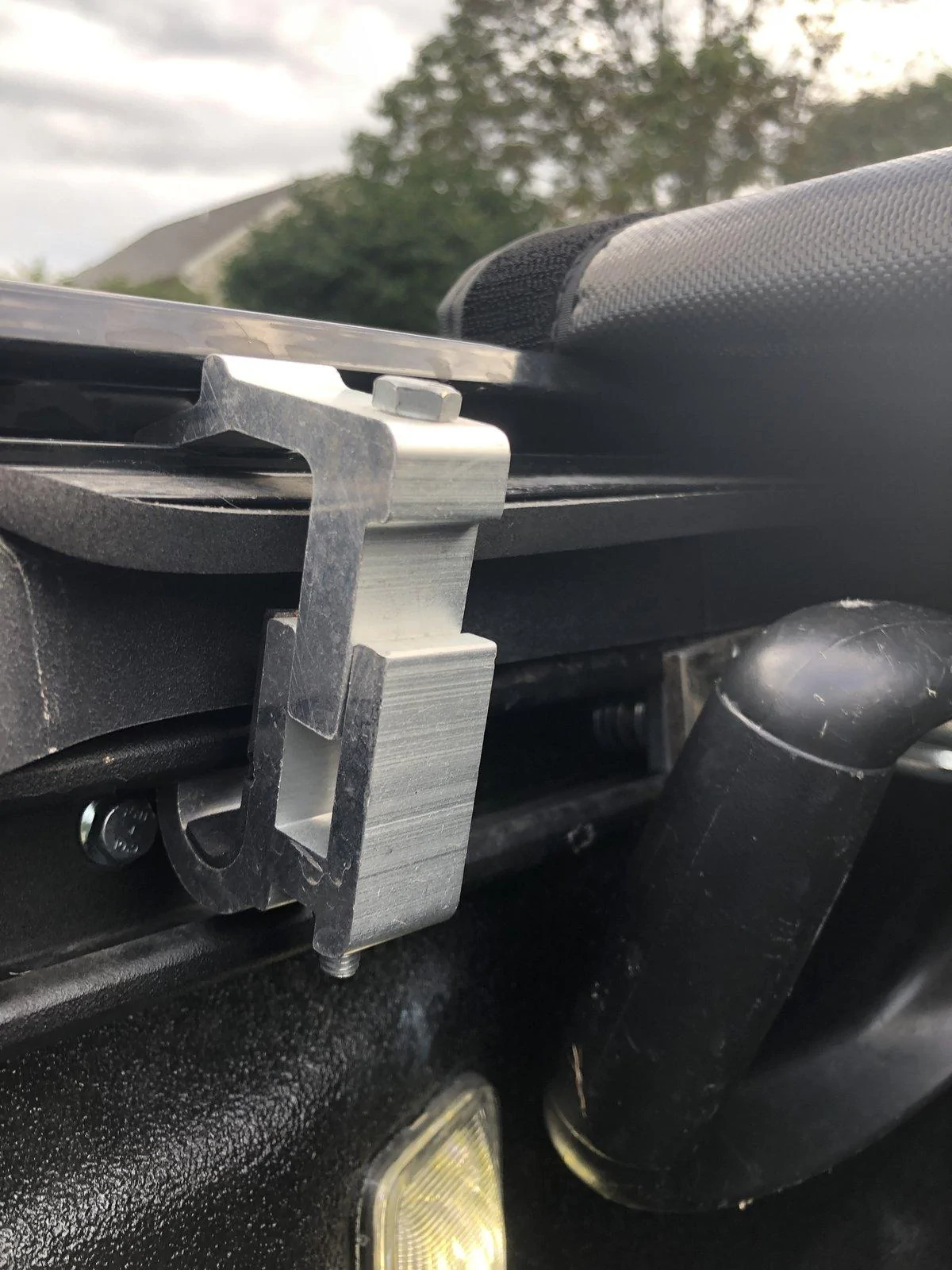

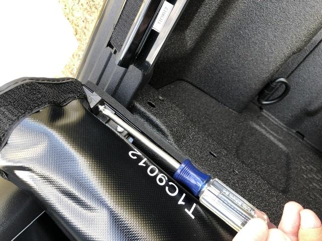

Installed the
MAXMATE Soft Roll Up Truck Bed Tonneau Cover for 2015-2018 Chevy Colorado/GMC Canyon | Fleetside 5'2" Bed
https://www.amazon.com/gp/product/B01M1K4T40/ref=ppx_yo_dt_b_asin_title_o00_s00?ie=UTF8&psc=1
Pretty easy/straight forward install. Some pics
Had to cut the clamps to work with the Built Right Trail Raul system. Pretty easy. Just “eyeballed it” by holding it up and used a grinder cutting wheel.
Jeep Gladiator JTR Spartacus Build Journal 45DD3095-DF47-4B80-AB8B-EC634C2FEE81
Jeep Gladiator JTR Spartacus Build Journal E20824DE-79D7-40B0-B695-83E3D8D41D71

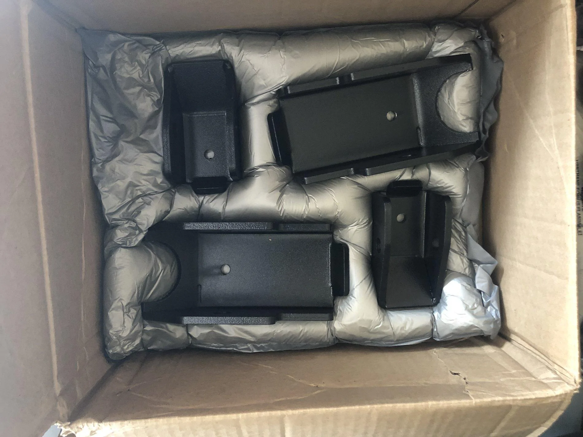

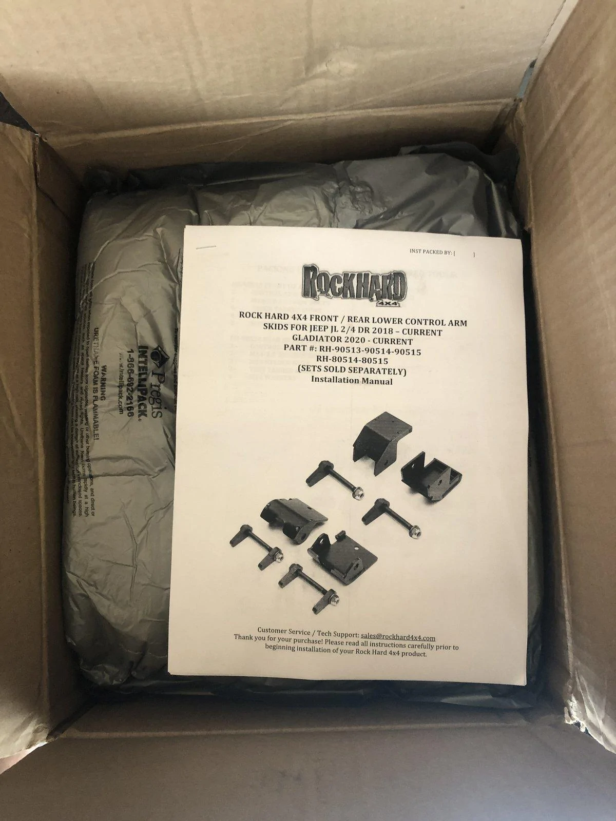

Rock Hard control arm skids came in. Gonna put some rust reformer/paint on some of the gouges on the stock frame side rear control arm mounts and then put these skids on the beef up that potential problem area.

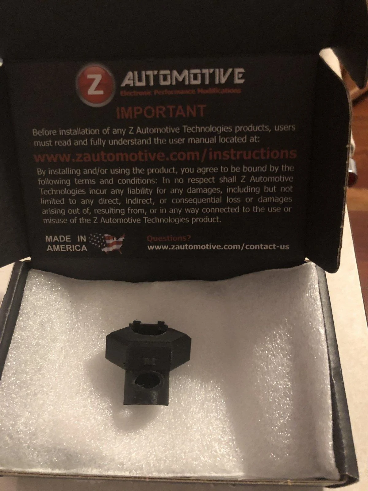

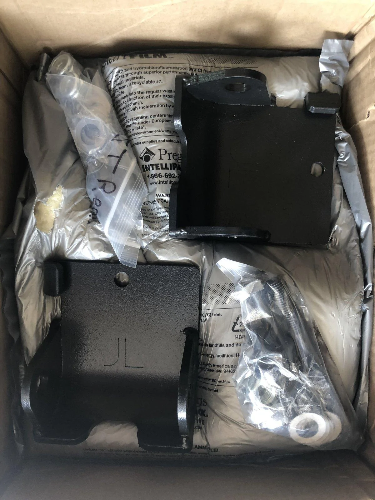

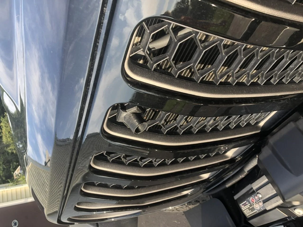

Zautomotive sent me a Gladiator specific front camera bracket. No instructions in the box or on the web site. Sent an email. I might just guess.

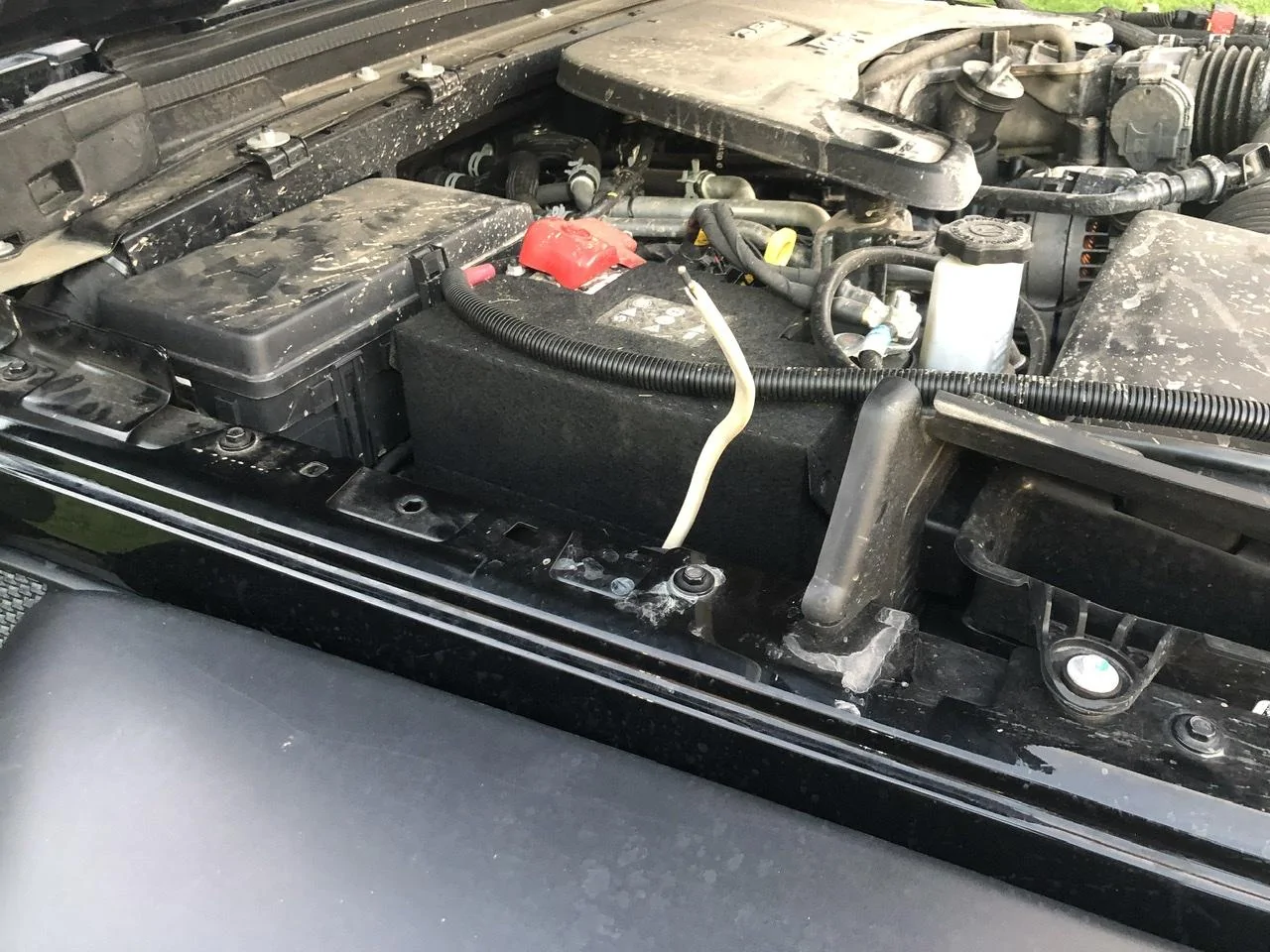

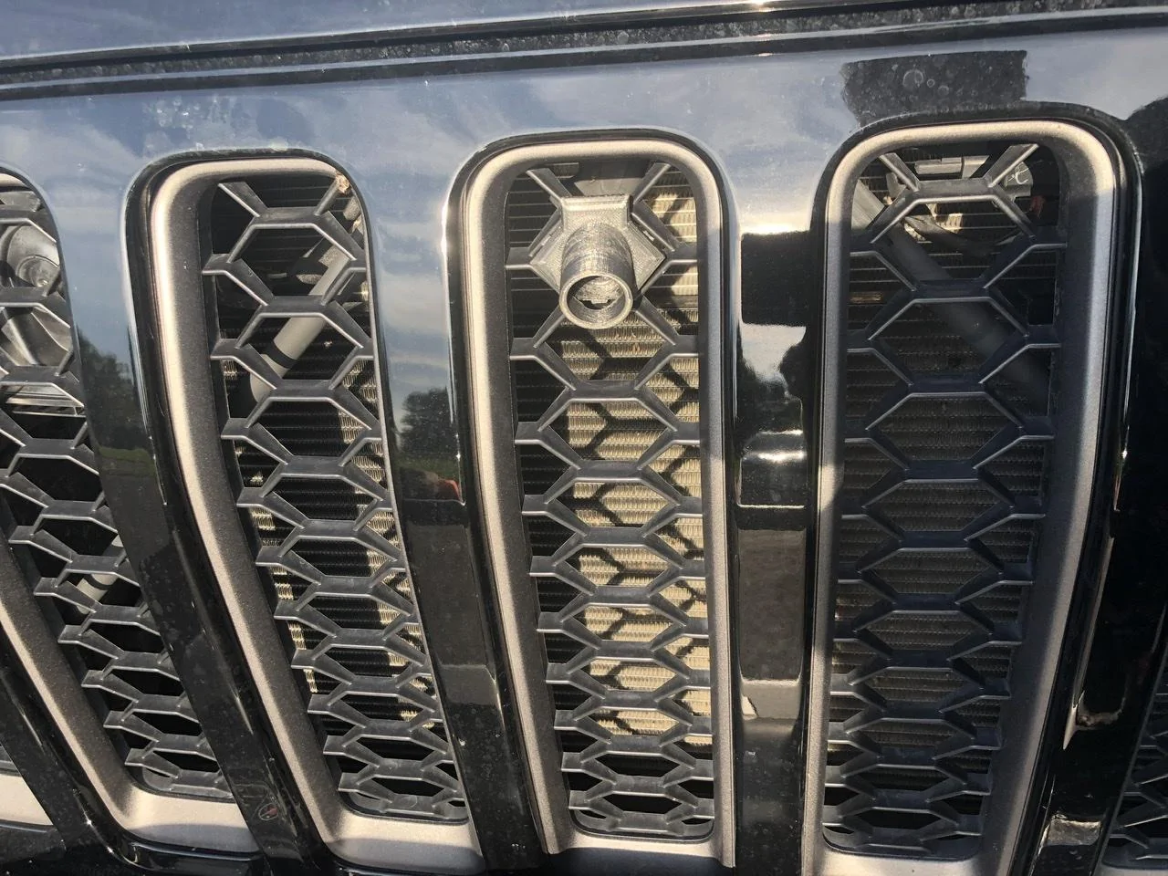

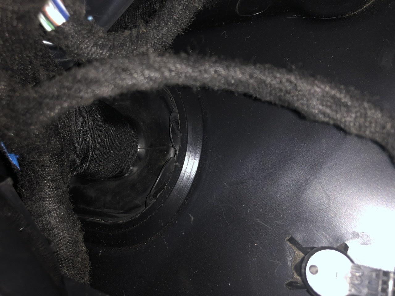

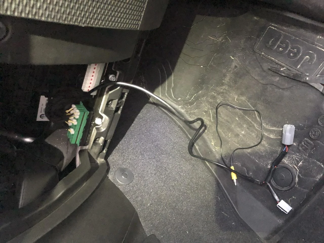

Got started in the Zautomotive front camera tonight after work. Ran out of daylight. Test fit the bracket - no need to cut or mod grill with this bracket. Wiring started. Going through the passenger side wiring grommet under the glovebox. After some trial and error I settled on starting from inside, cutting the grommet from inside and outside with a utility knife then used a piece of Romex with the camera wiring harness electrical taped to it to get the wires through. Ran out of daylight. Stay tuned. I’ll post a video when done.
Looking forward to this :)
I used the tool to run wires through the grommet, works like a charm. Guess I will have to break it out again. Keep the updates flowing!

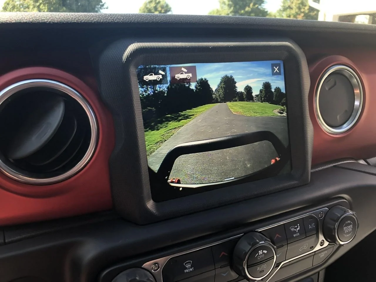

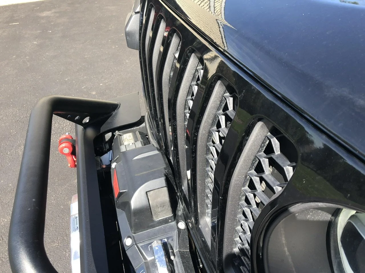

All done. YT video coming soon.
