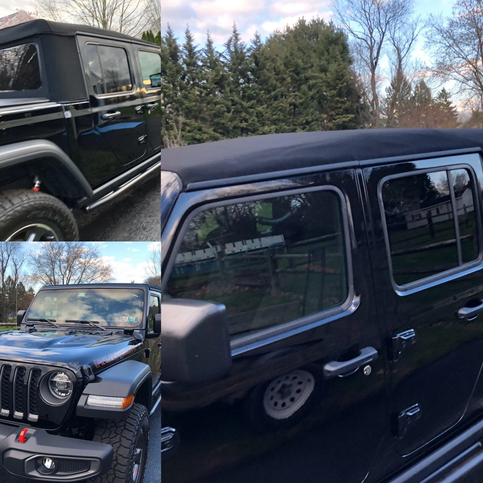

Soft top installed. A bit of a PIA. YouTube soft top install video coming soon.

Do you know how much taller the soft top is over the hard top?

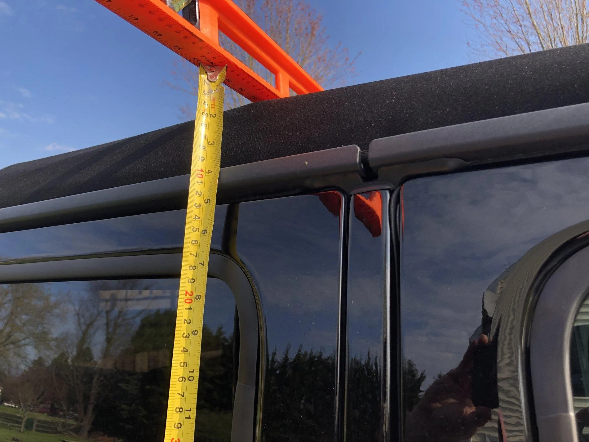

I didn’t measure with the hard top on. However. Here is a pic of what looks to be the hugest point at the back, passenger side door. It’s about 5 inches from the tallest point of the top to the top of the rear door. Hope that helps.
Perfect! Thanks man, that helps a lot! Working with a small garage height.

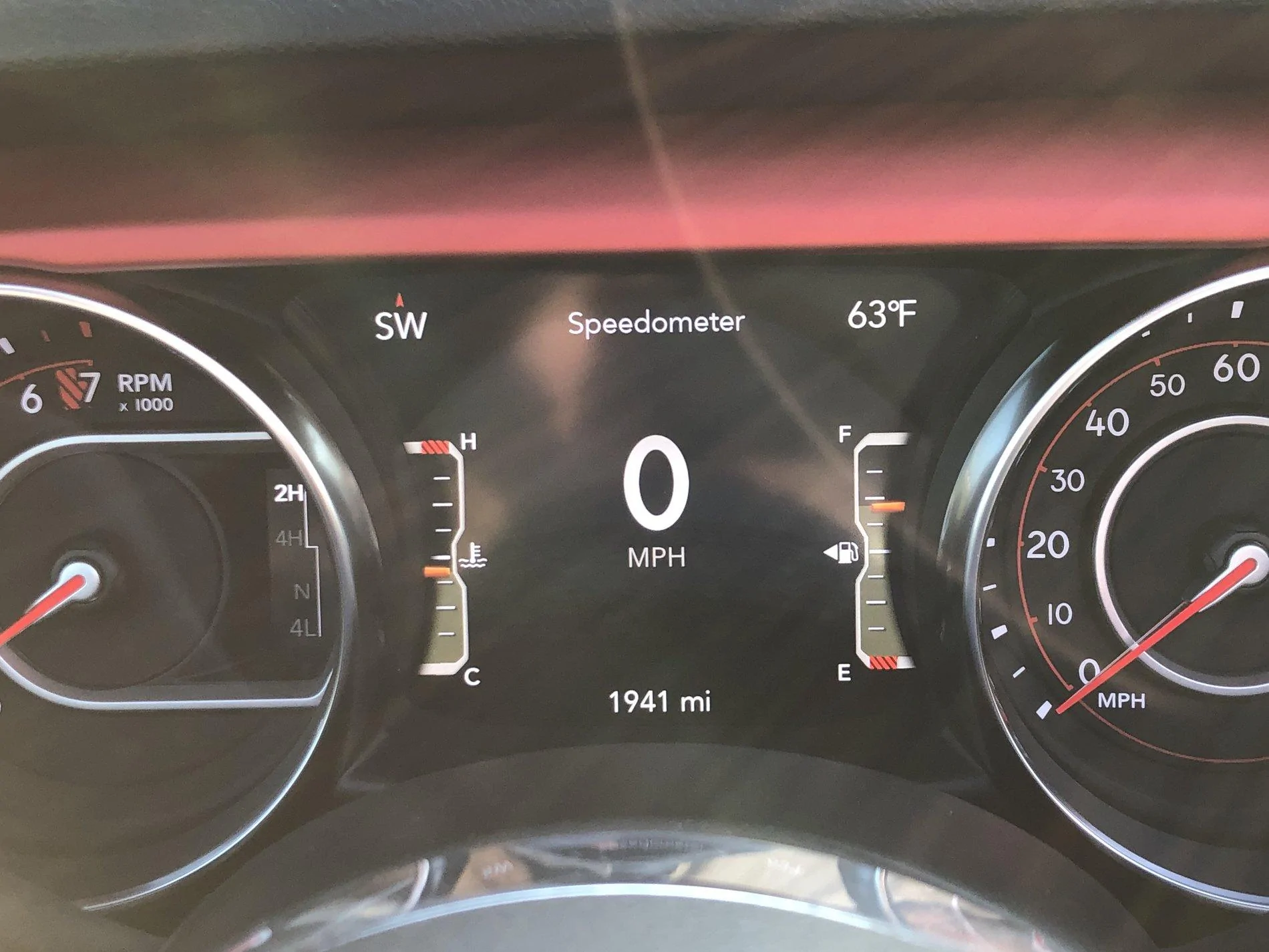

Hit the milestone today.

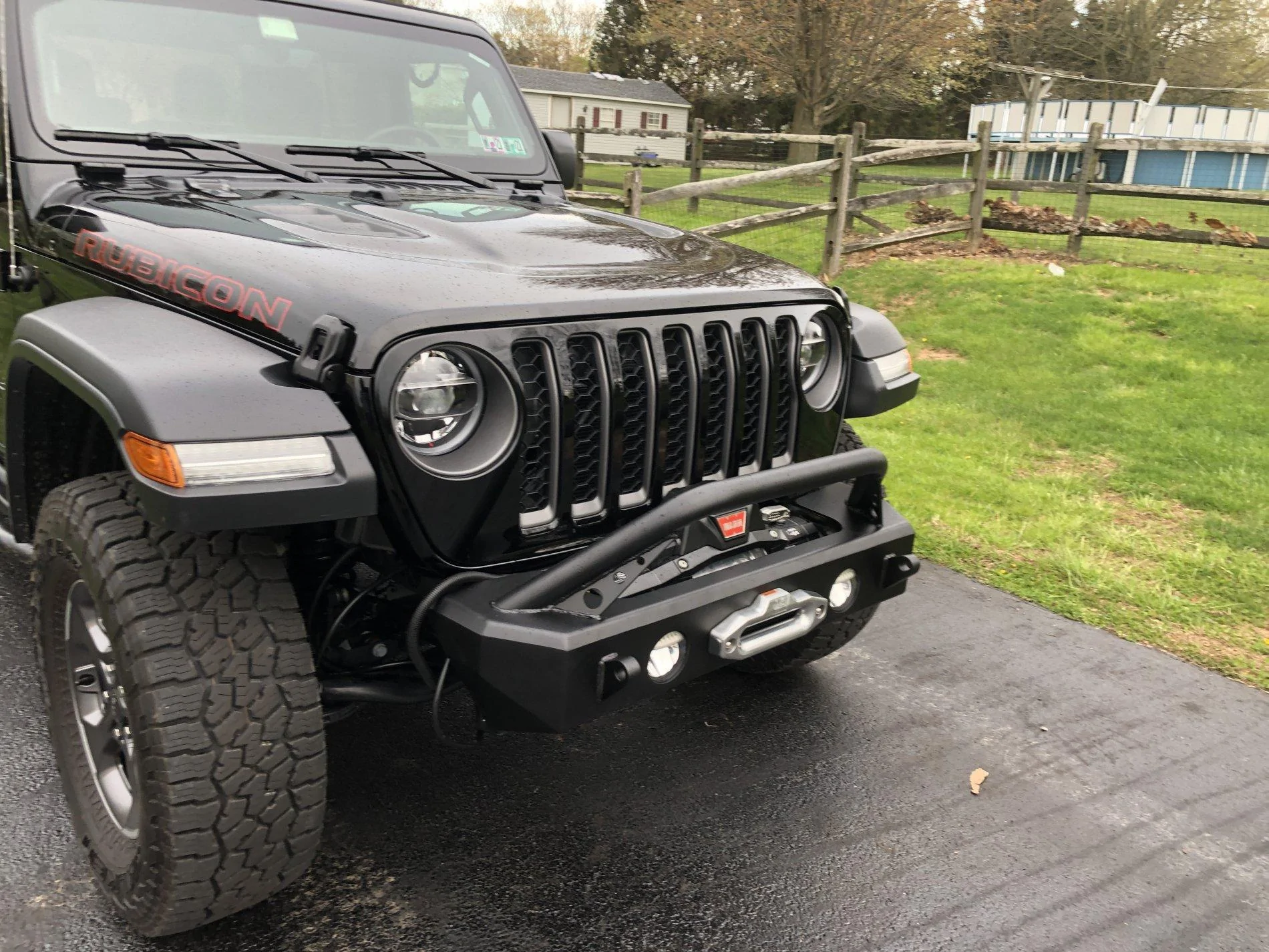

My @ACE Engineering bumper came in today. A little over 11 weeks. Well packed and Looks great - can’t wait to get it installed !!

The new bumper looks great! Cannot wait to see the install.

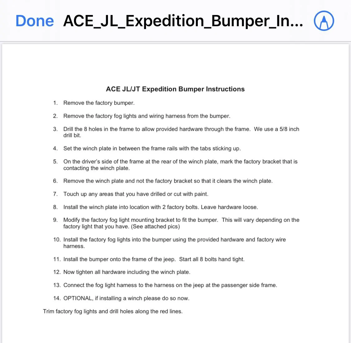

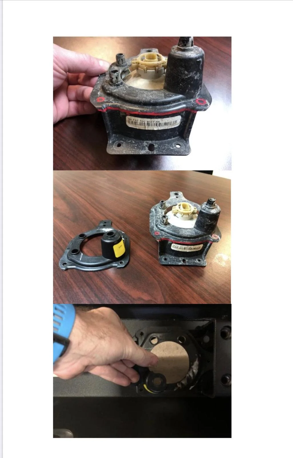

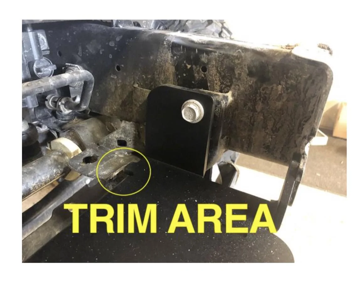

Posting up Ace JT Expedition Bumper Instructions. Looks like a bit of trimming. I’ll be working on this soon.

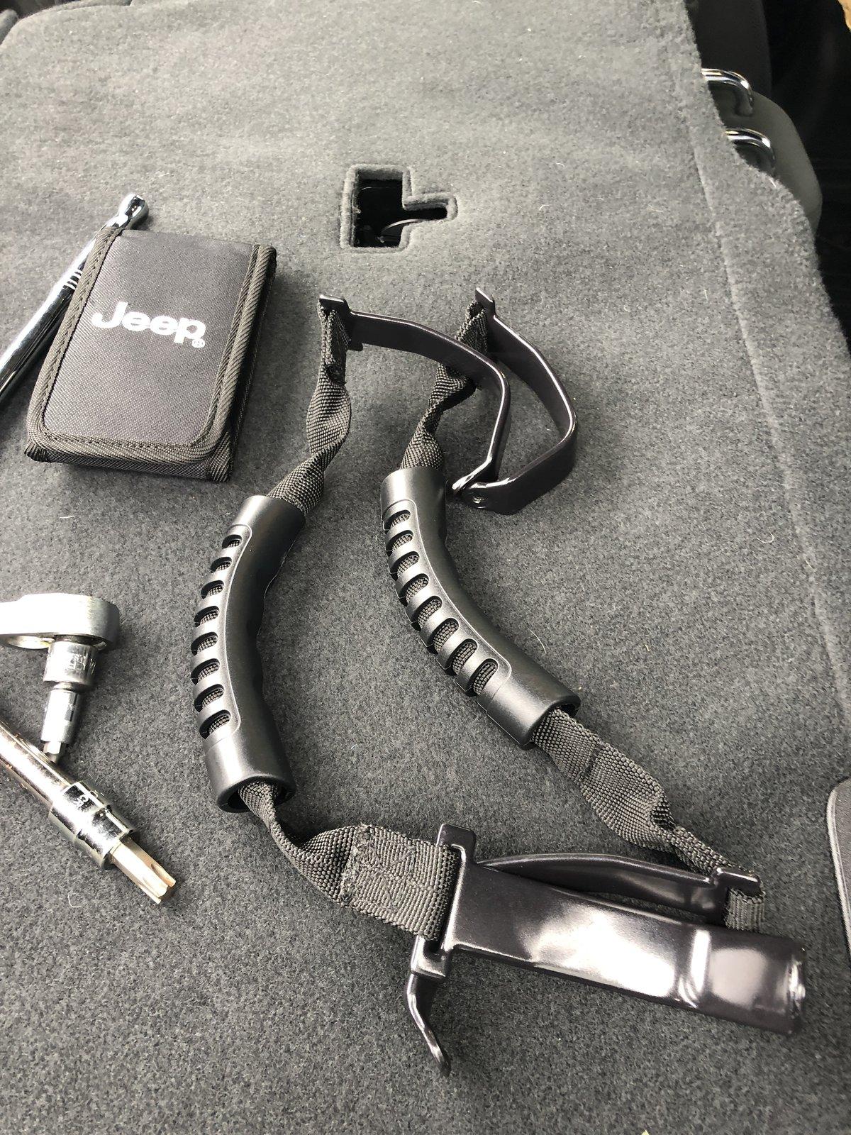

Mopar Soft Top Installed Video. Anyone have issues with @Quadratec grab handles not clearing the soft top? Check it out!

Anyone VCS with ideas Or tips for using Quadratec grab handles with soft top?

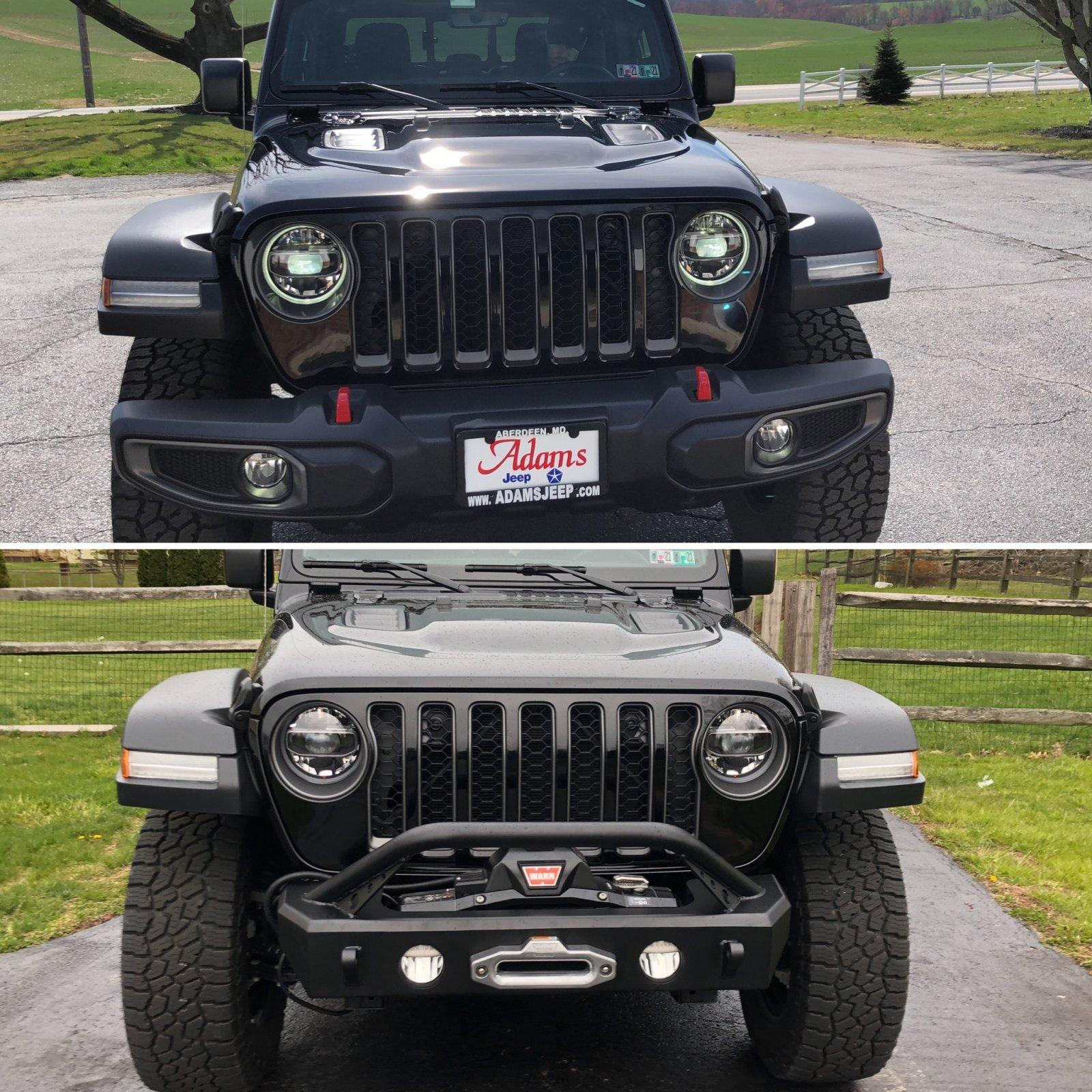

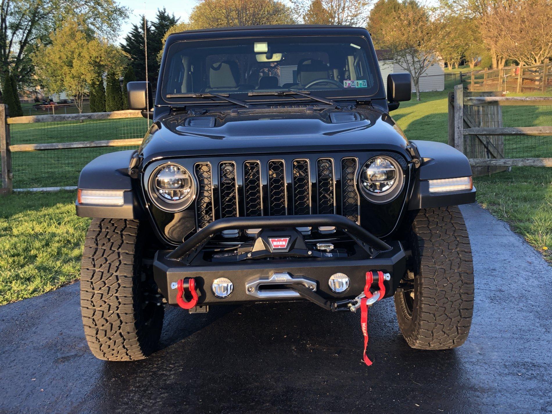

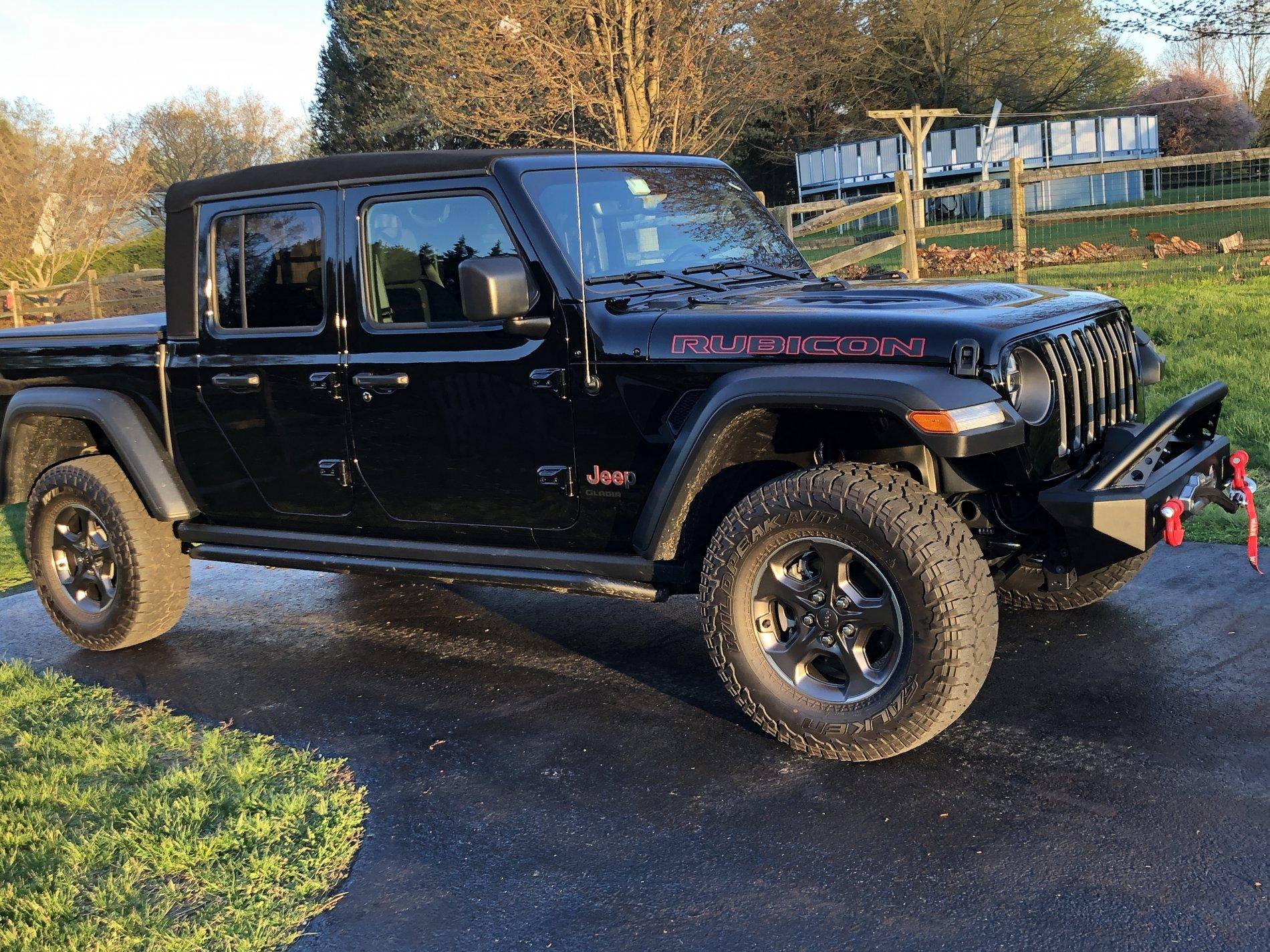

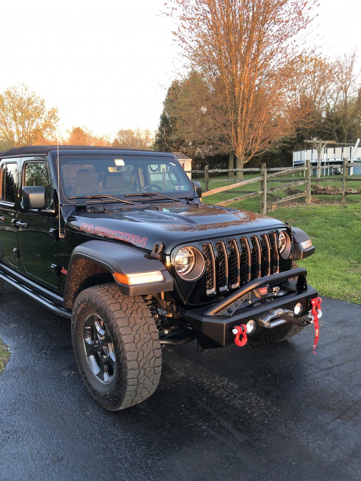

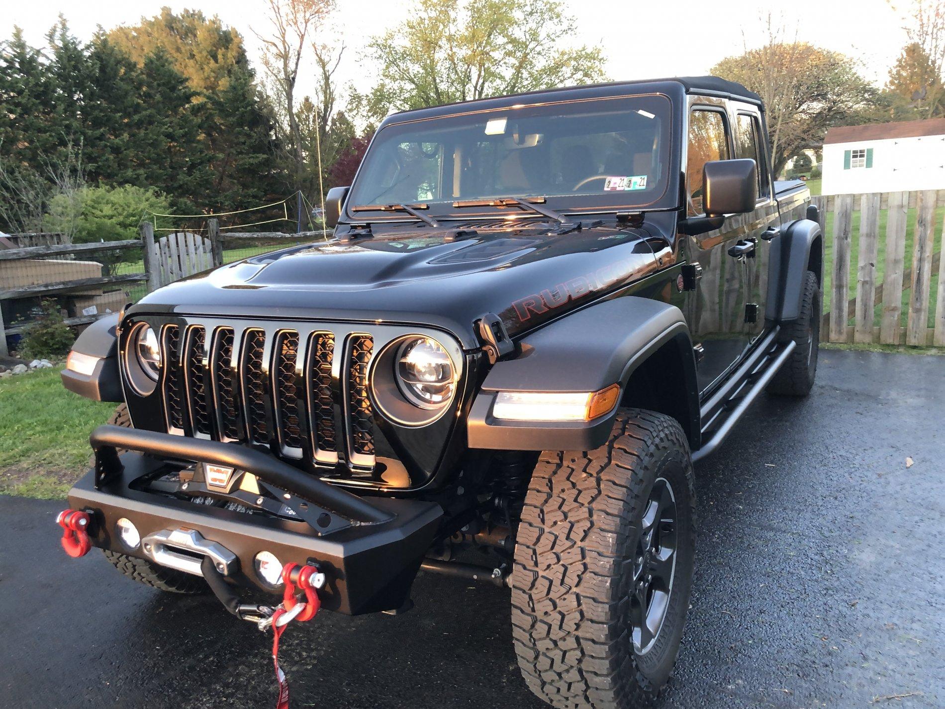

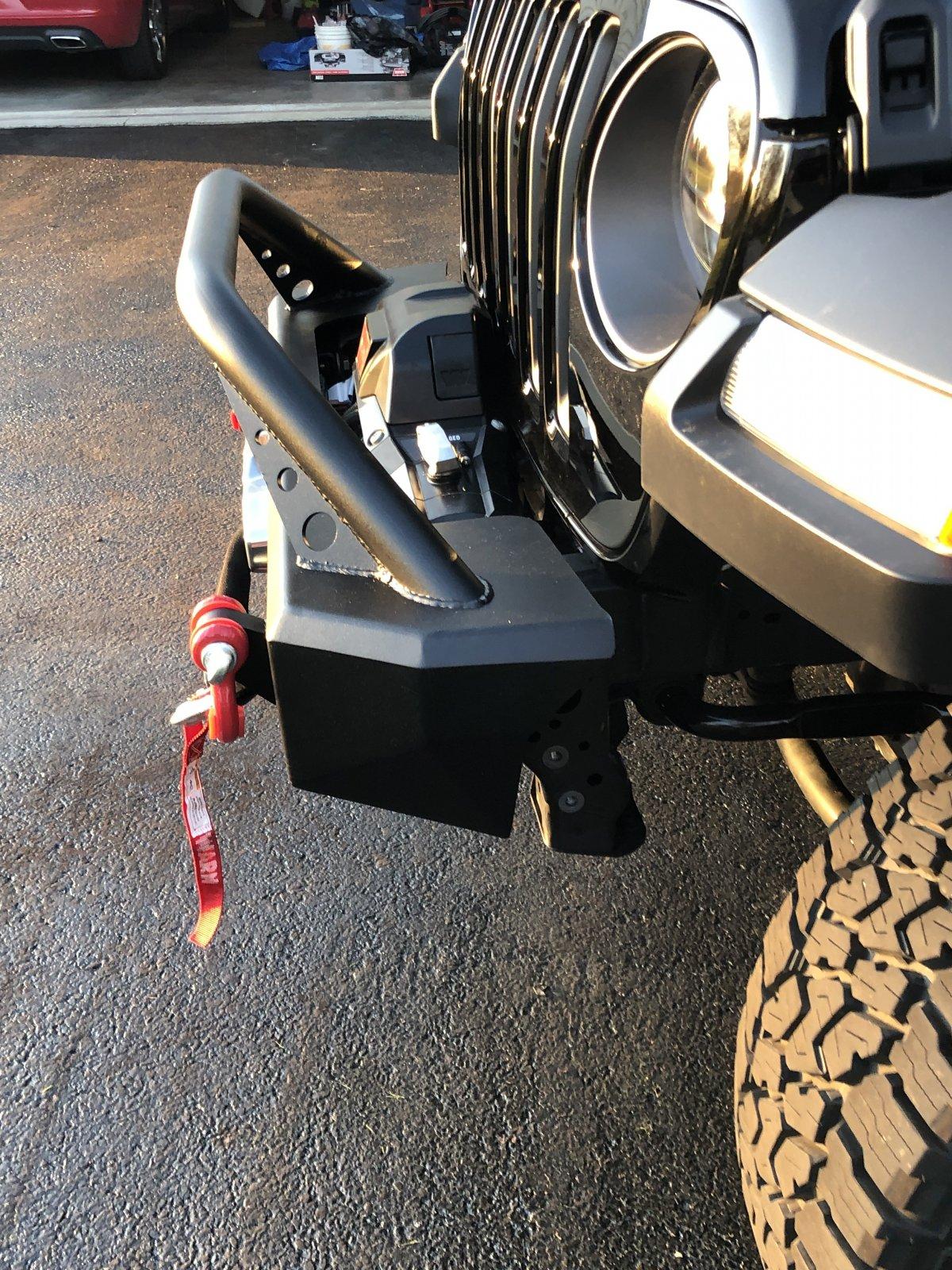

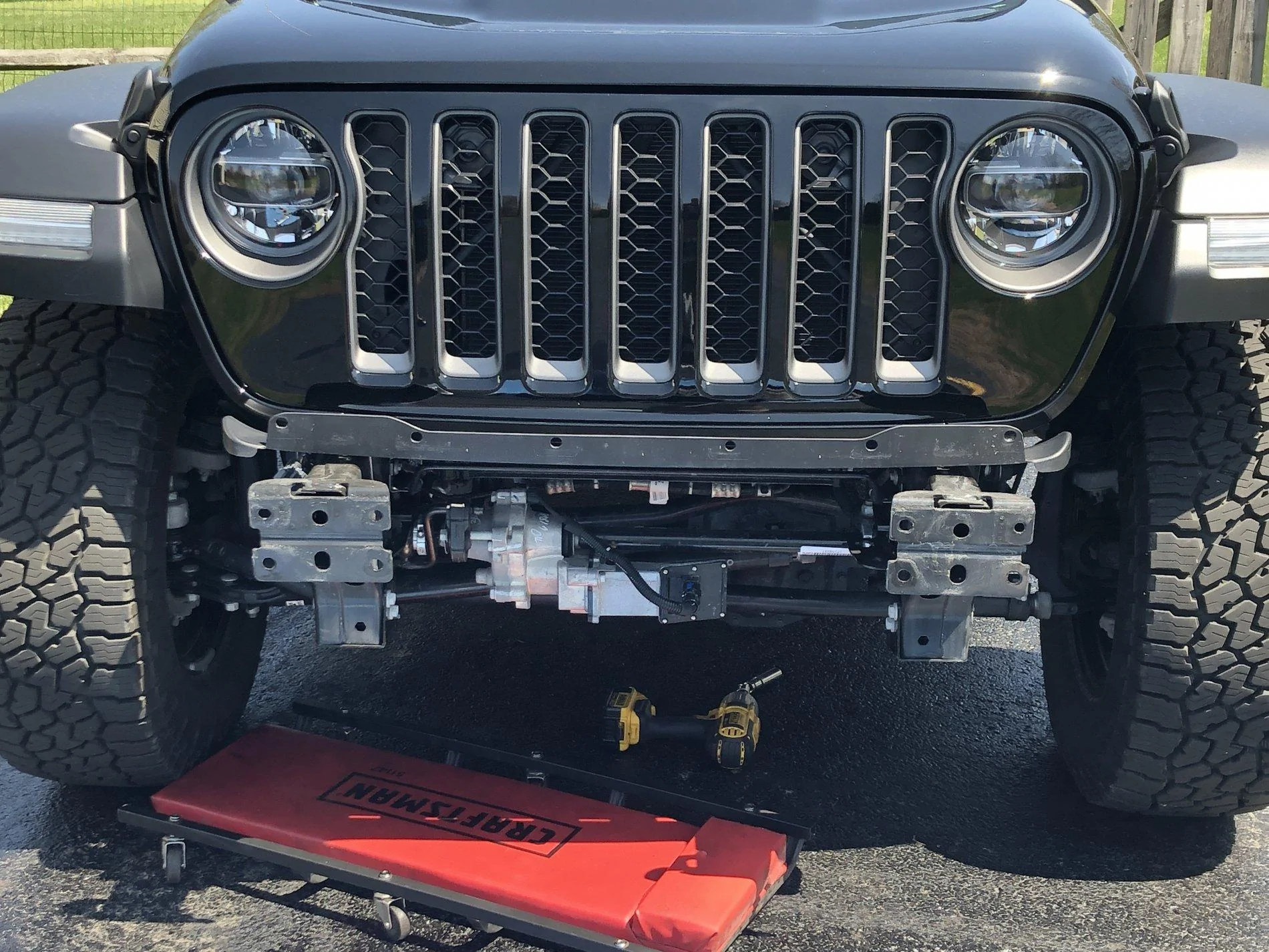

Ace JT expedition bumper installed. Starting raining so wiring and spooling the winch line will have to wait. Install and review video coming this week.

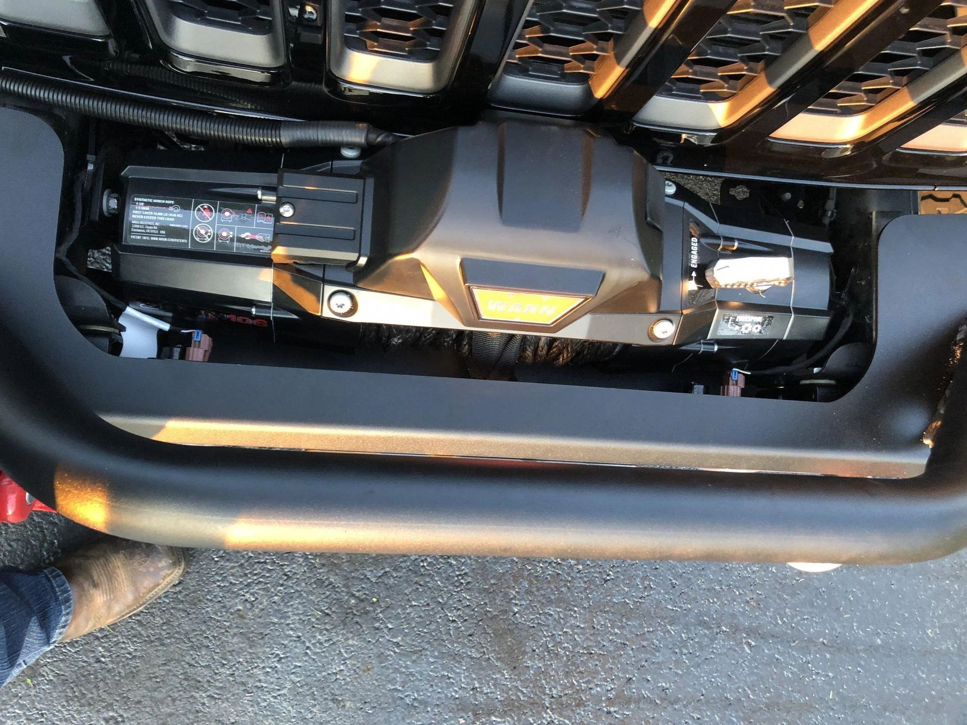

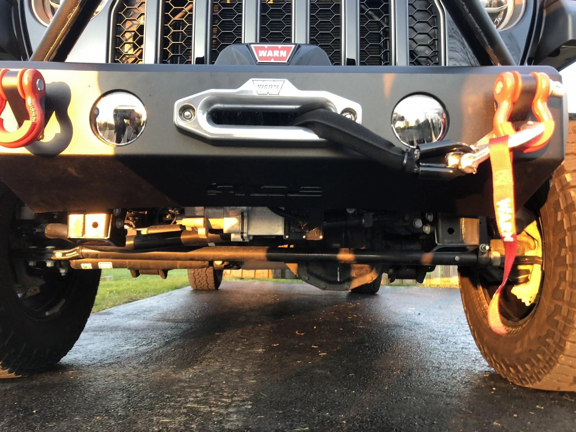

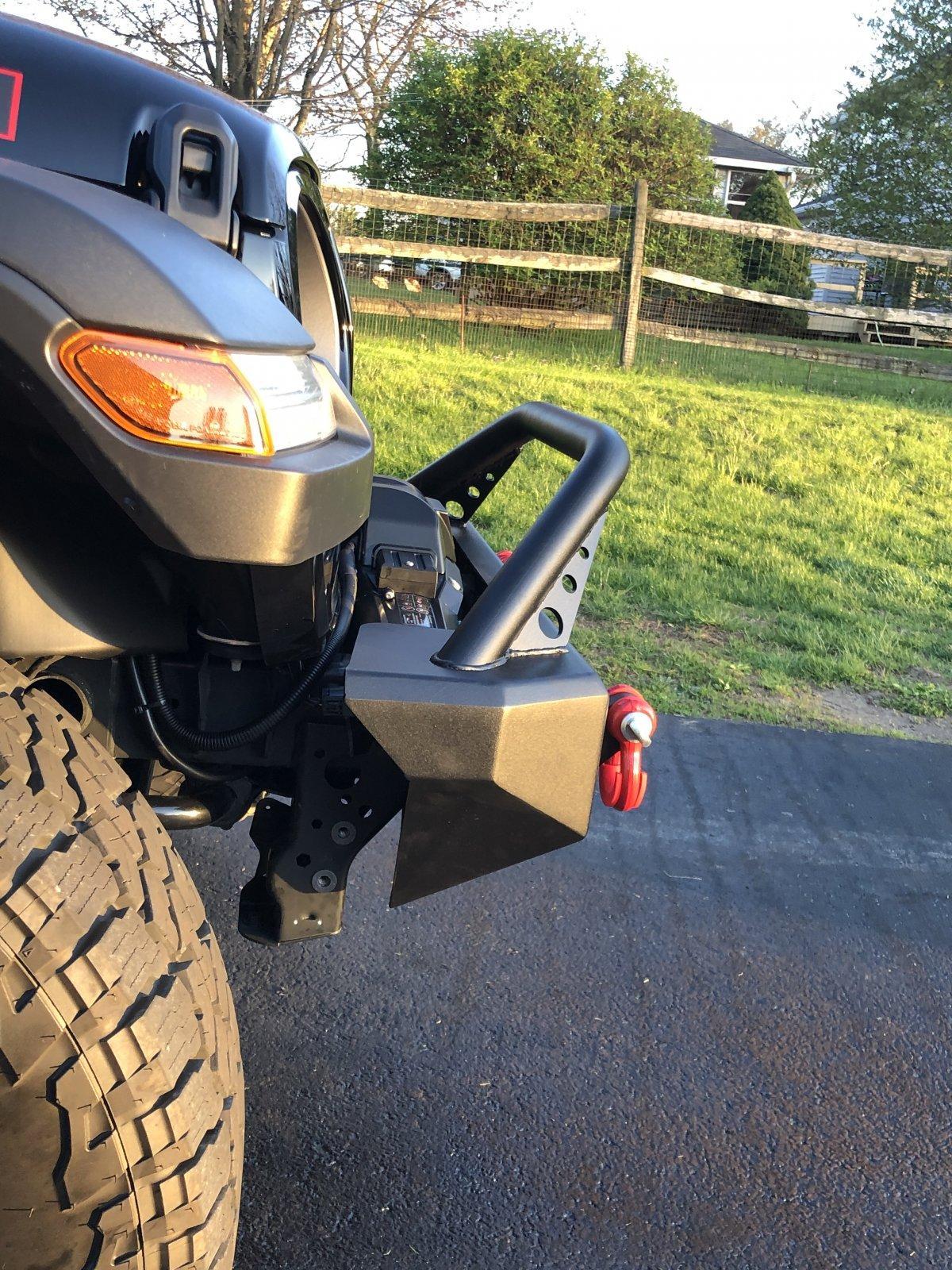

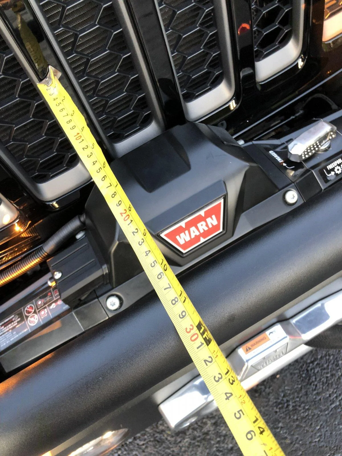

Bumper all done. Think it came out well. The Zeon 10s is a very tight fit. It’s about 1 foot from the grill to the edge of the bull bar. The bumper is about a inch and a quarter shorter so around 10 3/4”. Install video coming soon.
bobjohnson26
Bob
Oct 8, 2019
PA
2020 Sting Grey JT
The bumper and the winch look great - thanks for the detailed measurements. I am looking forward to the install video as I hope to do this in the future.
Thanks! I’ll get the video together soon. This is a fairly involved process involving some light grinding for clearance and drilling 8 - 5/8” holes to enlarge the factory holes in the frame . I’ll try to share the things I learned and hopefully make it a bit easier for folks. Also ended up with washers between the bumper and frame to get just a bit more clearance for the factory fogs.
First thing I’d recommend, knowing what I know now is to just buy LED fog lights and a wiring harness. The stock bumper is a PIA - not really hard just a lot to take apart just to get the factory lights and harness out. Really just a waste of time and effort. Seems like a stock bumper without lights or harness will be tougher to sell on Craigslist/FB marketplace, so it will probably end up getting thrown away. Thinner fog lights would work better for more clearance anyway.
Next will be the factory skid mod to fit with this.
